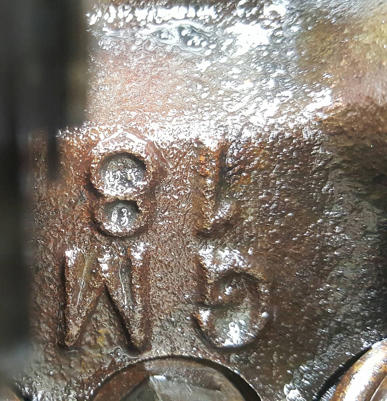

    Not sure about this ?

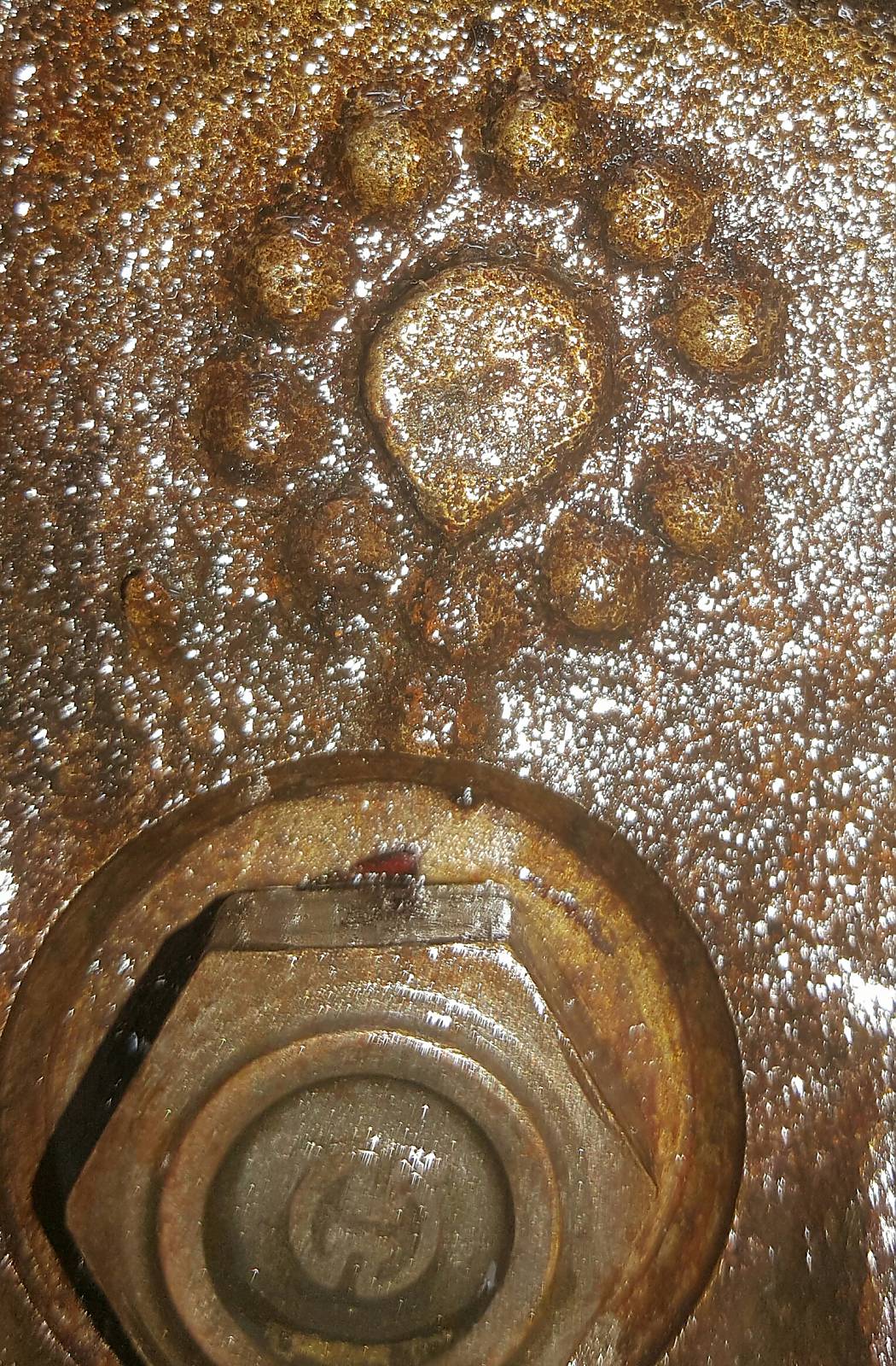

    Lastly

    The daisy wheel looking thing is when the head was cast (about 6:00). The key to these numbers is really the last few digits and the 441 casting is a pretty standard early smog head (1970 is my guess, but the date code isn't visible in the casting number photo). It has 74 cc chambers, 160 cc runners and 1.94"/1.50" valves. This head can "wake up" with some machine work, removing the "smog humps", a light decking and relieving the valve bosses a little. Simply put, they'll do fine on your engine, as they have a thick deck. They were put on a 1969 or '70 Chevy 350 originally. The chamber size suggest a low compression application (9.5:1 probably).

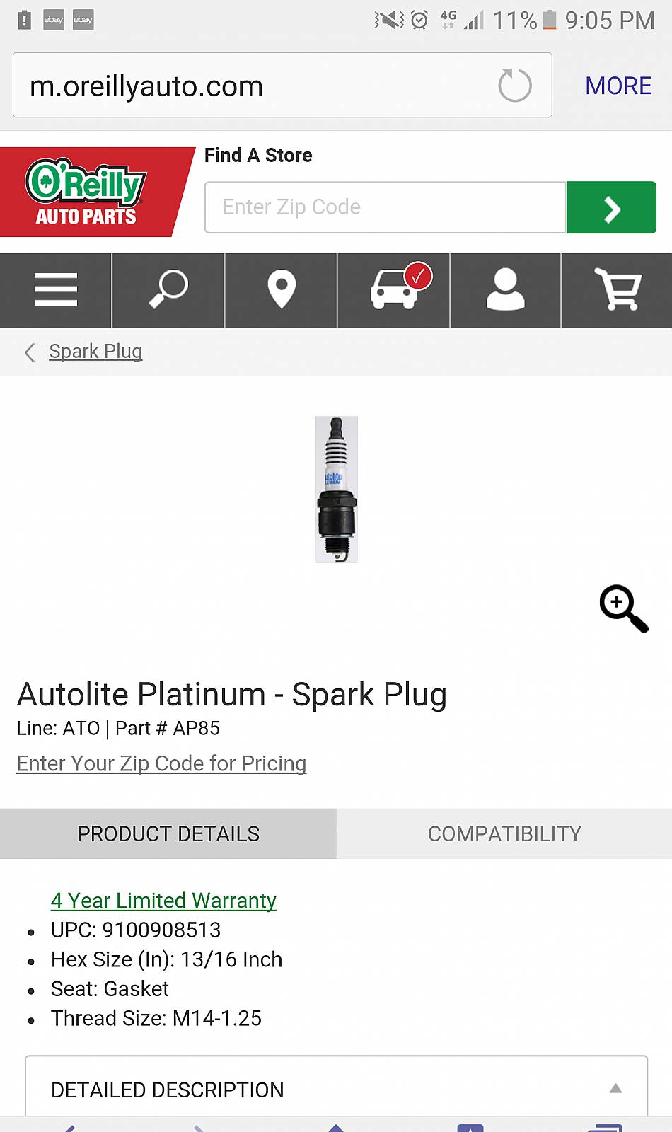

  6. mikealston2428
    Joined: Jul 2011
    Posts: 207
    Likes: 2, Points: 18, Legacy Rep: 10
    Location: aussie
    mikealston2428 Senior Member
    Hi Par
    These are the current plugs
    Would you be able to tell me the E3 equivalent?
    I see the E3.42 have a 44 reach
    I'm not sure what the AP85 is ?
    Im unsure if the current plugs are even correct for my engine ?
    They have seat gasket and 13/16 socket
    Should I be using tapered seat ?
    Thanks
    Mike
  7. PAR
    Joined: Nov 2003
    Posts: 19,126
    Location: Eustis, FL
    PAR Yacht Designer/Builder
    The replacement for the AP-85 is the E3.52. This is a 13/16 socket, 14mm thread, 3/8" reach, with a gasketed seat. The question is, was the right plug installed in this engine, as both the E3.42 and E3.52 have the same thread, though the 52 has slightly more reach. The quick check is to look at the seat in the head. If it's tapered, the Autolite plug is incorrect, if it's a flat landing area, you'll need a gasketed plug, like the E3.52.
