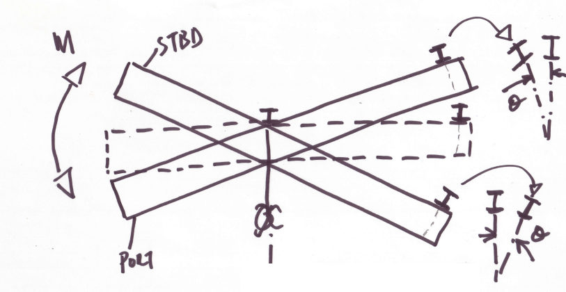

  8. Ad Hoc
    Joined: Oct 2008
    Posts: 8,118
    Likes: 2,019, Points: 113, Legacy Rep: 2488
    Location: Japan
    Ad Hoc Naval Architect
    The hull is out-of-plane from the transverse moment. The hulls are infinitely stiffer than the traverse members... unless it is made of Switz cheese rubber, or a very long thin slender member itself.
    As noted above, one always assumes the hull is infinitely stiffer than the transverse members. ...however.
    Place an I-beam at the centre/midships and another at the ends of the hull, as shown.
    The I-beam on the port hull rotates in an equal and opposite angle to the one on the stbd hull. The angle of twist is created because the I-beam has displaced vertically relative to its original position. Now either the I-beam remains plane as it it is displaced vertically, i.e no twist, and the hull simply moves under it....or it remain plane with the deck it is attached too...in which case it is forced to twist, as shown.
    At the centre of rotation, there is no vertical displacement, the I-beam attached to the deck does not displace, it remains in the same position as its original position, prior to the applied load on the hulls, therefore there is no angle of twist experienced by the I-beam.
    If, instead of an I-beam... you had an RHS, of same scantlings at the end... the torsional resistance of the RHS to the applied angle of twist is roughly 400 times greater than the I-beam....
    Open cell structures are very weak at resisting torsion.
    Nope...only a misconception that they do not need to be! They must be closed cell structures, NOT open cells structures.
    What you cite as "distortion"... is an angle of twist...i.e torsion....like this image...as also noted above.
    It is because the deflection at the centreline is zero.

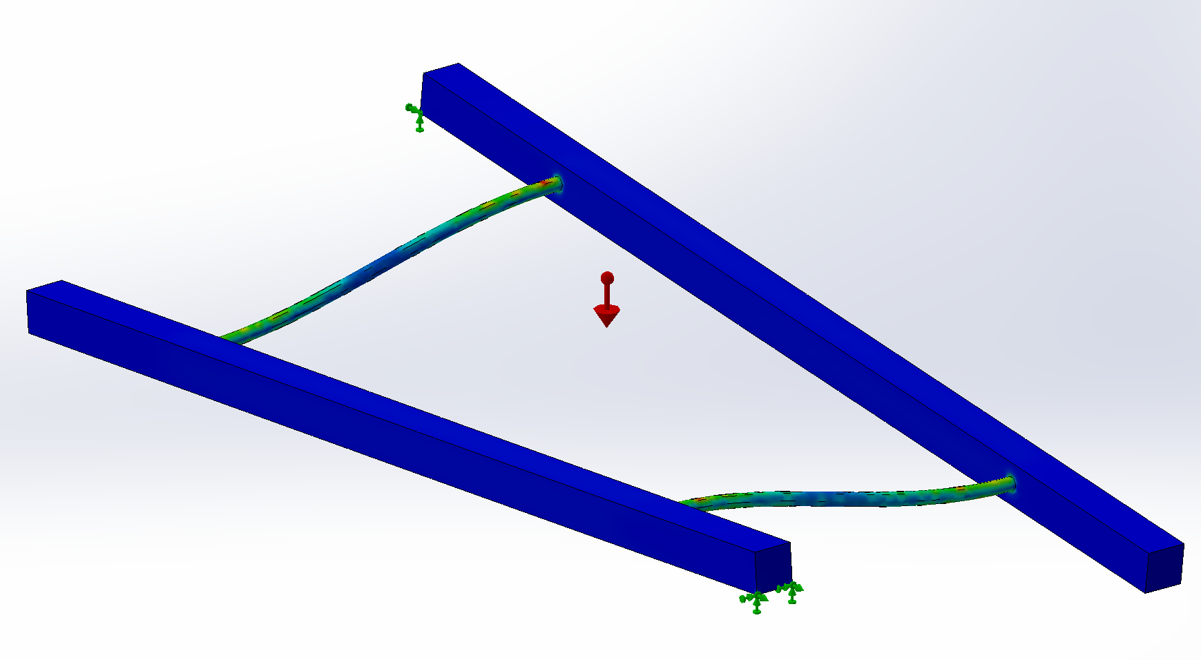

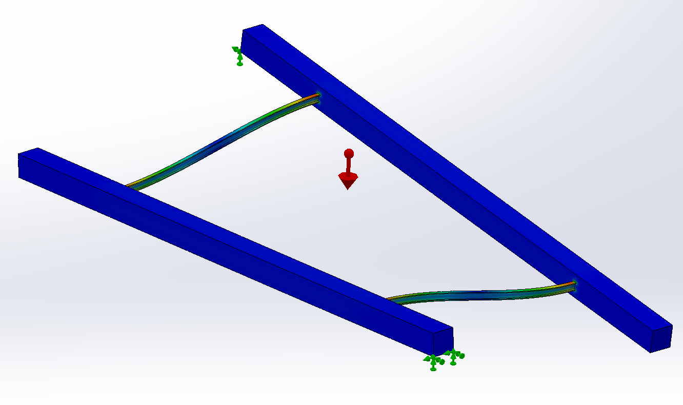

  10. John Perry
    Joined: Nov 2003
    Posts: 308
    Likes: 53, Points: 28, Legacy Rep: 129
    Location: South West UK
    John Perry Senior Member
    There are a few points in AdHoc's recent posts that I could comment on but I think the main thing he is saying is that cross beams for multihulls must be 'closed cell' structures (e.g. tubes) and that 'open cell' structures (e.g. I beams) are unsuitable for this purpose.
    I think that the word 'must' is far too strong here. I would say that cross beams for multihulls can perfectly well be either closed cell or open cell structures but for structural efficiency (i.e. minimum weight of material) in this application the bending properties are more important than the torsional properties - to put it in rather loose terms - a bit of bending stiffness is worth a rather larger measure of torsional stiffness.
    Just to try to make this clear I have run a comparative pair of simple FEA studies. I would not usually go to so much trouble in answering a post on a boating forum but I think this could be of interest to quite a few people and perhaps it might also be the basis for a short article for the AYRS magazine.
    So, I have considered two structures that represent, in very simplified form, the structures of two catamarans. The only difference between the two structures is that one has round tube cross beams and the other has I beam cross beams. And the tubular and I beam cross beams are alike in all but the form of the cross sections - they are the same cross sectional areas, and hence weight, the same material and the same height as viewed from the end of the craft, so given that they are both bluff bodies they won't be a lot different aerodynamically. Having said that, for a performance sailing craft, both types of cross beam could perhaps do with some non-structural fairings being added.
    The dimensions for both catamarans are:
    Hull length 8000mm, cross beam fore and aft spacing 5000mm (centre line to centre line), hull depth 300mm, hull beam 300mm, length of cross beams (i.e. gap between hulls) 3000mm. The hulls are solid cuboids and as such have much greater torsional and bending stiffness than either type of cross beam. The material for the whole structure of both craft was chosen to be aluminium 6061 T6, but this is arbritrary, any solid material could have been selected for comparative purposes. The loading used is self weight and because the solid metal hulls are so heavy (this craft would never float!) I reduced the value of the acceleration of gravity from 9.81 to 1.0 m/s2 for both cases. This was simply to keep the stress levels within the strength of the material, so as to avoid the software stopping with an unwanted warning message. For both cases the craft was supported on points at the bow of one hull and the stern of the opposite hull, to simulate loading from a quartering sea, albeit in a rather exagerated manner.
    The tube cross beams are 100mm OD, 90mm ID. The I beam cross beams are 100mm overal height, 50mm width, 11mm flange thickness, 5mm web thickness. The dimensions of this I beam were not particularly optimised for the application, they were just chosen to make the cross sectional areas, and hence weight, the same as the tube within close limits, actually the I beam is marginally lighter than the tube.
    The attached pictures from the FEA analysis show the deflections with the colors indicative of the Von Mises stresses. Note that both beams bend into S shapes, just as with the FEA analysis that AdHoc shows us.
    These are the numerical results:
    Tube cross beam:
    Cross sectional area of beam 1492.26 mm2
    Moment of area of beam - Ixx - 1.688e6 mm4
    Maximum deflection of whole structure 39.5mm
    Maximum Von Mises stress in whole structure 62.4 MPa
    I beam cross beam:
    Cross sectional area of beam 1490 mm2
    Moment of area of beam - Ixx 2.387e6 mm4
    Maximum deflection of whole structure 36.6mm
    Maximum Von Mises stress in whole structure 51.4 MPa
    So, as one would expect, the I beam has the greater value for Ixx. Of course, nothing beats a round tube in pure torsional loading so the round tube will be much stiffer and stronger than the I beam in torsion but for this application that advantage does not quite make up for the better bending properties of the I beam, it does end up quite close though.
    Everything else being held the same, the I section cross beam offers slightly less deflection and slightly lower stress levels than the round tube. So there you have it.
    I would add that I am quite capable of making silly mistakes! - while using a software function to check the Ixx value for these cross beams today I realised that when I used the same software function the other day to work out the Ixx for Mark o Hara's real catamaran beams I may well have picked out the wrong numbers from the rather small print displayed on my screen. I think I would have made the same error for both Mike's existing wood beam and the possible alternative composite beam so the conclusion probably remains but the numbers may change. I will check and make a correction if necessary but havent time for that right now.

  12. Ad Hoc
    Joined: Oct 2008
    Posts: 8,118
    Location: Japan
    Correct.
    Numbers and theory do not lie.. it is elementary structural theory.
    In my sketch above, if the I-beam is moved to the centre of rotation as shown - what occurs?... can the I-beam do the job. No. ..why?
    Because this moment no longer has a displacement, ergo it is a pure torque. And by definition a pure toque has no axial or bending. It is governed by a state of pure shear.
    The ideal shape to resist pure shear in torsion is... yup.. a solid shaft.
    So, if you used the I-beam, it would do very little to resist the torque. But if you used a solid shaft...aahh.. that's a different matter.
    Because a shaft remains radial and plane in cross section after the twisting.
    So, now for the beam, or structural member located at the end of the hull... in the case of the sketch it is an I-beam. And as shown, the ends have twisted against each other. There exist an angle, causing the warp, thus:-
    the angle of twist which in terms of a shaft is the angle of strain. Thus there is a simple formulae for the torsion, viz:
    So, we can now investigate the difference in sectional shape resistance to this torsion, by simple theory.
    Given that everything remains constant save for the 'J' the polar moment of inertia. And we can relate this to the shape of the section being used in terms of K.
    Lets take the values of your:
    And I shall add one more to it... changing the I-beam to an RHS... simply by halving the web and pushing to the edges to create the box section. Thus your common themes of area, weight etc remain the same.
    It does create a very weirded shaped RHS, but this is purely an illustrative exercise for now....so the exact shape for production etc, is not so relevant.
    Tube:
    The value for K = 337.6cm^4
    I-beam:
    The value for K = 4.8cm^4
    The RHS:
    The value for K = 89.5cm^4
    The tube is 70 times greater at resisting the same torsion, given all things remaining equal, and the RHS is 19 times greater than the I-beam.
    So there you have it. It is not rocket since... and the I-beam is always , always the worse section to choose, because it is an open section and has very little shear flow area.
    You need to understand what is shear flow and how it is influenced in shapes and it subsequent effects.
