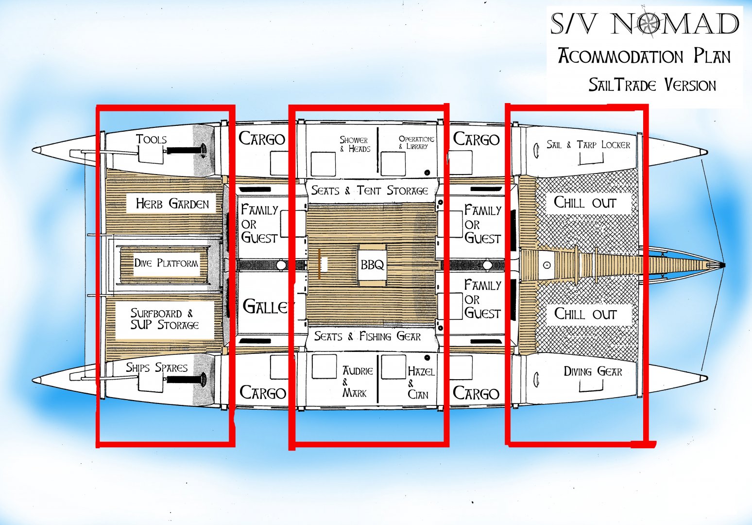

  9. Ad Hoc
    Joined: Oct 2008
    Posts: 8,118
    Likes: 2,019, Points: 113, Legacy Rep: 2488
    Location: Japan
    Ad Hoc Naval Architect
    If beams 1 and 2 and 5 and 6 are those highlighted in blue.. then it is only these that would need to be joined.
    But it does depend upon the material properties too... so material selection is also a factor to consider. Going more exotic means strength strength ... that can aid matters.
    Why do you think it would alter the sailing characteristics? All you are doing is adding a bit of extra structure, not significant amounts to affect the radius of gyration to that sense. You're not altering the hull form. It would also affect the VCG...where that is..and most likely lowered, but by a small amount, as your main VCG is just around main deck level anyway.
    But it is your boat..and I can only offer options.
    So... you can do pretty much whatever you want... but like all things in design.. it is a series of compromises. Thus which comprises (wood - composite - ally - or combo) will you feel happy taking...for your solution?

  13. catsketcher
    Joined: Mar 2006
    Posts: 1,315
    Likes: 167, Points: 63, Legacy Rep: 790
    catsketcher Senior Member
    If this was my boat I would think of a different solution.
    The Pahi 63 has 2 deck pods between beams 2 and 3 and 4 and 5. These are big and strong items that have huge moments of inertia. They sit on the beams but seem to be parasitic in terms of structure.
    I would make new composite beams and integrate them with glass and epoxy to the pods. I would epoxy glue and glass the whole twin beam and pod structure INTO the boat, using the current beam recesses and get rid of the flexible arrangement. The result would be a watertight and monocoque structure with no issues from water ingress into the beams. A couple of gussets from the back and front of the pod would increase bonding area and reduce corner induced stress concentrations into the hulls (like chamfer panels under bridgdecks).
    The front and rear beams could remain flexibly mounted, this is the case with many stiff production cats that have pin jointed front beams. The flex would be reduced and so would any wear from lashings.
    No other cats use lashing to tie hulls together and with the judicious use of unidirectional glass, much like the chainplates I talked of earlier, the owner could use the tie downs and beam hardware already in place. The result would be a stiffer, much stronger (through the use of the deck pods in the beam structure) and less rot prone boat. My 20 year old cat has no rot because there are no places the wood can be exposed - remove the rot problem by removing the rope and movement.
