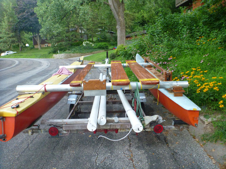

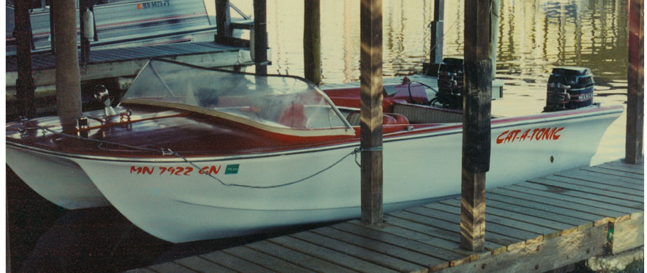

    I understand this discussion concerns "sailing" cats. My only cat was a '65 PowerCat motored catamaran for river cruises. Never had a pounding problem, heavy rig...the only irritating problem was going airborne and coming back down...when all gear-loose went forward...I figure now speed precluded the pounding...but with the outrigger I use the tramp to dampen the wash, until the speed (VMG) picks up...
