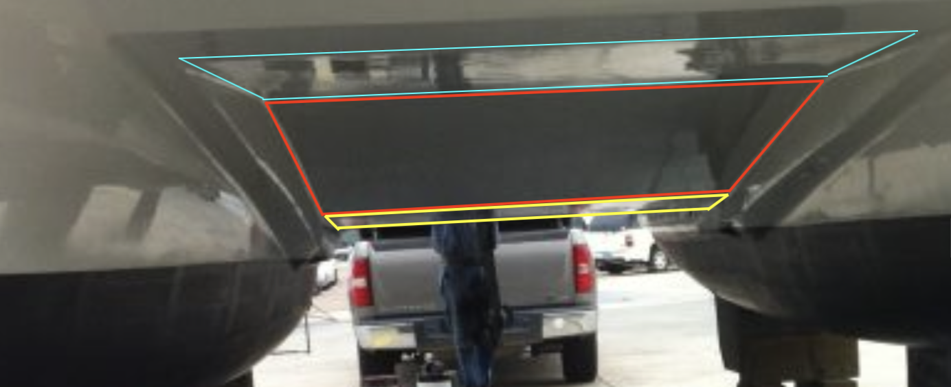

  13. brian eiland
    Joined: Jun 2002
    Posts: 5,288
    brian eiland Senior Member
    Many of the older cats would have approx 50% bean to length ratios. I don't see many problems with increasing this if you pay attention to 2 factors,..
    1) provide 2 substantial cross beams constructed in a sandwiched structural manner rather than just sheet of one material.
    2) provide an X reinforcement (cabling) within the flooring connecting the hulls,....LINK to come
    X-Beam and the Giant https://www.boatdesign.net/threads/x-beam-and-the-giant.14679/
    Sail Loading on Rig, Rig Loading on Vessel https://www.boatdesign.net/threads/sail-loading-on-rig-rig-loading-on-vessel.2293/page-4#post-114487
    3) I would also consider a central nacelle structure to help minimize under deck pounding. Central Nacelle and Centerboard on CRUISING Cat https://www.boatdesign.net/threads/central-nacelle-and-centerboard-on-cruising-cat.69084/#post-960622
