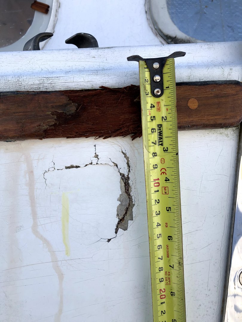

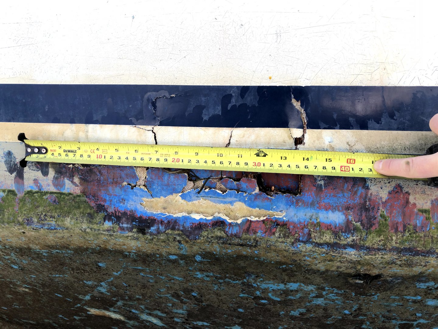

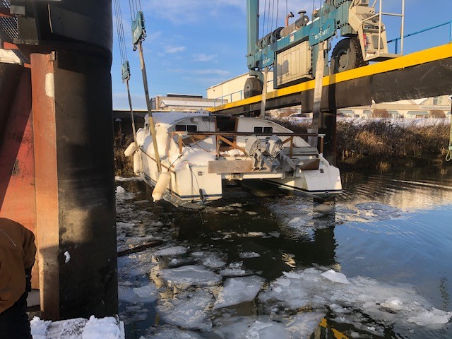

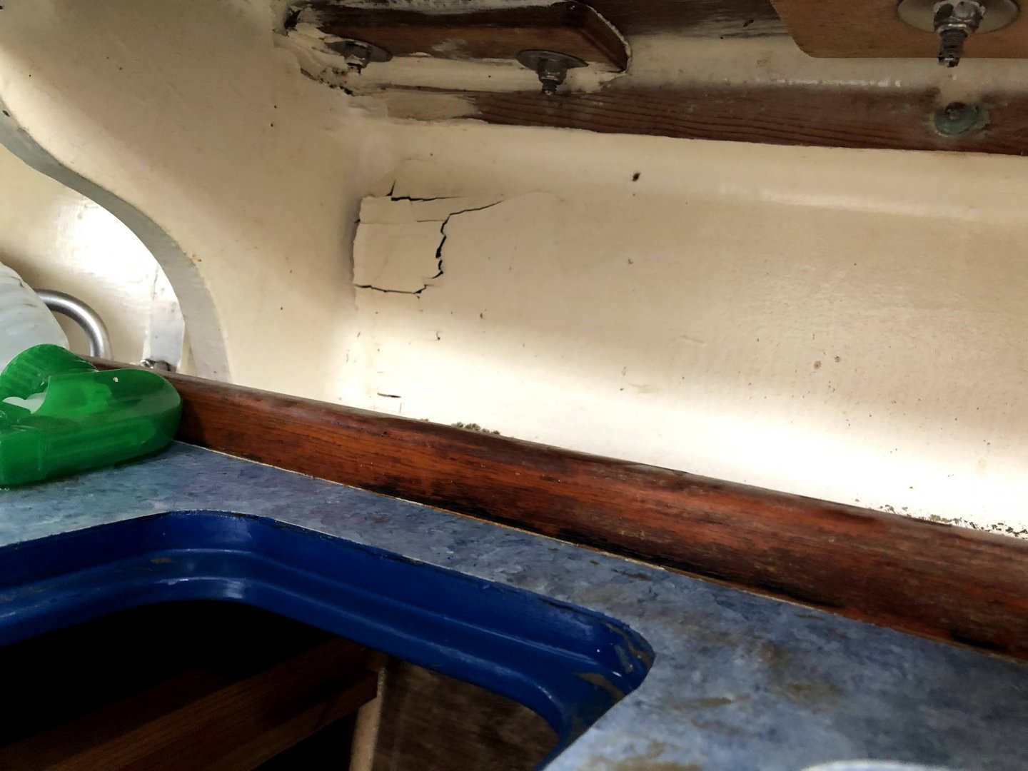

    In the beginning of the fifth year on the Fraser on January 15, 2020 there was a nasty winter storm and a metal encrusted beam but a hole in her on the starboard hull and she had enough of that and hauled herself out to the boat yard. She now demands that we fix the hole and clean up her hulls and catch up on the topside paint and bright work. This we can accomplish and surveyed the damage last week, some kitchen appliances the two big holes and two smaller drill holes I paid for.
    We took out her water tanks to access the holes and it is perfectly between the stringers so should be an easy fix. We lost a couple induction cook tops an inverter unfortunately and probably a 12 v trolling motor for the dingy and perhaps a 400 ft submersible light work class ROV remains to be seen. We did spend the night on her and flipped the switch on the solar and ran off the batteries and shore power that night. Have already ordered a replacement inverter. Left a light on and the dehumidifier running.
