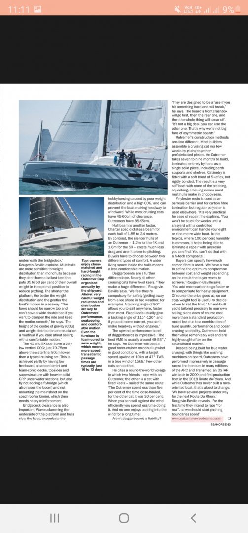

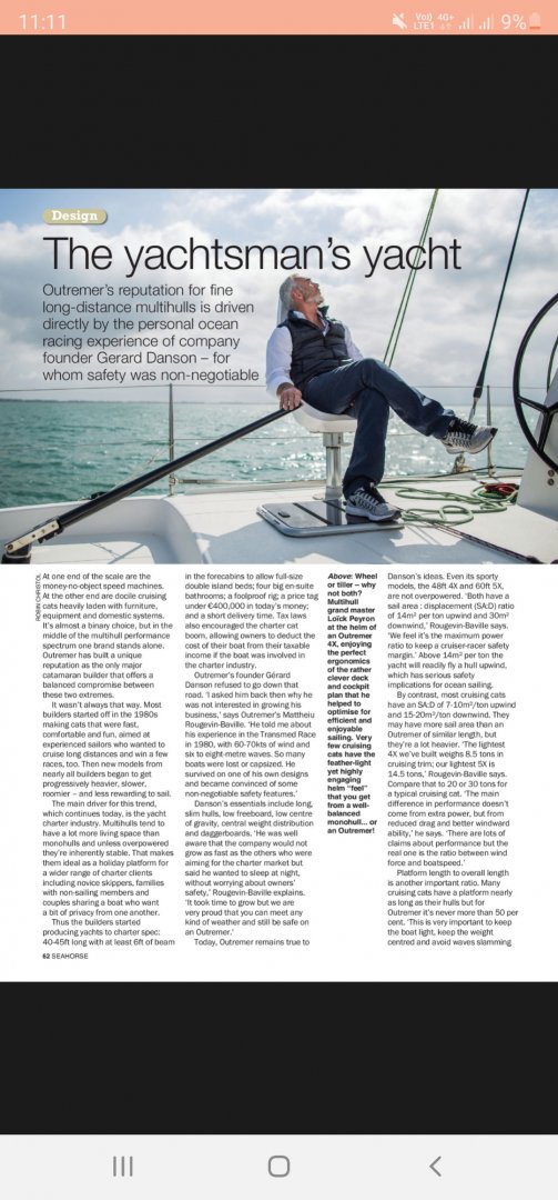

    A good article with some figures to start from.
