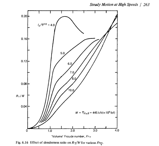

    Ad Hoc, I've been spending a lot of time the past couple days pondering that graph. Because a lot of the terms & coefficients are unfamiliar to me I've had to grind my way through them. But it's starting to gel in my head.
    What I find most striking about that graph is that, in the hull sizes, displacements, and speeds I'm interested in, a fairly small increase in length (10%) can produce a large decrease (>25%) in resistance. The added cost of hull length could have a large return in fuel economy.
    In that graph, is the Rt the total resistance or just the residuary resistance?

    Exactly. A simple increase, in length only, has a beneficial effect all round, not just powering, seakeeping too. Thus, if you can add a bit more length, do it.
    Rt is is total, and W is weight of boat, thus the speeds are quoted in Fv (volume Froude number). Not all graphs are presented in this way, but the basic trend is the same.
