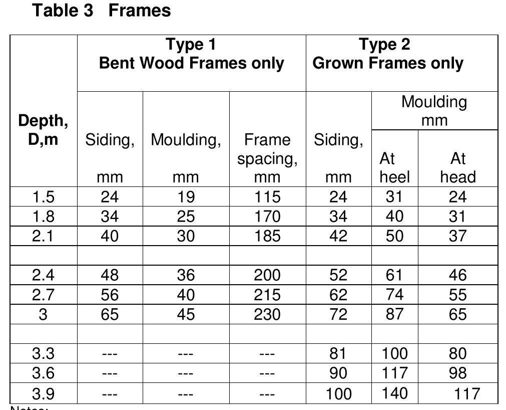

    My weight estimate using lyndsey lord scantling rules worked ok. I found the attached document very interesting, as an alternative/comparison with Dave Gerr rules. I have never heard of MARINA as an organisation. However Par has told me in a previous post if 9mm planks are required about 12mm ply is equal in strength. I am confident Par is correct. The required planking (page 22) for a 6M boat is 19mm OR 9.5MM MARINE PLYWOOD.:confused: mik

    The strength of planks are plywood are very different. To get full advantage of the characteristics of each material, the structure should be designed accordingly. Usually, plywood hulls are thinner than planked.

    Thank you Gonzo. I therefore must accept that the Marina organisation must have undertaken some sort of structural analysis in conjunction with their frame sizing and spacings. It also makes sense of the hull of a Tiki 21 in 6mm ply. At the same ratio a Tiki 21 would have 12.7mm planks, much nearer to what Gerr's rules calculate.:D Mik

    Current methods for calculating scantlings of small boats (between 2.5 and 24 m in length) use exactly the same formula to determine the minimum thickness of a panel, either strip planking or plywood. What happens, as with any other material, is that the minimum thickness does depend on the minimum bending stress parallel to the smallest dimension of the panel, for each material. According to that, as expected, everything depends on the quality of material used in each building system but apparently not dependent on the building system.

    Tansl I think I understand what you are saying. The frame spacing on Marina Hull rules I not large and panels would be small. What would you recommend for the deeper boats I think adding 5mm per size would make them very strong. Mik 2016-06-03_210055.png
