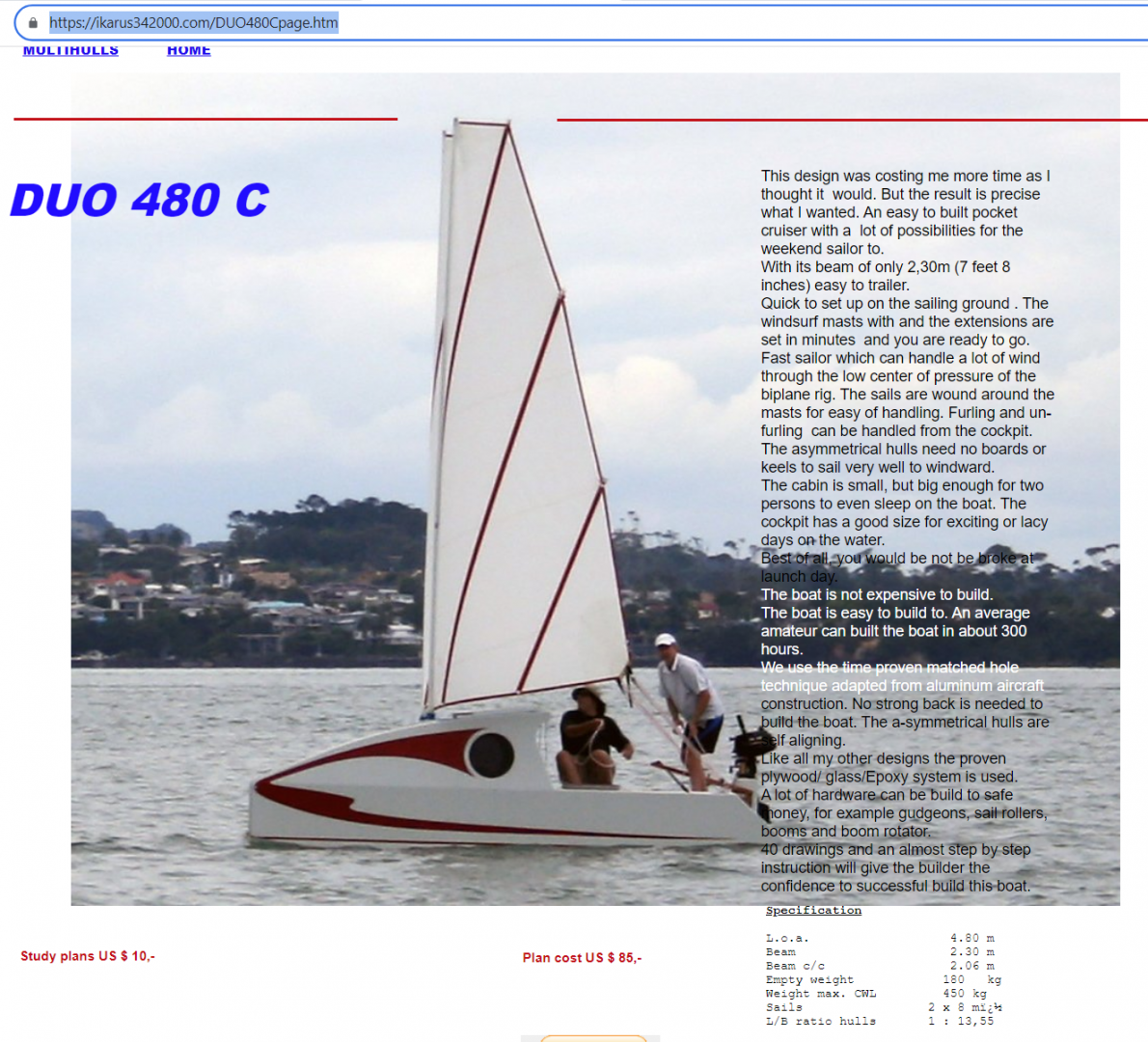

    [​IMG]How about this one. Duo 480 (K Designs). This is my own boat, lots of images and vids online on K designs website
    Cheers

    The suggestions by Banzai and RWatson above will probably 'fit the bill' very easily re your requirements - although they are small cats, they are still complex creatures to design, and money spent on buying a set of plans will be a small fraction of the cost of building a boat.

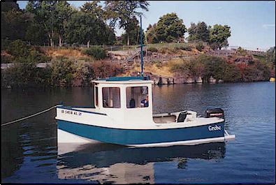

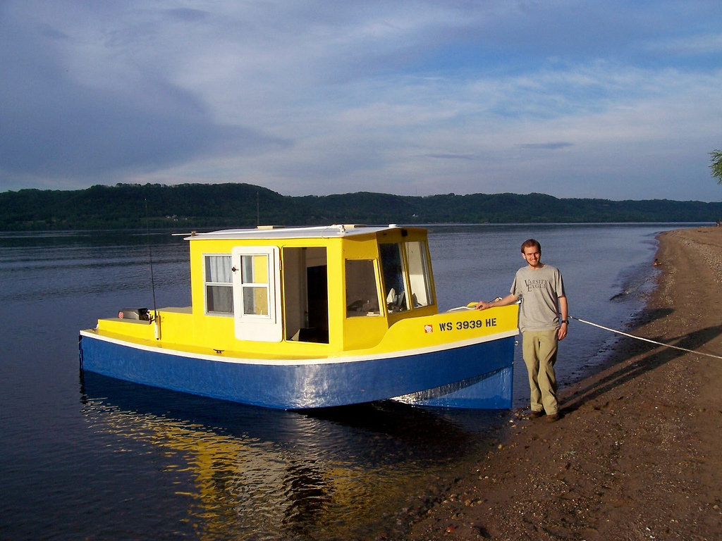

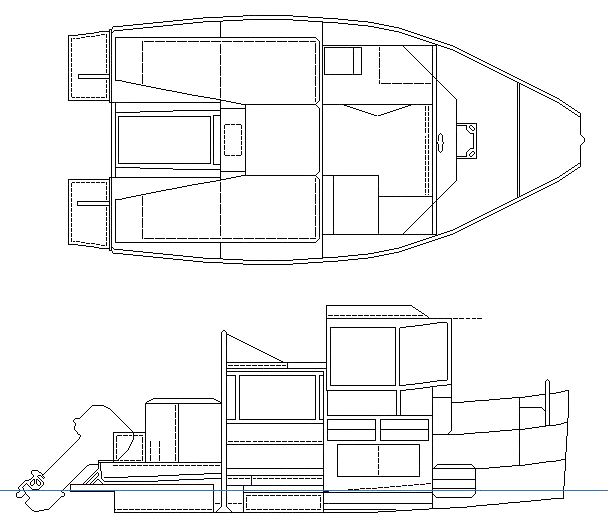

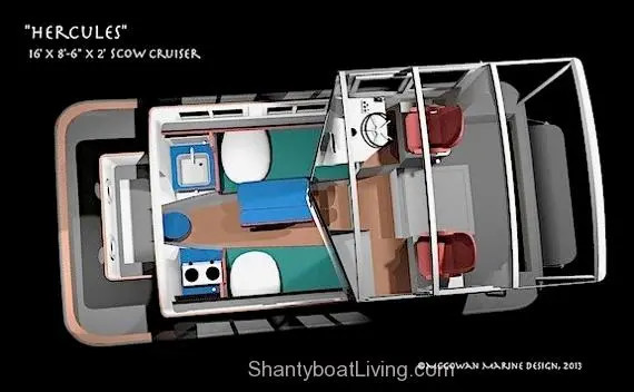

    David, I've read stability goes up with the cube of the beam of a boat. If that's true, and if you reduce the Jarcat from the standard 8'6" trailering beam to 7', you've reduced stability by 44%. My gut feeling (and that's not worth much) is that when you're comparing to a 15x7 monohull you're not going to have much stability benefit, you're going to have a pretty awkward interior, and the only real benefit is going to be somewhat reduced fuel and horsepower requirements at planing speeds. With this in mind it might be better to consider a monohull for the interior space, and just accept that you will need a somewhat larger engine to achieve the same performance.
    Also, have you considered widening your garage door to 9 or 10ft, installing a folding tongue on your trailer, or storing your boat outside?
    And have you looked at the 14.5 x8 Phil Bolger box keel microtrawler? It's basically the room of a ̶s̶c̶o̶w̶ sharpie with the box keel to break up chop forward and provide added space on the centerline. Supposedly this works well in a chop. Laurie McGowan also designed a microtrawler inspired boat for his woodenboat column called Hercules, though I doubt there are plans.
