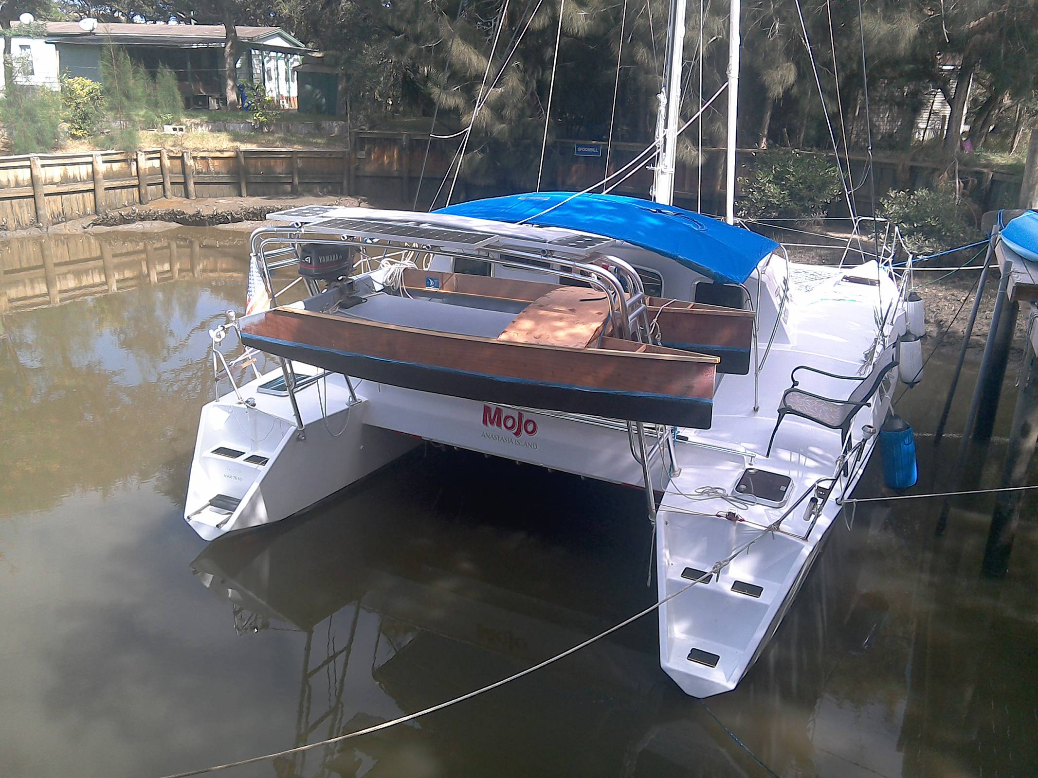

    Making some progress
    Weather has been good, so no issues working without a cover. Now also have both hulls glassed. Plan to weigh it tomorrow to get an idea of where I'm at. I doubt I'll be able to keep the finished boat under 50kg, especially since I've added some bouyancy foam under the false floors and aft under the swim steps.

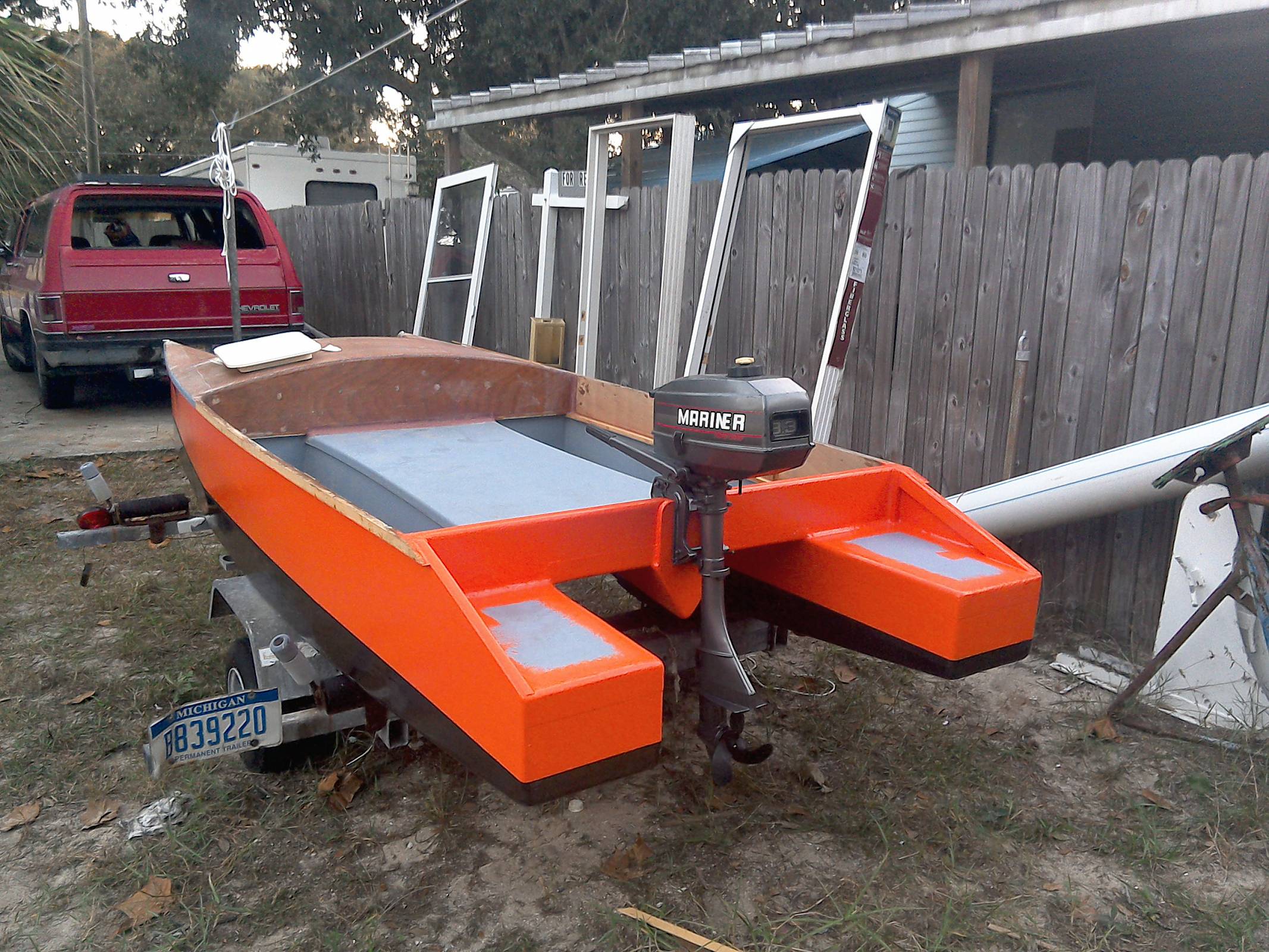

    almost done
    So I nearly have her done. Just the interior/deck paint and hatches and a few padeyes. Weight has gotten away from me and will be close to 165lbs. Good thing I used 4mm! But it is a pretty big boat. Fits nicely on the arch.

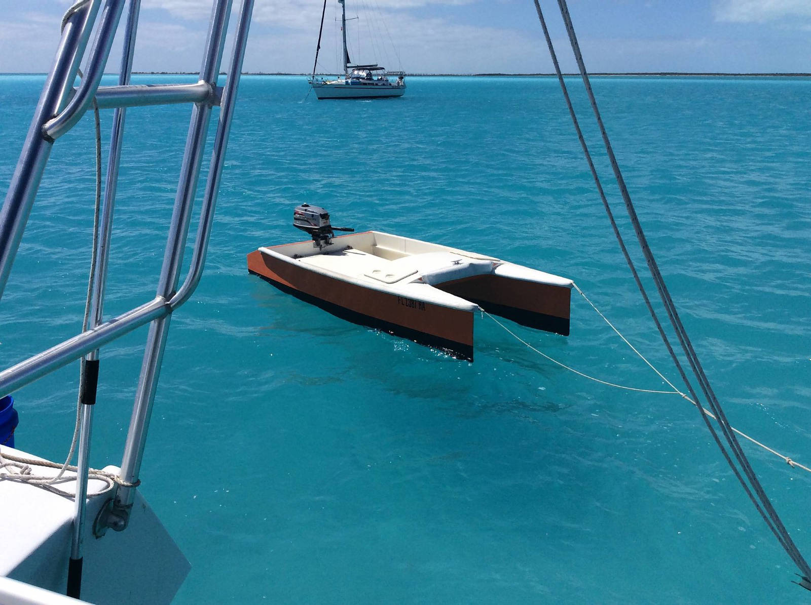

    Success (sort of)
    So the dinghy goes well at full load close to 700 lb total and 9 knots with this 4 horse I bought for $100 in Georgetown, Exuma. The main issue with the dink is the weigh (170lb) and length at 11.5'. I have some ideas about a 10' different hull shape and lower weight but hopefully nearly as easily driven.

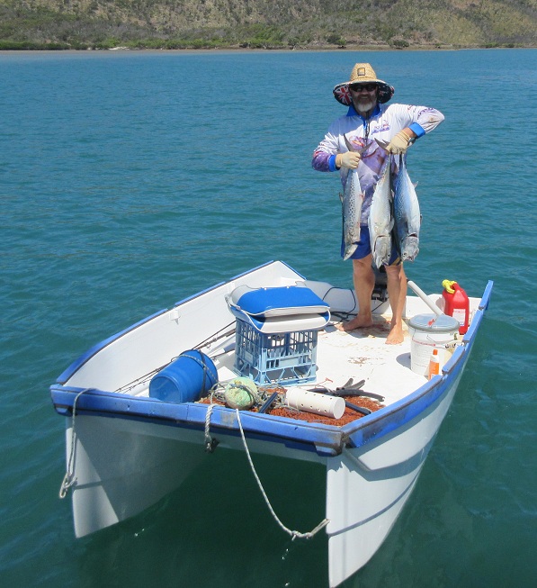

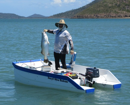

    nice work, Im from Australia and inflatables make up about 50% at least of our tenders. there are not too many cats used for tenders. we have only had heavy cat dinghys in the past with some of the newer kit ones even heavier than the old chopper gun molded cat dinghys which is beyond ridiculous, its just plain stupid. I have an 11'6" dinghy that weighs 45 kilos, 100lb, and it planes quite well with a three hp yamaha. I think the cats are better suited as tenders, they are easier to push in displacement mode with heavy loads and easy to row at a reasonable speed. weight is a problem when building and I resin infused mine to keep the weight down, it has made the hulls really tough though so it was worth it. I made mine self draining with one big flat floor and it is fantastic, no more bailing for me, it also makes for a lighter dinghy without all the decks, hatches etc. its not for everyone though, some people just love inflatables and the spartan decks and big open spaces of my dinghy dont appeal to everyone. anyway good luck with your project Im sure you will be happy with a little cat for a tender they are great. they are especially good for fishing!!!!
