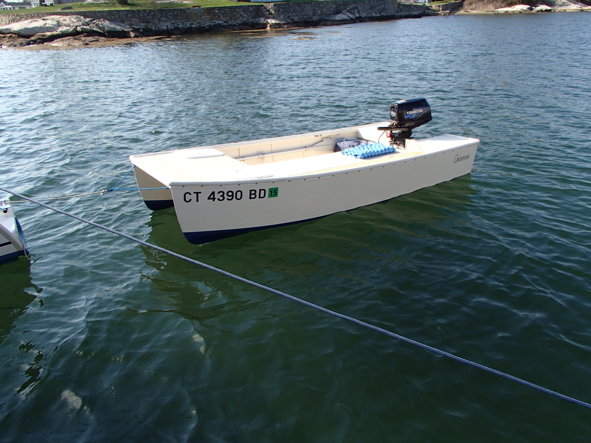

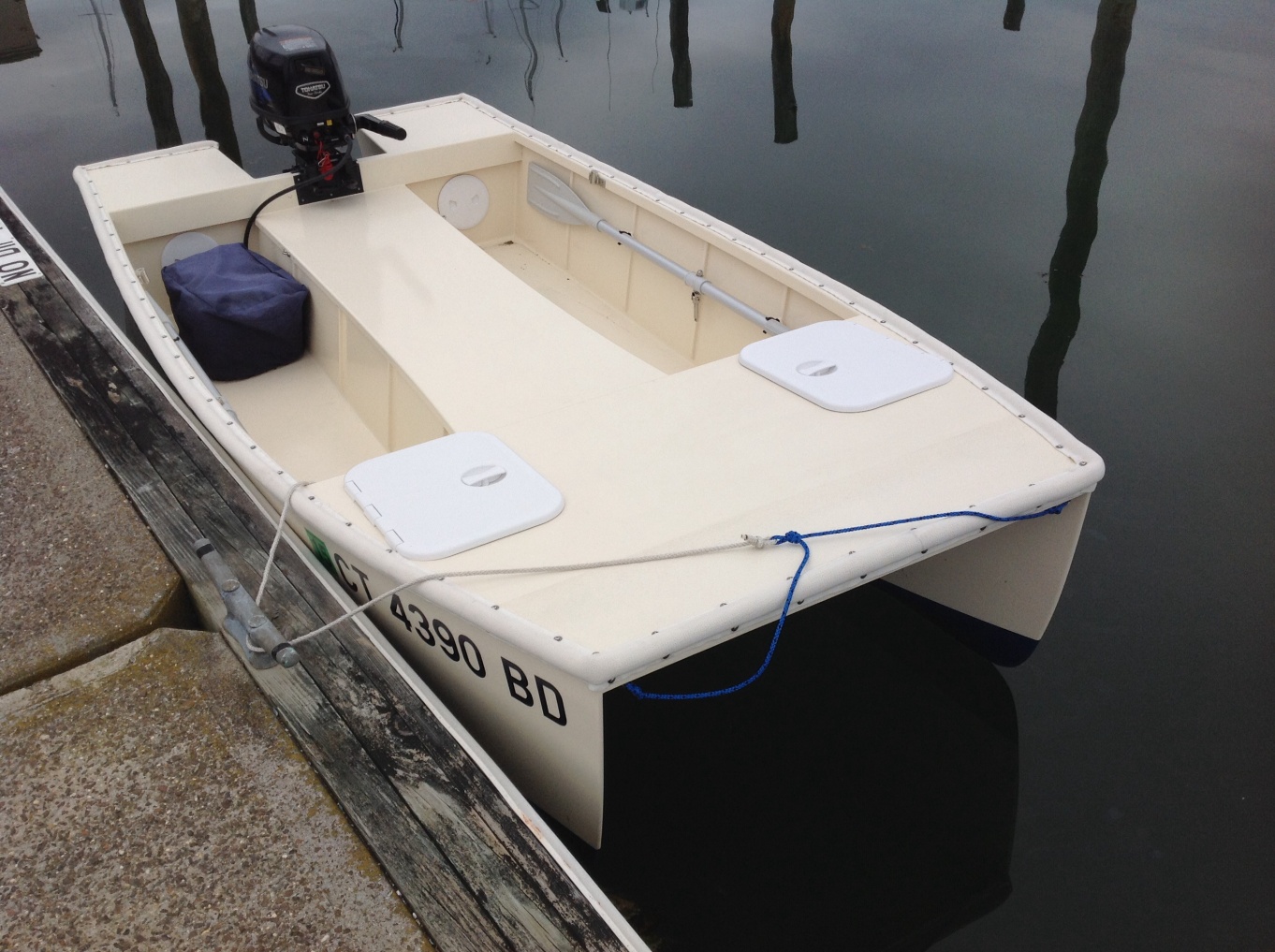

    10" CATAMARAN DINGHY, Fast, Roomy, and Dry at any speed into wind and waves
    Catamaran Dinghy Specifications
    1) Is 10’ feet long x 54 inch beam
    2) Weigh 95 lbs. without motor
    3) Very easy to row
    4) Dry when going to windward in a chop
    5) Easy to clean
    6) Holds four people
    7) Plane's easily with a 6 hp
    8) Easy to walk off the bow
    9) Maintenance free. No air, no leaks
    10) Hold up well in the Caribbean sun
    11) Turns on a dime
    12) Is fast and stable
    13) Fits on a car roof rack and is easily moved by only 2 people.
    14) Has two Aluminum Oars
    15) Stainless-Steel Oarlock Side Socket base

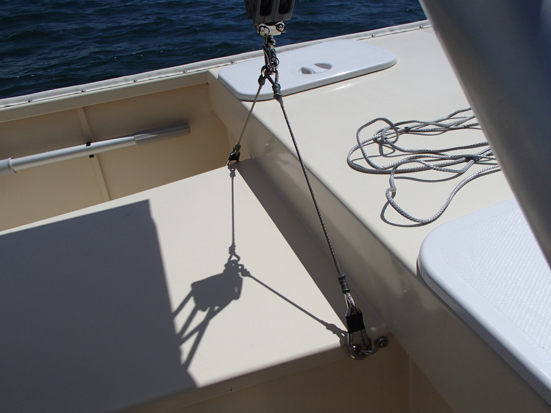

    16) Four SS Lifting Eye Straps 1-7/8"L x 7/16"W for hanging dinghy off davits
    17) 3/4 – Round Gunnel Guard all the way around
    18) Two Rectangular Access Hatch’s, Overall: 11-1/8" x 14-3/4"
    19) Stainless-Steel Rub Strakes to protect bottom when dragging up on a beach
    20) Made from composites, epoxy and fiberglass layup
    21) Optional: Mount a folding ladder off the bow for stable diving and snorkeling
    This Catamaran Dinghy is very stable and fast. You can turn her hard over at any speed and she turns flat and on a dime.
    She is just an effortless pleasure to row. I easily rowed her for over a mile, you can go full speed into a 20 knot chop and be dry as a bone.

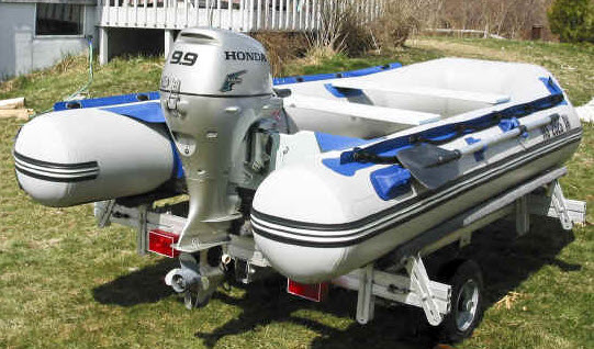

    Why a cat dinghy verses and inflatable.
    1) Most inflatable’s give a wet ride in 15+ knot chop
    2) Inflatables are noisy when tied behind the boat and water laps up under the tubes
    3) Inflatables need more HP to push them
    4) Inflatables row poorly
    5) Inflatables turn poorly
    6) Inflatables get stains and are hard to clean
    7) Inflatables do not hold up well in the sun. Need expensive chaps in the Caribbean sun
    8) Inflatables get leaks and most need to be repaired in just 4 years.
    9) Cats Plane 600 pounds with only 10 horsepower
    10) Cat seating arrangement gives you the advantage of choosing the direction you wish to face.
    11) The Cat Tunnel increases the hull planning efficiently, by causing the water flow through it, to form a pressure which enhances the lift
    12) Cats are Super Stable, roomy, safe and can carry a big payload and still plane with low horsepower.
    13) Cats have no feeling of getting up on step, they transitioned smoothly from slow to high speeds.
    14) Cats turn on a dime in both low and high speed.
    15) Cats make great stable dive and snorkel boats with a folding ladder off the bow
    16) My 10" inflatable would just barely plane with 2 people with a 6hp engine. This 10" Cat dinghy easily planes with 2 people in it using the same 6 hp engine.

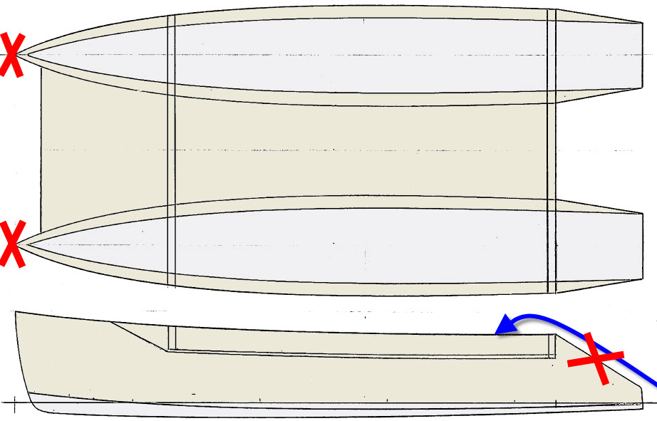

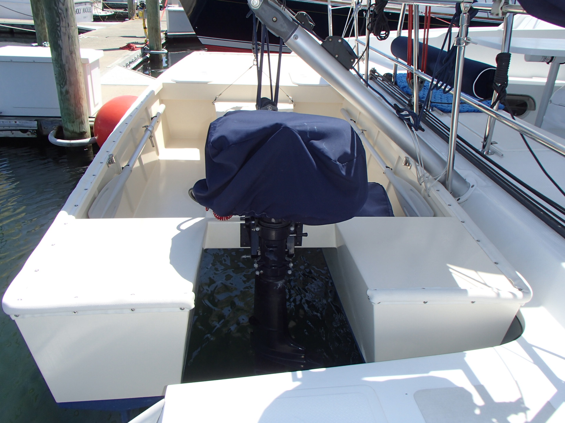

    2 things to watch out for when making a cat dinghy with a motor on it.
    1) DO NOT taper the sterns, as water will run up the sterns into the boat when you let off the outboard engine throttle. You will be ankle deep in water within the first minutes of using the dinghy.
    2) If your going to hang your cat dinghy from davits on the back of your mother ship then DO NOT put those pointy cat ears on the bows. Connect both bows and leave a straight line from bow to bow. The reason is that pointy bows will do major damage to your mother ship as it sits between the mother ship hulls and bounces on any wave action as you lift it up on the davits.
    The square bow also allow you to walk on and off the cat dinghy easily.
    It also allows you to push your mother ship or save other cruisers boats.

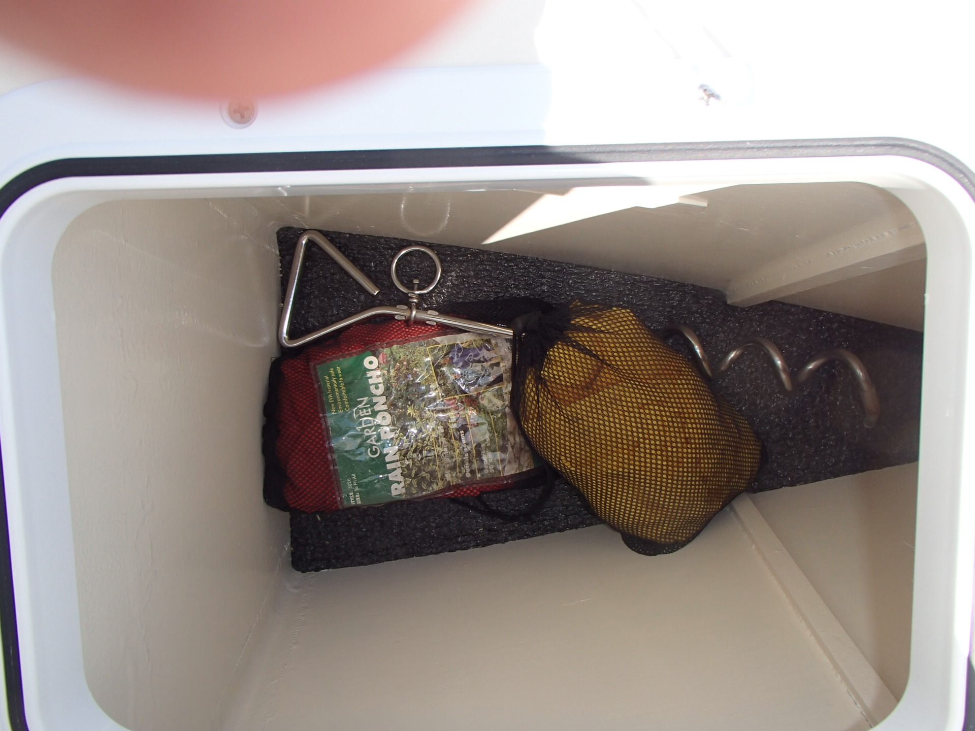

    The hatches are a real + for PFD's and anchor with line and flashlights and rain gear.

    I guess that explains the difference between the look of your dinghy now and as built by Mark.
    I will have the pointed bow as it has to straddle an arch. I take the point about getting on and off. I'm thinking of maybe having a drop in piece to fit between the bow if it's a problem. The other option is backing into a dock which might actually work pretty well in most situations.
    My sterns aren't quite angled the same way as there is a swim platform and a higher transom.

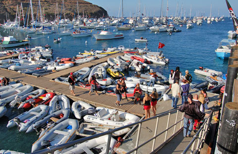

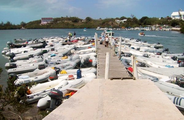

    I have saved many a boat by pushing it with the dinghy bow, so a none pointy bow is very important for a cruising boat dinghy.
    Dinghy docks are packed everywhere cruisers go. You have to use your motor to push your way into a slot. Walking off the front of a Cat Dinghy at a dock is a MUST HAVE.
    My Wife would shoot me if we backed into a dock and she had to walk over the gas can and engine.

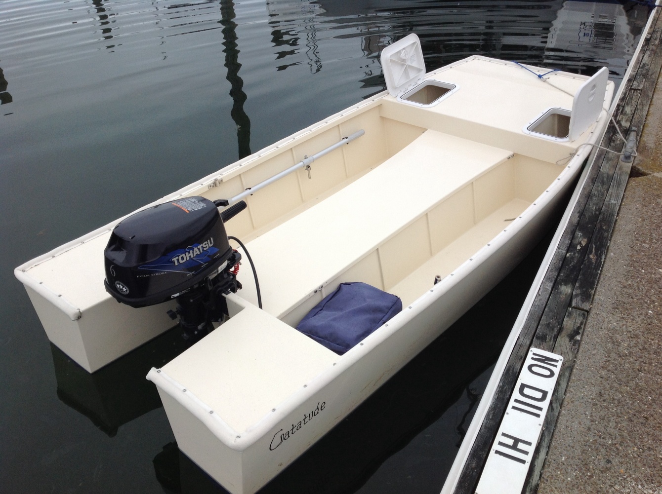

    Not much new here. Catamaran dinghy's have been around for a long time now.
    Working on a 12 foot model over the winter with an even faster hull.
    Just like an inflatable, catamaran dinghy's have to have hull extensions past the engine. With out the stern extensions the Cat dinghy would just bow up when you give it throttle.
