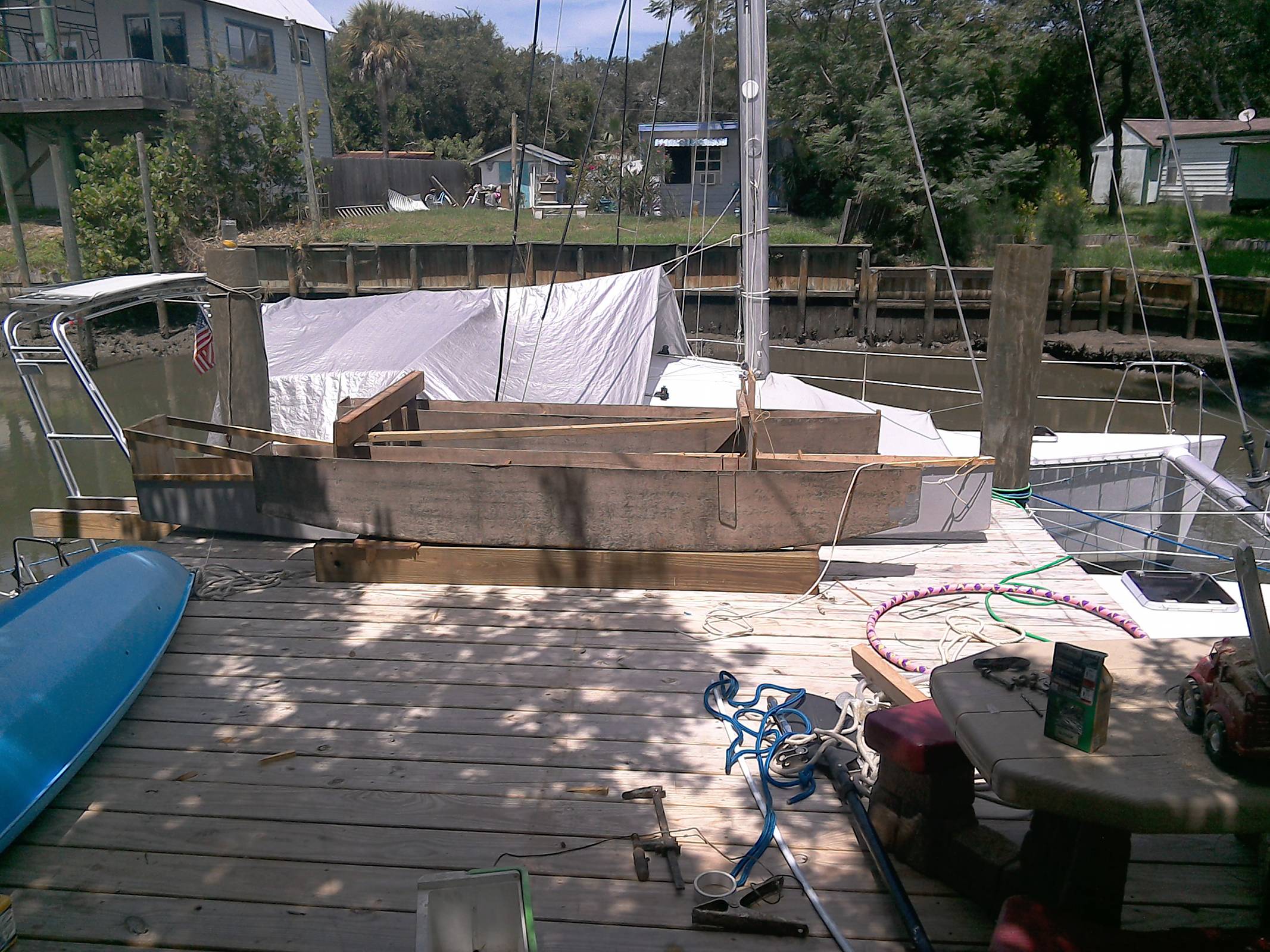

    Ok, today was the day. I morphed the cat model onto the long hull blocked up 5.5" to hopefully minimize the drag and flotation provided by the extra hulls. All up weight was just about 45kg for the hulls somewhat I expect the final boat to be.
    With me 65kg and the 3.3 hp I got 10.5 knots.
    Add 55kg of 8mm chain and it's 8.5 knots.
    Add another 25kg and its 7.8 knots. And at this load, the outer hulls are certainly dragging quite a bit and close to the max 220kg design goals.
    I also hoisted the 11.5' hull onto my arch/davits and it really fits quite well. So I think at this stage, its a go for the full size dinghy. Will likely start it in the next few weeks.

    Ran it the next day with a 6hp 2stroke and the pile of chain. Despite my spray skirts, I was shipping a lot of water but did get 11 knots. She does noticeably pull out of the "hole" with the bigger motor. Not really planning though either. Will report back when construction commences.

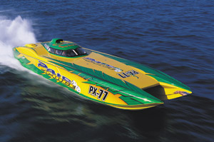

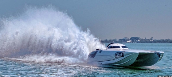

    Sorry, that's complete nonsense.
    Any hull can plane if the hull lines are designed correctly to facilitate the flow at high speed -owing to the pressure wave created - and enough power.
    Here are just two of many thousands of examples:-
    Think you need to go back to school on this one!
