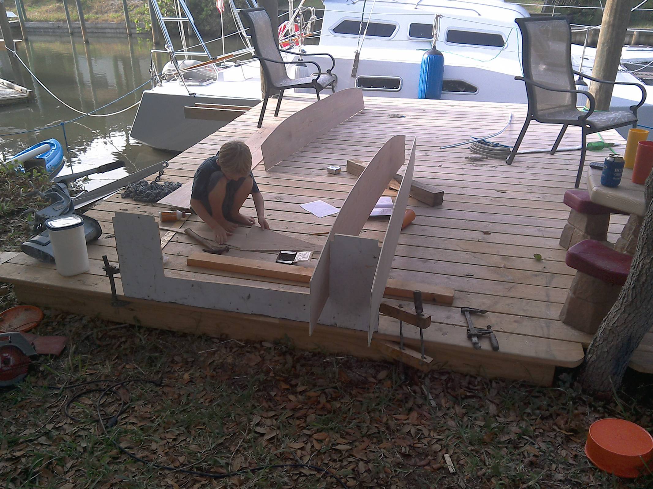

    don't laugh!
    Here is a pic of my test model I started late this afternoon. I went with a good bit of taper aft. transoms are about 75% as wide as max beam. my only intention is to test this a few laps in my canal. If it floats!

    Even if it is only a model, please check up the displacement of the hulls before you clap the sheets of ply together and paint them. Great boat in background!

    I don't have any intention of painting it. If it last a few hours deter launch I'll be happy. Full old displacement I meant to be only about 100 kg. The sea water canal will do the calculating.

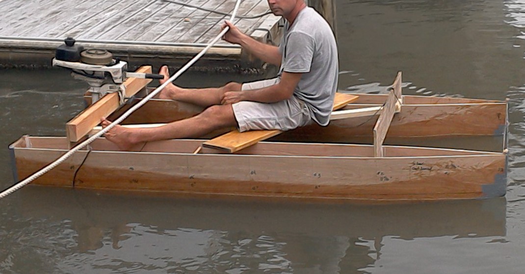

    she floats
    Ok, her she is 100kg loaded. This scales to about exactly 300kg at 11' Floating just above my guesstimate waterline black marker waterline. I did make it just a bit deeper for a 7" loaded draft on the 11' model. Will try and check immersion rate at waterline tomorrow.
    I get 5.5 knots so if that scales I would get 7.9 knots at 11'? That is the question. 5.5 knots is pretty fast for a 7.8' waterline. Is more possible?

    stabil
    And she is pretty stable. I can stand in one hull with no problem. I would think the bigger version will be 2x or more stable. I may do a bit more testing and try to look at wave shape between the hulls, would be good to make the full size 11' version a bit narrower. 5.5' seemed ok, but with the hulls so narrow it makes for a big bridgedeck.

    Congratulations! What a great little testbed for your project. I really don´t know how to scale it up - linear or exponential and how much to get the final stability. But the little cat looks stimulating.
    I think it might be interesting to test the waterflow around the hulls and between at different speeds. How do the bows raise and how the sterns are sucked down? May be it will encourage you to modify the underwater area.
    Your son will love the small catamaran when you don`t need it for further testing and he will give it some paint because it is worth while.

    With the same 5 hp outboard, you expect to go faster with a scaled-up version of this ? Won't be happening.
