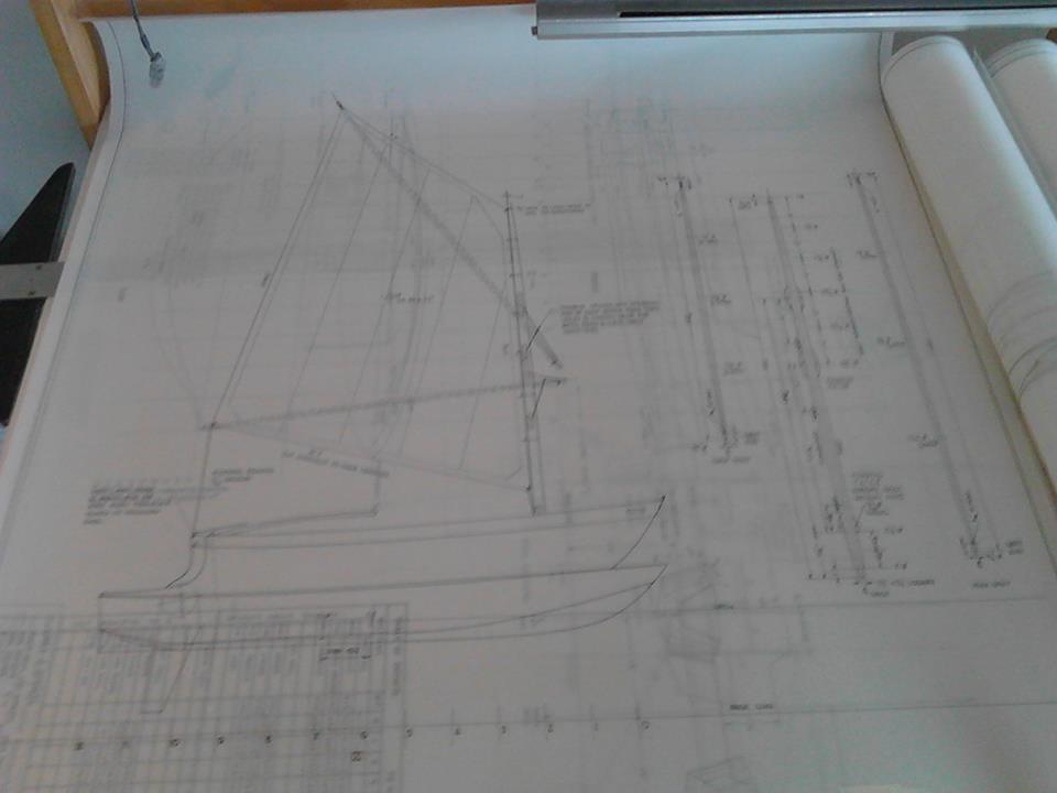

    So it seem a good performing cat dinghy is very difficult to design. It looks like Robs is meant to be close to 13' long but maybe 11' or 3.3m is the longest I can squeeze on my arch.
    I don't really need it to fully plane as I'd be happy with 8-9 knots of speed with say a 500 lb or so payload. Would ideally like to power with a 5 hp. So I'm thinking maybe some type of relatively narrow but deep full displacement hulls? Maybe with as much as a 6" hull draft loaded would be ok.
    It seems most attempts are for full planning boats with very shallow hulls. I'm wondering is. Displacement hull with an 8:1 or so l/b perform how I want and carry the load? Maybe 10:1 is possible?
    Any thoughts appreciated. My RIB is on its last legs!

    Why a catamaran ? I'd say nothing will do 8 or 9 knots with a 5hp motor carrying 500 pounds, there is too much conspiring against you in an 11 foot boat.

    I think you'll need more than 6" draft.
    What are the red lines for dimensions ?. What materials will you use?

    Says who..and why?
    Do you not see the inconsistency with this statement? A deep draft hull yet you have already limited the draft to rather shallow?
    Hmmm...well,
    Based upon these spec's you're lucky to get circa 150 kg of displacement, or some 350lbs, unless you want a hull that is a brick? With the average weight for a person US of 85kg, you're lucky to have a boat made of paper being propelled by a mouse in a wheel rotating a paddle, just to maintain the 150kgs displacement.
    Have a serious think what it is you really want..and then ask someone with experience in design to tell you what you can actually achieve. Since your first attempt has failed rather badly I'm afraid.

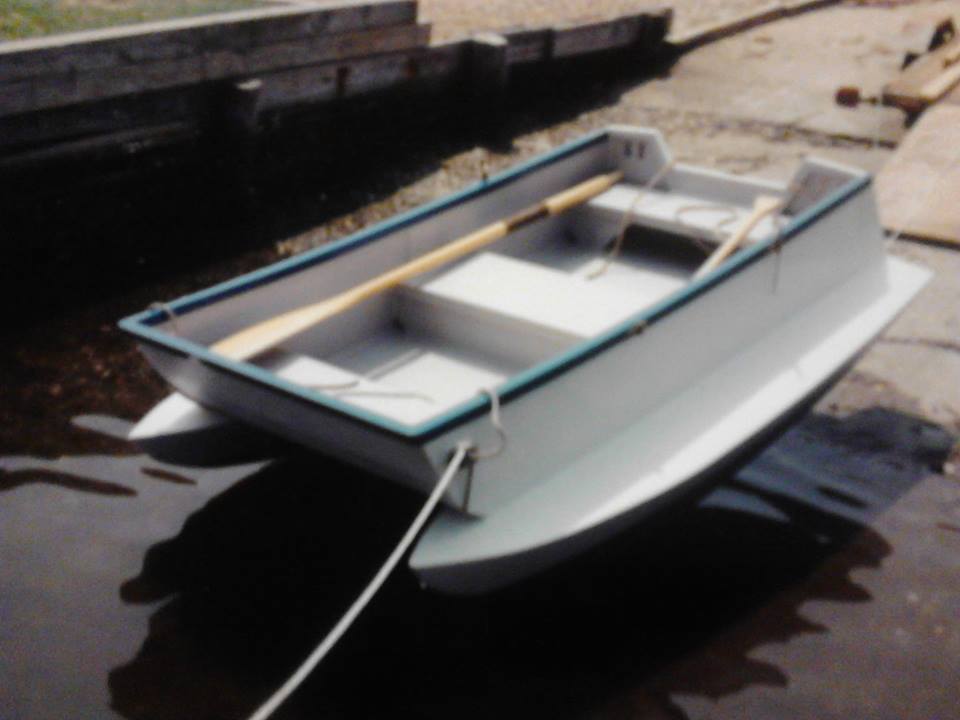

    I doubt by "Robs" you meant Rob Denney's cat tender. As it serves instead of a motor sled to large Harryproa's it already features a 25 hp outboard, eliminating the need for an additional 5 hp just for the tender. This dual use of the thus bigger outboard meets your requirements given your dinghy is meant to complement a cruiser.

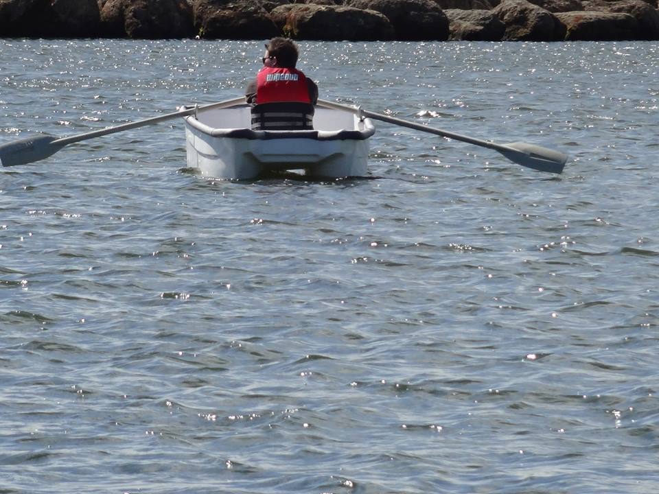

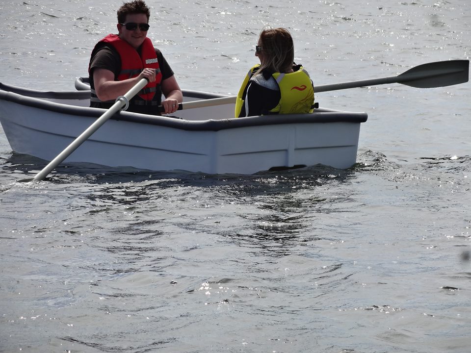

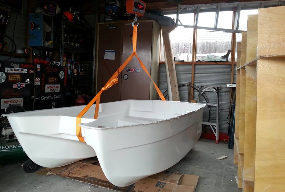

    Matt one of our trade qualified boat builders finished the prototype dinghy off. It is seen here with 170kgs in it two up rowing with the prototype weighing in at 40kg being over built for thrashing as our test bed. The production built version is 20kg epoxy build.
    It rows and powers well next stage of development is to get it sailing with fold out hiking seats and a centre board.
    It will be built first as a rigid dinghy and is available for purchase in size ranges being standard at 2.2m with 2.4m, 2.7m, and 3.0m options. Available in standard gel coated polyester and the option of Gel coated infused post cured epoxy for the lightest strongest dinghy build on the market.
    The EZIFOLD folding locking dinghy based on this prototype will be coming soon.

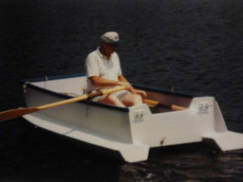

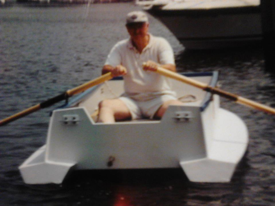

    Patented Unique catamaran dinghy plans available
    Quite some time ago the rights to this amazing little dinghy were purchased. As usual prototyping took priority.
    Plans are available on our website.
    As drawn it is 8'10" x 5'5" (2.7m x 1.7m) while the prototype was built in ply it is designed for ultimate performance to be glass foam build. It then comes in at 38 to 40kg the floats center line is 3'6" giving plenty of room in the bridge deck which is 10" (25.4cm) above the water at rest empty and is self-draining. With 250lb or (114kg) aboard the floats sit on their waterlines and are designed to plane at 15 knots with an 8hp outboard. To enhance rowing or sailing for purists hull extensions are in the plan set. When towed empty behind a sail boat it generates 1.4lb or (.6kg) drag at 5knots. It is calculated that it consumes 3hp to be towed on the plane at 21knots behind a power boat. The design states loaded at 1500lb (680kg) the catamaran floats sink and the bridge deck takes up buoyancy and stability contribution as a stabilized punt. The basic idea behind the design was for fun and functional use while being efficient to tow so it doesn't need constant stowing between cruising hops between bays or islands. Further information is available through emailing inquire@ezifoldyachts.com

    I presume I am the Rob referred to. The harryproa tender http://harryproa.com/?portfolio=tender is indeed 13' long. A shorter version would be easy enough to build. "Just" knock 2-3' off the sterns.
    Hull shape on a catamaran dinghy is not going to make a big difference to handling under motor. It will be harder to row than a mono dinghy, but speed will depend mostly on the motor and the weight carried.
    Wider hulls are going to be a better bet than deeper. A scow (cat with no tunnel) is the best load carrier/speed machine available if you don't mind slamming at high speed and probably worse rowing performance than the cat. It is certainly easiest and lightest to build.
    Tell you what. Build an Elementarry (see other thread) and i will throw in tender plans for a version that best suits your needs for no charge.

    I think getting 8 knots with 250kg aboard is going to be very hard in 11ft. 20 knots will be just as easy as you are going to have to plane.
    Do you need 8 knots with two of you in the tender? Is 3 okay instead? If you need to go faster then it will cost you as even a cat tender has to plane to get to this speed.
    A friend has the same dinghy as mine, same mould. he is a fair bit heavier than me and his doesn't go faster than 5 knots with the same outboard. With his wife as well the thing is slow but he, and me, don't mind slow.
