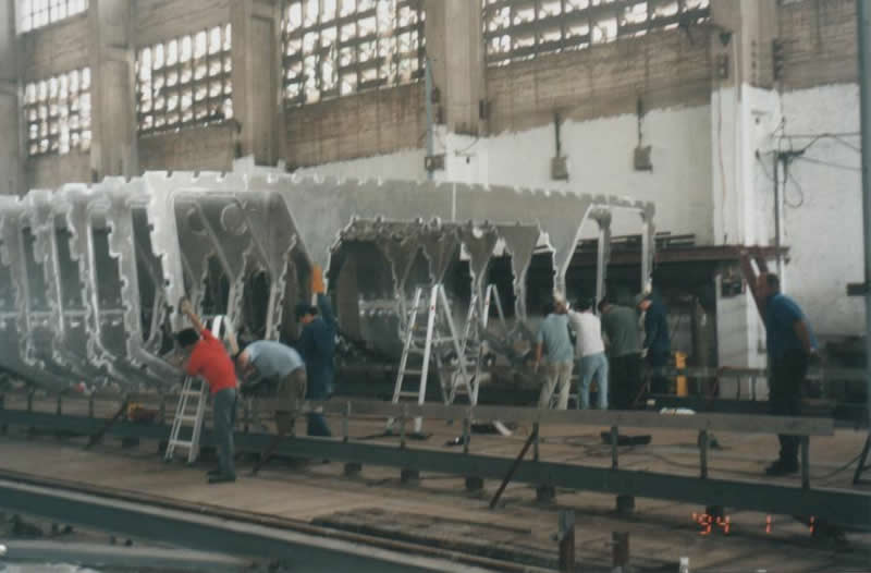

    I have found that so many catamarans are designed with continuous transverse frames, as shown in the picture. But, what I have known so far is that it would also be possible to build one with two separate demi-hulls attached with the deck plate and a number of girders running between the two hulls. What are the pros and cons of the two designs?

    A catamaran needs to have several cross beams to absorb the stresses occurring due to the relative movements between the hulls. Once this is done, you can put as many longitudinal elements as you like, but they will not help you to solve the problem mentioned.

    My question is_ I think there're two configurations of catamaran structures.
    1. continuous transverse frames existing in both two hulls and also between them. (as seen in the photo)
    2. transverse frames are not continuous from hull to hull. A number of cross beams connect the two hulls and a deck plate cover over them.
    What is the difference between them? Thank you, for your attention.

  5. Richard Woods
    Joined: Jun 2006
    Posts: 2,208
    Richard Woods Woods Designs
    As asked I'm afraid the question is too vague to get a sensible answer. Are you talking about a commercial power catamaran, as in the photo. Or an open deck sailing catamaran as eg, Wharram designs?
    Obviously the two concepts are very different and need completely different structural designs to hold them together. You could never use a lashing system to hold the hulls that you show together

    I'm sorry, if my question was too rough. I was talking about a commercial power catamaran here, not a sailing catamaran. I'm afraid if I might annoy you with this question, but, could you explain a little more detail about these two concepts? or, guide me some resources where I can learn about them?

    You need to understand that, simplifying, there are three types of effects that should be supported by the structure of decks between the two hulls:
    - Relative movements of the two hulls, absorbed mainly by the transverse beams, which must be continuous.
    - Loads on the deck, which can be supported by the plate deck panels, with beams and girders.
    - Beats of sea, waves, slamming, on the wet deck.
    Each requires a specific solution.
  8. Ad Hoc
    Joined: Oct 2008
    Posts: 6,898
    Location: Japan
    Ad Hoc Naval Architect
    There are two basic differences
    1) Labour. The is a difference in the amount of labour and hence cost of construction. One is better/quicker than the other.
    2) Structural. So long as the main transverse frames of the hull and raft line up between the hull and centre raft structure and the deck plate is continuous between the hulls, it should not pose any issues.
