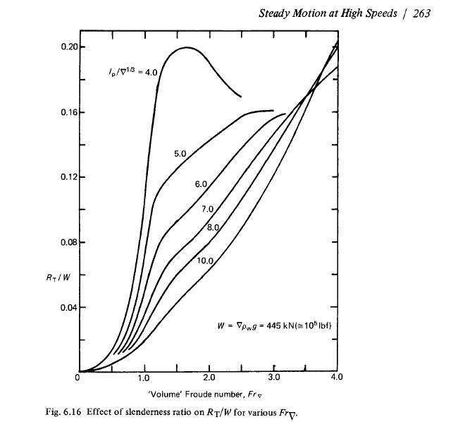

    Yes, their performance figure state done at 22,800lbs:
    http://www.mecat.com/power/powerupdates.htm
    Later in the blog, they state this to be 11.4 ton, which is a short ton, and a nonsense unit (22800lbs = 10.34 tonne) just trying to sound heavier than it really is..
    for the P47 which would have an L/D of what..6.3 on those figures, very different from yours!
    Thus you need to be carfeul to compare apples with apples. sales stuff is always misleading..for obvious reasons.
    If in doubt see attached:
    You can see the effect of L/D ratio very easily....yours at 4.7-ish and the P47 at 6.3. Don't need to be a rocket scientist to see why when looking at the curves.

    Apples to apples indeed. And with the hull modifications I've proposed, my L/D would be around 5.8.

    No, the L/D ratio is far too low.
