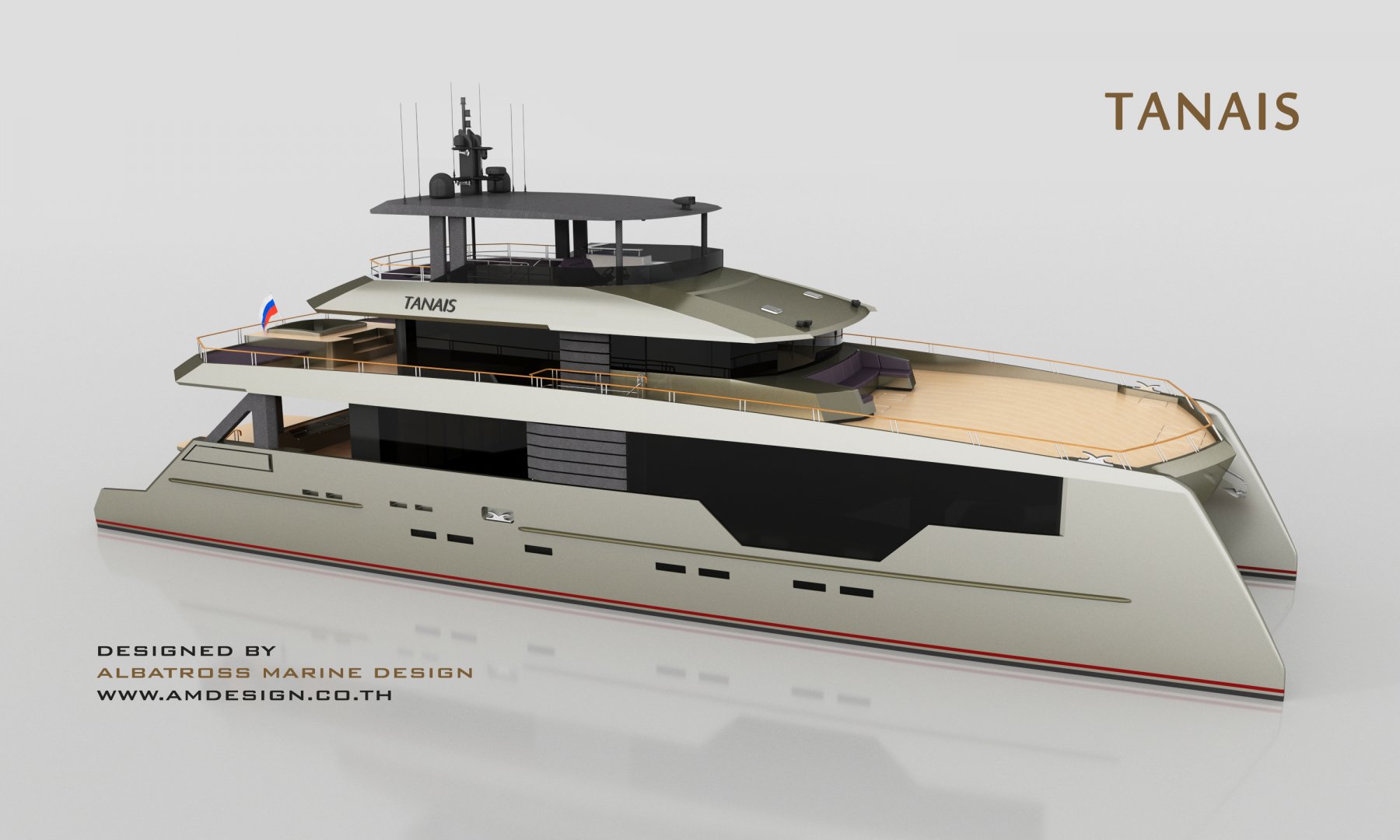

    Quite strange architecture... If they use higher forecastle, could get more accommodation space, better seakeeping. And the look will be much better!

    There are also objective criteria. Say, where are owner's accommodations on this boat? If on main deck or above, they will lack privacy. If in demihulls, they will lack space.
    My personal feeling, someone drew a concept of such boat (I call it 'pagoda on a raft'), maybe the Client himself defined such weird architecture.

    This is well understood about length-performance.
    However, this is a yacht, and accommodations should provide some sort of privacy. On the design I posted, there are side windows, and master accommodation takes the entire beam of the boat, and it is private! Given that, the bow is raised, thus allowing higher vertical clearance at bow.
    And if the bow area is shaped properly, the boat can use her anchors. I wonder if the guys designing Metal Shark boat ever sailed on a catamaran? This is what I always say: design of boats is all about understanding of boats.
