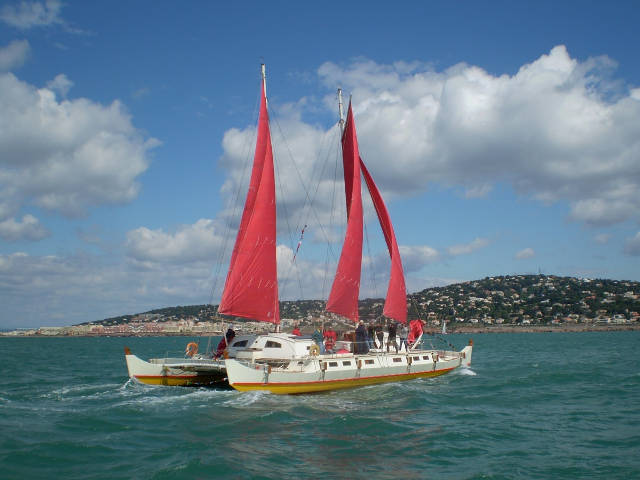

    The little one finds about efficacy of cat ketch rigs on multis- trimarans in particular- seems to point toward better performance with the aft sail and mast removed. Newick White' Wings is the example that first comes to mind, as not tacking well with the aft rig. My recollection of source is foggy, but I recall something about a rig that worked fine on a traditional mono didn't work out on a tri. Can someone shed more light on this? Is it a matter of balance between sails combined CE and appendage CE, along with momentum through a tack? Can't figure why it would be intrinsically bad on mutlti vs a mono. Let's disregard structural and staying issues for masts and rigs if we can...

    tropostudio. Any rig if correctly designed will work on a multi as well as mono. The only issue is how fast the multi can go. Cruising catamarans or trimarans that sails at EG 60% of wind speed can run a ketch or schooner rig just as well as a mono. The only variation is the sails may need to be cut slightly flatter.
    If the multihull is a high performance machine that can sail faster than wind speed then there is more emphasis on fine reaching upwind work which requires a more efficient rig and generally that means a sloop or fractional single mast rig. (These are generalizations but the logic is basically sound).
    As usual there are exceptions. Very large multihulls can be fast and have multimast rigs for ease of sail handling etc and there are several racing multihulls that had schooner rigs that could go to windward very well. Also James Wharram claimed his Pahi 63 could go very well to windward with there schooner rigs.
    Of the confirmed fast multihulls with schooner rigs the few examples are Shotover and Jarcat 23 that raced successfully in Australia, Spronk cats that sail well in the Caribbean, The Nigel Irens (racing tri designer) designed 64 foot cat, many HarryProa's. This is just a few of some fast multimast multihulls. Have fun in your search.

    Thanks, oldmulti. I sort of assumed there as nothing inherent in a light tri vs a mono with ballast that would make it not tack well. I presume if White Wings performed better with the mizzen removed, then a poor design decision had been made originally.

    Fwiw my (very) little ketch rigged tri very clearly benefits from the mizzen for power, handling and tacking.
