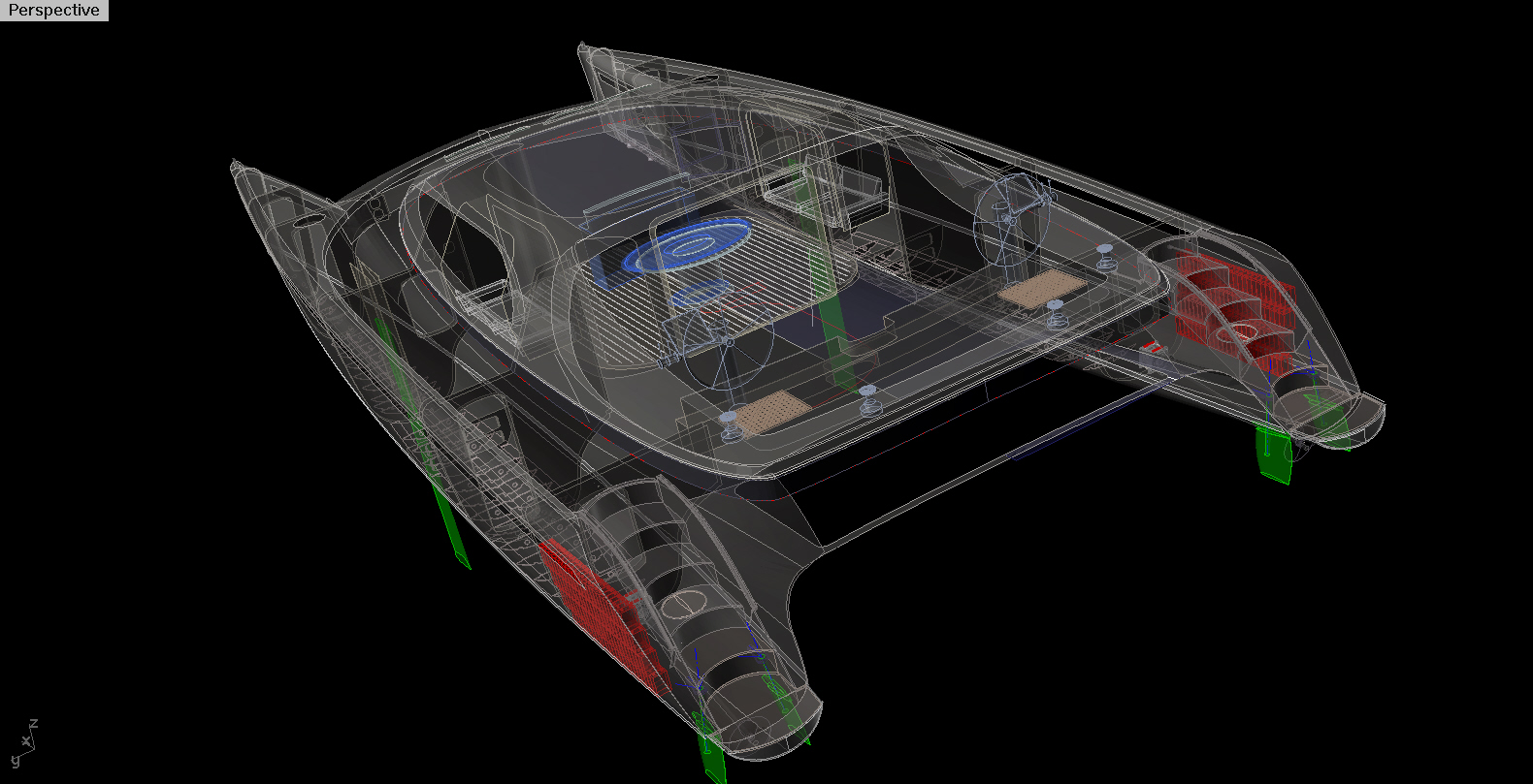

    It seems like my questioning is giving the wrong impression.
    The dagger board cases are indeed built into the completed hulls. Many years have gone into drawing and analysing every detail, first with Maxsurf then with Rhino. The stresses and displacements have been analysed with a finite element analysis software called Scan and Solve.
    As the building progresses, every assembly is weighed and the results go into an excel trim table. The trim table holds everything imaginable. The completed hulls have been weighed (2870 kg each) and the CoG verified by physically balancing each of them on a fulcrum. All the coefficients such as prismatic, LCB and LCF are derived from Rhino and Maxsurf. By pitching the hulls fwd and sinking the lee hull I can measure the change in the wetted surface areas and estimate the longitudinal and lateral stabilities.
    However in spite of all these efforts I have many doubts.
    Apart from the performance of the hulls out in the Pacific, there are plenty of other unknowns: the D shaped rotating wing mast, the electric propulsion and the rudder linkage. All of these present difficult design judgements.
    Here is a picture that sort of shows the fin cases forming a T structure across the front of the mast beam bulkhead. The arrays of red boxes in the engine rooms are Lithium Iron Phosphate cells for the 25 kW DC motors - more about that in another thread soon. The other picture shows CNC cut temporary hull frames.
    Thanks for your feedback
    Michael

    Michael. Your boat is fascinating and I have to commend you for doing it. One day I plan to also do what you are doing. But honestly, those daggerboards will be too far forward in my humble non professional opinion. Even with my 2.4m screecher pole and 70m2 screecher, 69m2 square top main and no daggerboards down I still have maintain 5 deg of weather helm to steer straight. You say your bows are just skimming the surface. Then do this thought experiment. Look at your sail and appendage plan and lop off the front of your hulls in a visualization as you said yourself they are not attributing much to the displacement. Now how far forward do the daggerboards look? They look even more extremely forward.
    I think your project requires a thread of its own. I hope you find the time to make a thread for it. I have many questions to ask, like does it have 4 rudders? Then what is that item which looks like a rudder drum with a dagger rudder? Where are you located? What is the target weight? I am sure the boat in its finished form will be awesome. Please start a thread.
