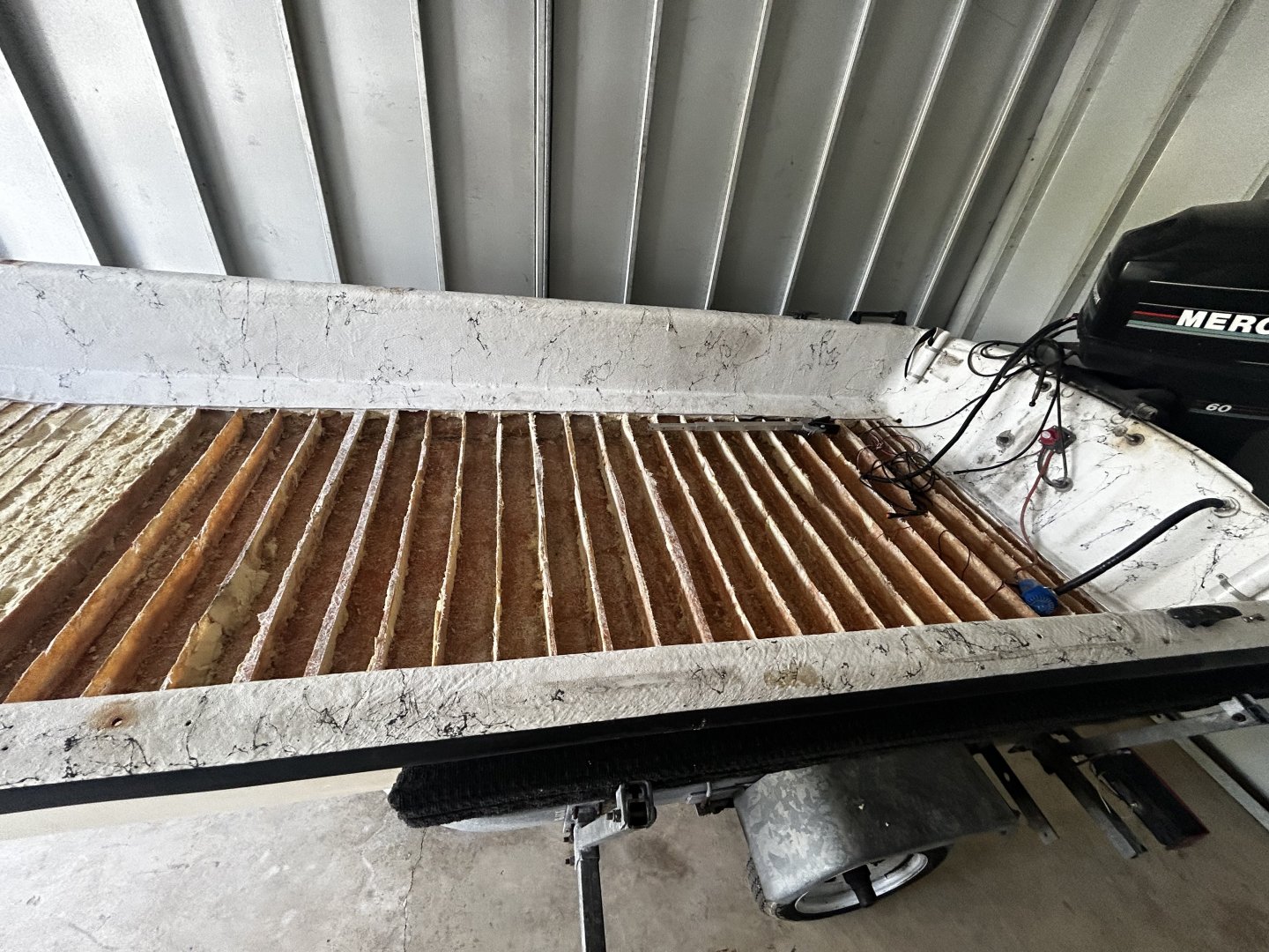

    IMG_4374.jpeg IMG_4402.jpeg IMG_4313.jpeg IMG_4402.jpeg IMG_4313.jpeg Hey guys! I don't post much as I love to read the good information (mostly) that you all put out there!
    here's the situation:
    I cut the floor deck out of my J16 because I suspected water in the foam- and boy am I glad I did. I removed 400 pounds of soaked foam (from the transom to about 3/4 of the way to the bow).
    ripped it all out- cleaned it- and decided to go back in with closed cell pour foam and it worked nicely!
    originally I thought I was going to go in with marine grade ply/coosa but now that I've test fit with a piece of standard ply- I'm not sure that's the move. I'm starting to think just glassing over the foam may make more sense . I also left about 1.5-2in of the old deck around the edges to give myself a flange/reference point to where the floor needs to be (also so the wood could lay on top of it)
    As far as the foam- I used a grinder and a planer to get it as even as I can (still have some high spots but can't seem to get it flat) . Is there a tried and true way to get it exact?
    how would I go about evening out the foam to make a good floor to epoxy/glass over?
    or
    could I go with a thin piece of marine ply and use the 1708 biax to create the stiffness?
    My concern with the wood is that it will not lay flat no matter what I try. So even if I try to PL loctite/epoxy it to the foam itself using cinder blocks as weight- it wont adhere right.
    keep in mind this is my first time ever doing something like this (minus the epoxy/glass) and I'm just doing my best but also want to do a good job. It's a duck boat so it doesn't have to be perfect either!

    Most pour foam is 2 pound density and not considered structural. So, first thing is to recognize your foam does not support the floor and will also crush under foot loads.
    In your photo, there is no way for us to see if there is any stringer or structural elements where you poured foam. Typically, a stringer or transverse frame or floor is where the plywood is meant to bond to…
    Getting the foam nicer is done by pouring into hole cuts after the sole is applied.
    Leaving even closed cell foam with grinds and cuts is not ideal.
    So, were there stringers?

    It is a good looking boat. Absent stringers, I’d be inclined to lay 12mm or 1/2” ply over the entire sole and bond it down on rough ground glass, not gelcoat. The bonding would be best done with epoxy with cabosil. I’d probably biscuit the edges over the foam to keep it monocoque or minimize movement on the seams.
    Then, I’d glass the bottom with a single layer of 1708 and tab the sides with two layers of 1708 tapes

    First time I've ever run into this - but it doesn't have stringers. It has a weird rib system

    You missed the opportunity.
    Either remove the foam and start over
    Or
    Don't worry about it.
    As is a sealed sole will last at least a decade before the foam needs to be replaced.
    Removing foam/laying the sole/refoaming. Will earn an extra year or two.
    There is not enough room between the ground foam and sole for a second pour to spread properly.
    I would:
    Use a straight edge (length ot 2x4) sliding along the flange to identify all high spots.
    Use 3/4 marine ply with three coats of epoxy on bottom and edges.
    Thickened epoxy with screws to the flange.
    Remove screws and fill enlarged holes with epoxy.
    Two coats of epoxy on top of sole ply.
    One layer of 1708 with epoxy.
    Paint and non-skid
    Enjoy for nine years
    Sell it for someone else to redo foam.

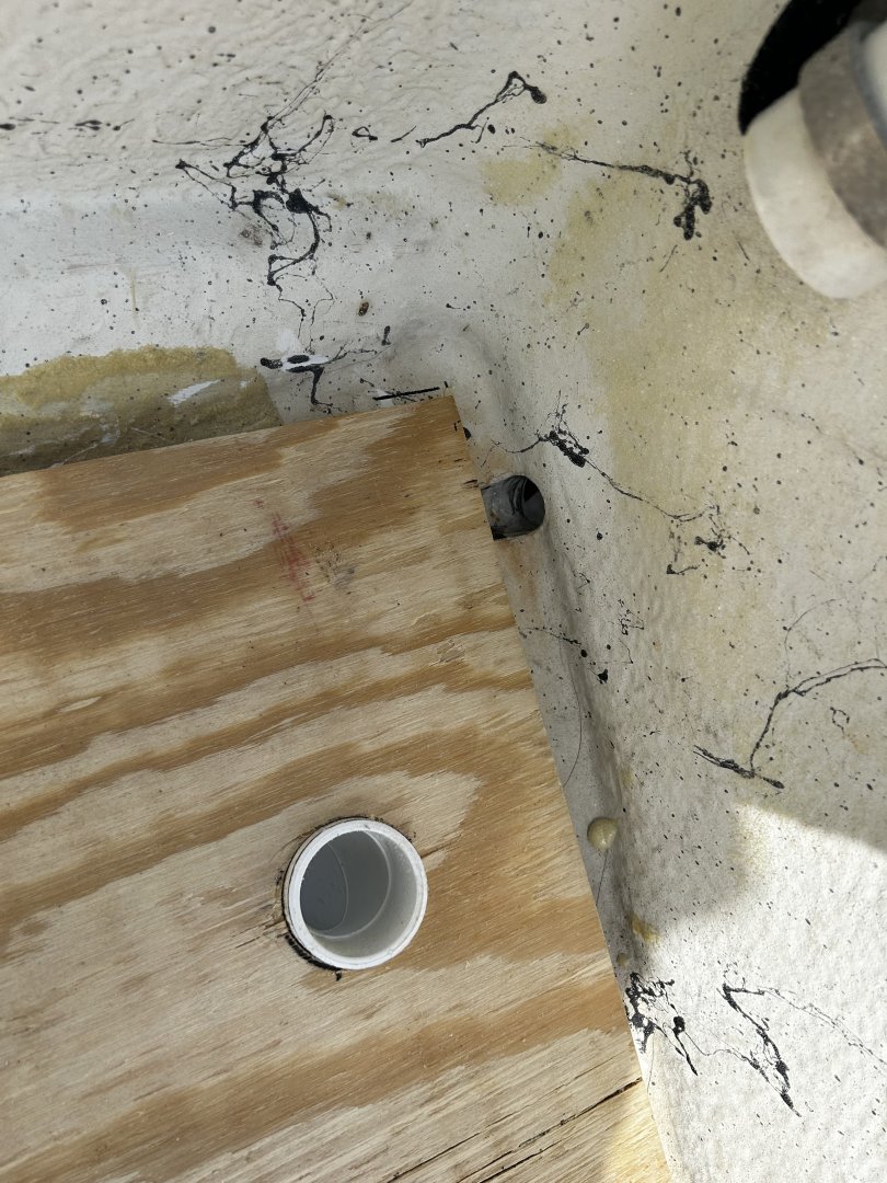

  11. CaptTator
    Joined: May 2024
    Posts: 17
    Likes: 4, Points: 3
    Location: Northeast (upper)
    CaptTator Junior Member
    Yeah, big mistake on my part. But- the good news is I learned from it!
    as far as plugging the 1in scupper holes-
    Can I get a dowel (soaked in epoxy of course) then fill it with thickened epoxy till flush , then glass over it?
    Instead of wood I actually have decided to change course to that 1/2in nidacell (I think that's how you spell it?, it's the honeycomb stuff) for weight reduction!
  12. CaptTator
    Joined: May 2024
    Posts: 17
    Likes: 4, Points: 3
    Here's a picture of what I'm talking about!
