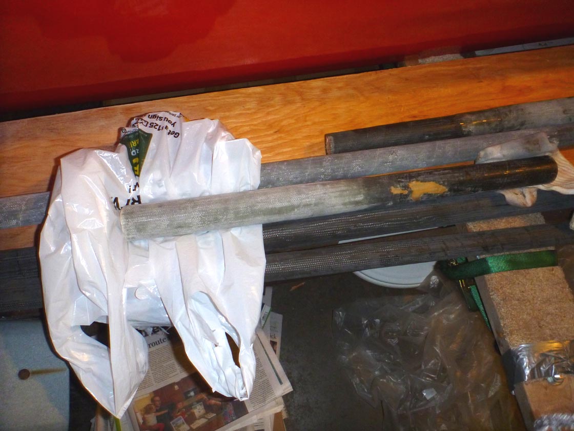

    Sure. Keep in mind, have refurbed a few boats, but the carbon and glass
    sleeves are novel to me and I have relied on wonderful advice and patience here from Par, Steve Clark, Epoxymoron, Major Tom, Lord Chris Ostland, Upchurch, Brian Eiland, Petros, Flados, Tom Speer and others which my beer soaked mind cannot dredge up at the moment.
    You can buy socks in glass or Carbon from a number of sources, I used Fibreglast for carbon and glass socks from Duckworks, sources putting up good help...which I need much of.
    The socks are like Chinese finger thingys, you push ends in and diameter widens, pull out, narrows...but not so easy to deal with without practice...
    BTW, I used zip-ties on ends to draw tight along length, and taped ends over peel ply using masking tape...the peel ply needs twisting too, so be certain to wear decent rubber gloves...
    So, the carbon stiffened the carbon surfer masts...base cracked, cut off and sock went over.
    Problem I had was novice...I lathered up mast after putting on copper water pipe to keep level...then began adding sock...PIA and time consuming.
    Second try I added sock and stretched tight then tied ends to keep in place, applied the epoxy and then wrapped with peel-ply tape I bought from Aircraft Spruce...more PIA as edges of the PP frays and need to keep cutting off...but, while I hate PP, you need it to be sure the sock stays in contact with carbon tube, especially at ends where glass tends to float off the tube...maybe better way, but it is what I did...FWIW.
    I am not sure how it worked out, as the alternate mast turned out perfect, though a hair rough looking, under sleeve...screw it.

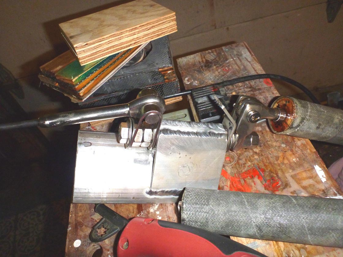

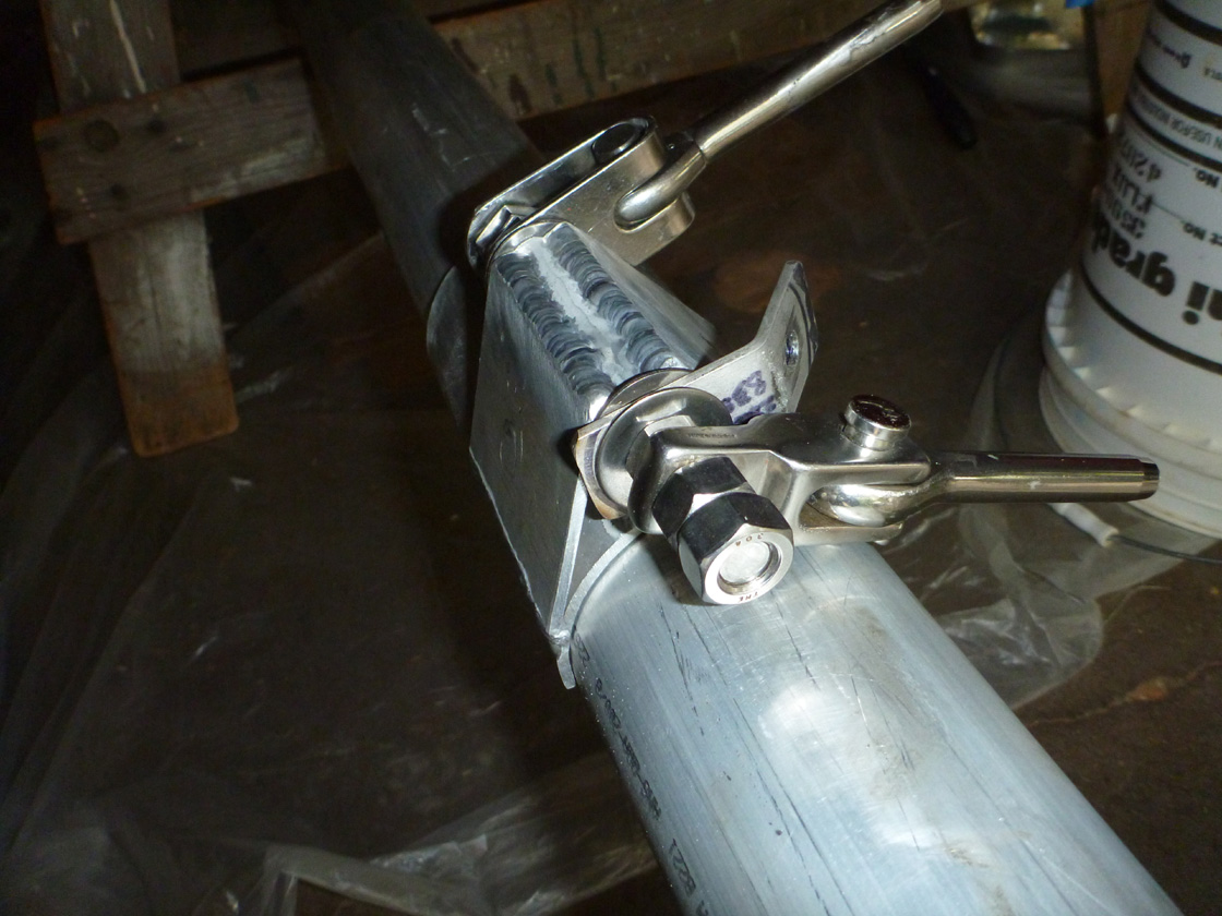

    Okay, second boat is based on Malibu Outrigger and has a long spar and 16' boom. I used a 10-foot piece of 6061 T6 AL 2-inch tube with .065 walls as I recall. Originally had .125 wall tubes (too heavy) the AL tubes join with carbon surfer masts I sleeved (carbon).
    I used a wood ferrule insert to join...had a fellow turn to dia I guessed at and added carbon sock and glass sock over that to insulate from carbon...but then the new tubes had greater ID, so I had to add three layers to dowels (old kiln dryed 2x4s epoxied together with glass and turned...
    Dowel ferrules fit the carbon spars but a bit large for the T6, so I have to sand a bit and fit...have not done it...raining here and dealing with other stuff on boat...
    I figure to keep the carbon/T6 section separate and join when using...pinning with monel nails, screws or something...not worked it out completely.
    BTW, the base of the spar and the boom at gooseneck also have these dowel inserts with SS tubes to slide on to goose neck..., and glass sock to keep carbon from T6 AL.
    I used to craft glass fishing rods and figure the ferrules as same but bigger. Carbon is very tough stuff...I hope, and if I did the socks right...

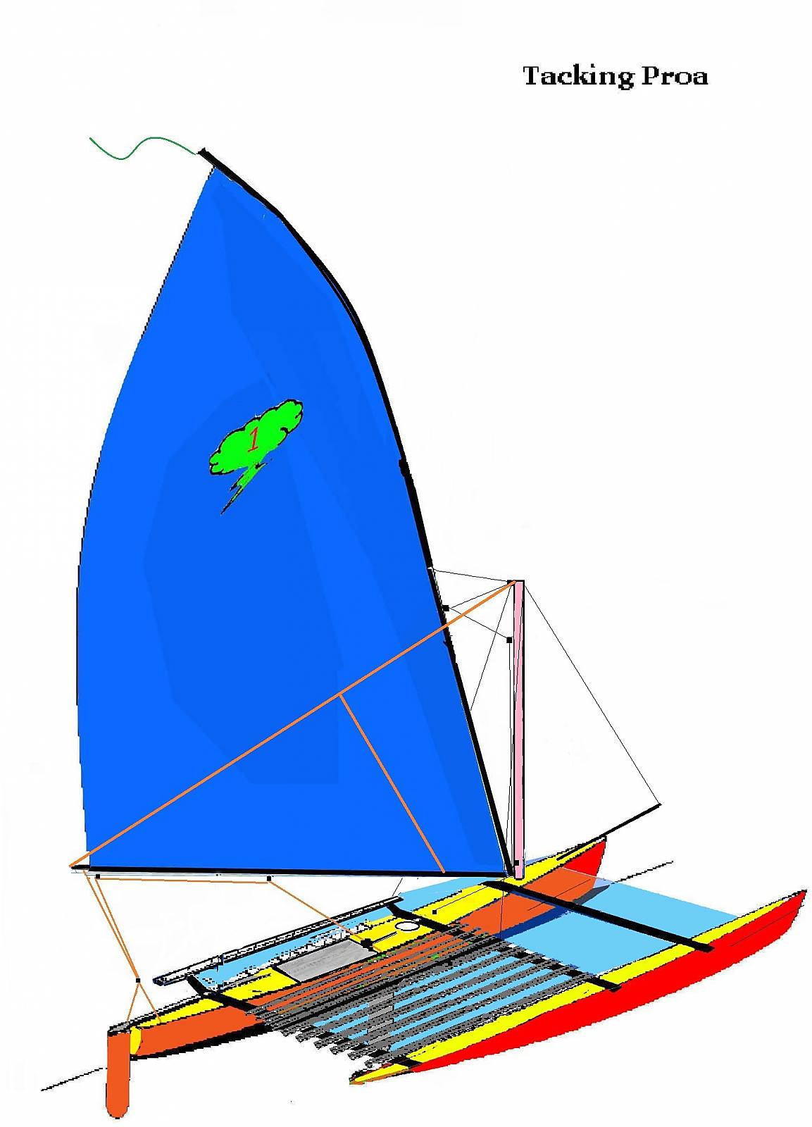

    Pic is planned/design...will put up some more later.

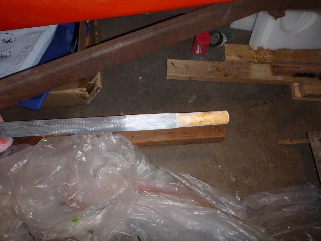

    Carbon Surfer masts to Aluminum Ferrules
    I must have trashed a couple pics cause I cannot find them now, but you never know...I have three cameras...
    Here are a couple pics that should help...
