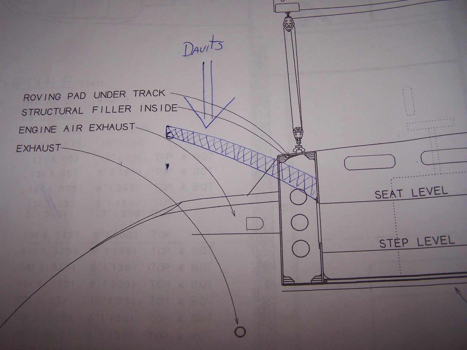

    Nice design but, how is the davit and how it is attached to the hull ?. What is the configuration that you want to calculate ?. Will you attache it to the deck or ...?. How is the deck/beam/transom at this area?
  7. svquintana
    Joined: Mar 2012
    Posts: 30
    Likes: 2, Points: 8, Legacy Rep: 10
    Location: PEI Canada
    svquintana Junior Member
    The davit installation is covered in Post #9
    It is not yet finalized, but I'm pretty sure it'll be very close to what's described there.
    Cheers.
    Paul.

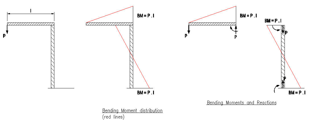

    That's ok, thanks for your consideration. My original reason for starting this thread was to understand which parts of a beam carry the load; vertical or horizontal. And, perhaps, with luck, discover if my intended layup was thick enough to carry the load.
    Cheers.
    Paul.
  10. TANSL
    Joined: Sep 2011
    Posts: 6,738
    Likes: 492, Points: 93, Legacy Rep: 300
    Location: Spain
    TANSL Senior Member
    Perhaps the following scheme, very simplistic, help you see the most critical areas of a traditional davit.
  11. svquintana
    Joined: Mar 2012
    Posts: 30
    Thanks for that, but I'd need more formal training than I have, to fully understand that sequence of photos.
    I drew the davits on a plan sheet, Ignore what looks like a large 45 degree gusset at the bottom of the davits. Although I plan on putting gussets on the aft bulkhead, it wouldn't be nearly as large as what's shown. That line actually represents a part of the original cockpit coaming, which is far outboard of the area where the Davits will be located.
    Cheers.

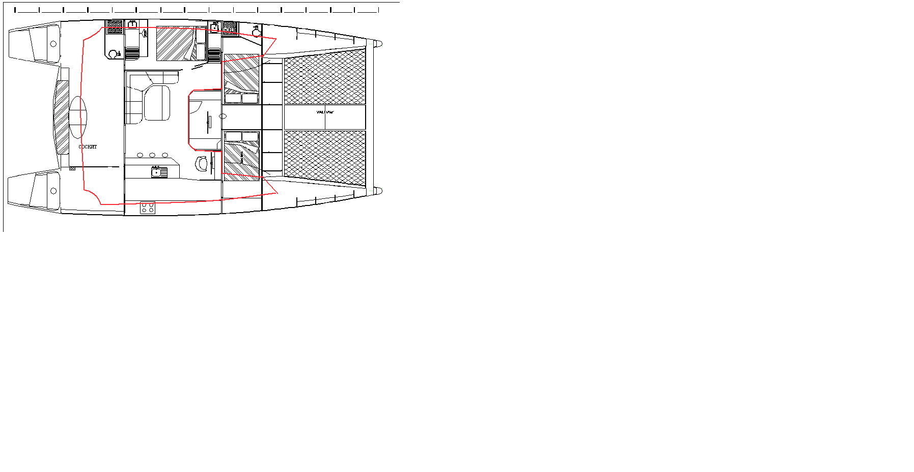

  14. Moewaka
    Joined: Jun 2016
    Posts: 8
    Location: Christchurch, NZ
    Moewaka Junior Member
    Hi Paul, yes the turret is the roof. Im not building yet but have been playing around with the Waller 1480. I've had advice from the designer and so Im trying to do what I want within existing bulkhead positions etc. This is what I have so far. I should note that Im not making any changes below the waterline.
    http://www.boatdesign.net/forums/attachment.php?attachmentid=108692&stc=1&d=1468160744
    http://www.boatdesign.net/forums/attachment.php?attachmentid=108693&stc=1&d=1468161048
    The red line is the turret shape which has wings that taper down to the bridgedeck forward, so cant simply be moved back. Also one of the big areas of concern for the designer was keeping enough weight in the front half of the boat to keep it balanced as he intended.
    The galley to starboard and the stateroom to port are only one step down from the bridgedeck keeping all the living space for one couple pretty much on the same level.
    The wings that extend past the front cockpit will offer some protection from rough weather but I quite like the 'windscreen' in you 2nd photo so I'll have a look to see if I can adopt it in front of the mast without getting in the way the jib sheets etc.
    I'd be interested to see photos of you build.
    Cheers
    John
