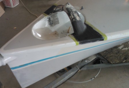

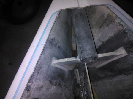

    BB, this is how I attached a prod for my dinghy a couple of years ago. This one is designed to retract into a void under the fore deck. Here are some photos of how the sleeve was supported. You will see that the sleeve is open at each end and otherwise sealed into the deck to avoid leaks. It has survived a 25 knot squall with the kite up, which is more than can be said for the driver :rolleyes:
    You could make your sprit removable by glassing in a blind sleeve that allows you to plug it in and tie or pin it into place while rigging. The same approach would work for a permanent sprit, you would just need to seal the end. Feel free to let me know if you would like any further details on this approach.
