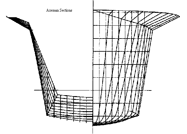

    Interestingly, in the early days of the Moth there was a question just like yours. Ian Ward, a pioneer of Moth design, told me that the faster hull for sailing was a narrow square hull because it produced less wavemaking resistance.

    Sailing speeds are higher and I can see a benefit of a flat hull to get up on plane and hold an edge. However, canoes travel slower and are submerged typically about 20-40% (varies based on loading). The resistance also varies depending on the shape of the hull at different drafts. For this case though the sides of the boat are perpendicular to the deck so you have a single chine/square channel passing through the water. There is extra surface area to be sure.

    Hi Doug H., in this case the beam for both boats is the same. In fact, the top view is identical for both. I don't want to modify the beam of the square hull to be narrower. I know this might help even things out. Assuming both boats met the criteria above (identical top & side profiles) and were equally and loaded (e.g. two paddlers) a rounded hull should be faster. Doug Lord's sketch above is a closer comparison to what I'm talking about (round vs. square hull).
    If you or anybody has numbers to prove otherwise do show your calculations. Perhaps there is a reference to this in a hydrodynamic book some place.
