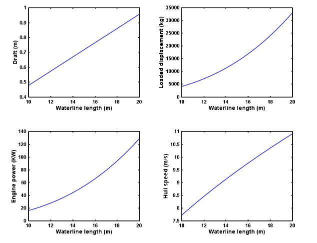

    I've been kicking around the idea of using solar power to drive a catamaran, and I'm interested in more of a coastal cruiser that would sail a few hours a day, and not something that would be a blue ocean yacht. I started with Terho Halme's Catamaran Design Formulas (http://www.catamaransite.com/catamaran_hull_design_formulas.html

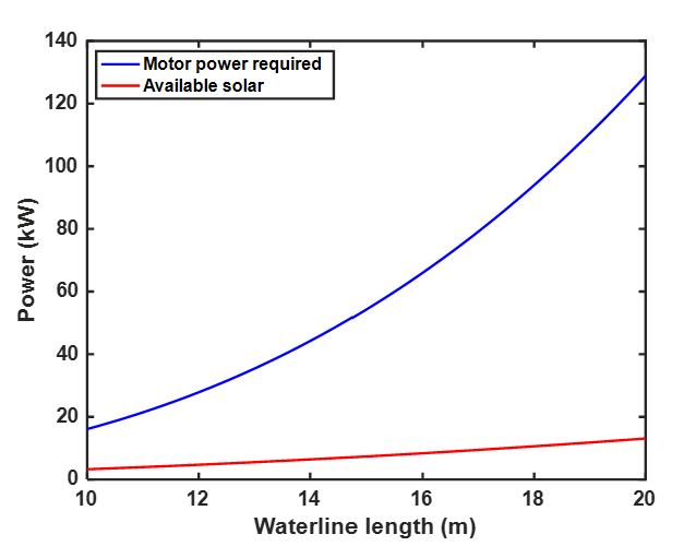

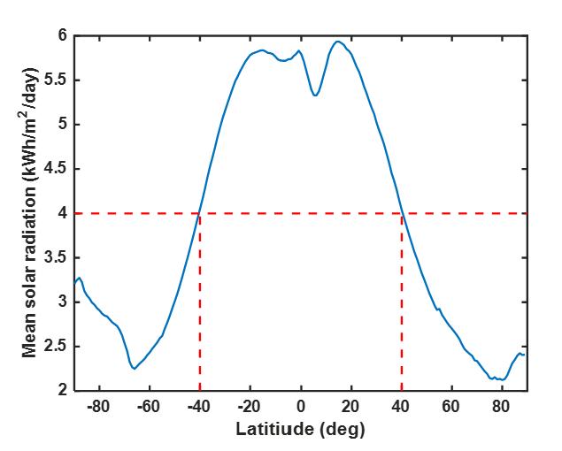

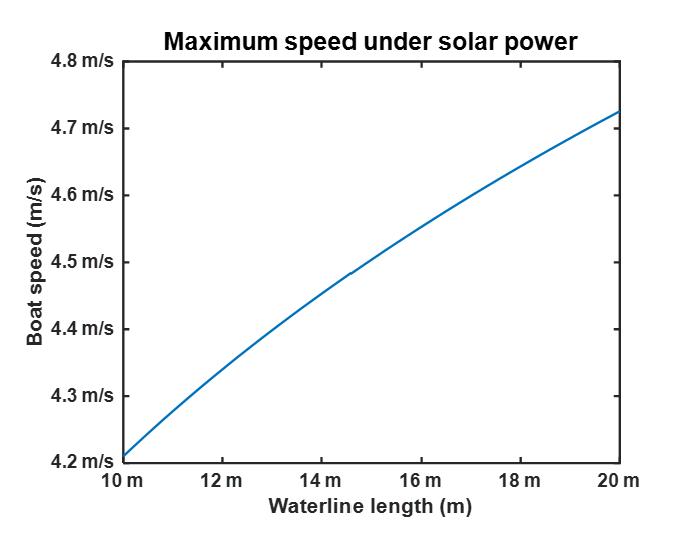

    ) and got some basic parameters - draft, displacement, engine power and hull speed. I made some assumptions about the amount of available solar energy from a NASA website (https://eosweb.larc.nasa.gov/sse/global/text/global_radiation) which gives average daily solar radiation by latitude. From this, I got that you might be able to expect about 4 kWh/m^2/day, and if you assume about 15% conversion efficiency then you get about 600 Wh/m^2/day. I knocked off another 20% for other losses to get 480 Wh. Then I plotted the power required from Terho Halme's equations against the available solar power, assuming I could cover 60% of the LWL x beam area. Not a chance. The required power is way above the available solar energy. But then I thought, power goes up approximately with the cube of velocity, so how fast could you go even if you aren't at hull speed? It turns out that for the boat lengths I calculated, it's pretty consistent at ~4.5 m/s (10 mph). If you didn't mind a kind of lazy day on the water, maybe that wouldn't be so bad. Obviously, I'm ignoring all kinds of things here like cost, weight, batteries and getting home before dark, but I thought I'd throw this out for discussion.

    For a 40' (12 m) boat, you need 28 kW to maintain hull speed which I agree is out of reach for solar power. At that length, the width is 5.5 m and I assumed 60% of the total area would be covered by solar panels, or about 40 m^2. You can actually get at least 4 kWh/m^2 per day between +/- latitude 40 deg, and in many places quite a bit more. That's enough to get 4.3 m/s or 9.5 mph. I forgot to say in the initial post that I assumed 5 hours a day of motoring, so you'd get ~50 miles per day if it was sunny.
    Yeah, I've completely ignored batteries, so that's something to look into. The batteries would smooth out variances due to scattered clouds. I've been assuming that if there's no sun, you stay home.

    Not you can actually get about 1kw/m^2/day not 4.
    The theoretical maximum amount of power available in 1m^2 at noon on the equator is 1kw. Solar panels run about 20% efficient. So a realistic 'best case' is about 200w/hour, over a six hour production day works out to a max of 1.2kw. But then you have to take into account the frame size, mounting efficencies, and any shading.
    So your 40m^2 will realistically produce about 40kwh/day. If you ran during day light and used the power as you produced it that's about 6.5kw/kr. Or probably 2-3kn at best. So figure a days run in the 18nm range.
