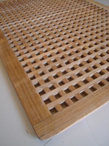

    I think i'm going to go with a 15hp on a bracket on the Duckboard. If we have any issues with the outboard or bracket assembly i will raft together (although the freeboard issue is a consideration as there is probably 1-1.5 ft in difference) and motor both back side by side. Failing that i'll have a tow option up my sleeve also. I;ve changed the place where i am bringing it out so I now have a less busy waterway and a track of 10.6 miles or 17km to travel so i'm a little more confident in this arrangement.
    I've attached a rough sketch(Clearly i'm no architect, but this is easy enough) of what i'm proposing to make for the outboard bracket using 40mm thick lengths of treated timber and some solid coach bolts and then a series of several holes drilled through the base plate to feed bolts through the duckboard webs (Similar to the picture attached). I plan on putting roughly 8-10 bolts through the duckboard to line up with the existing holes/webs and then either a solid plate or smaller positional plates underneath the duckboard which catch the bolt head and essentially "clamp" the duckboard in 8-10 places (to distribute weight and flex). At 15hp and in a fairly calm sea its going to be a reasonably slow trip with the fizz boat following. This drawing is a bit rudimentary but i'll butt the horizontal and vertical join and probably also dowel it with 12mm coach bolts vertically for additional strength.
    Does this seem a reasonably sound plan before i dash off and wind up with both boats on the bottom of the Hauraki Gulf?
    I found out yesterday that the previous owner has basically been squatting on someone else's mooring as theirs broke quite some time ago. So the harbor master has "gently" asked me to get it moved. Watch this space, but any advice or improvements to design are greatly appreciated.
