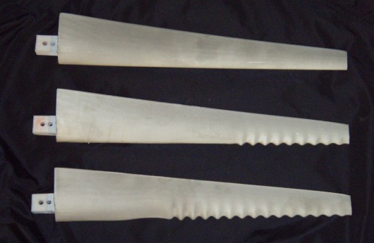

    As Petros mentioned earlier, smoothing the blades can be helpful. Folks with wind generators also have a desire to quiet the blades of their 'fans'. Here is a brief discussion where some success was had by sanding the rough casting edges of the blades with 400 or 600 grit sandpaper, and then waxing or varnishing them.
    http://janice142.com/BoatInfo/QuietWind.htm

    SamSam, in fact this seemingly trivial problem has quite a lot to do with flow phenomena studied for sails, hulls and propulsors. So, Squiddly-D; do some Googling on "owl silent flight".
    The major noise source is the trailing edge; you might try to mimick an owl wings soft, serrated trailing edge by adding a strip of tape or textile with V-serrations, say about ten millimeters "free overhang".
    The owl wing also has a velvet-like surface on the aft part of the sucion surface, that has a smoothing action. I've seen lab tests with fibers glued to a pipe inner wall and acting as damper on the turbulent flow. It is even possible to change a turbulent flow into a laminar at the trailing edge.
