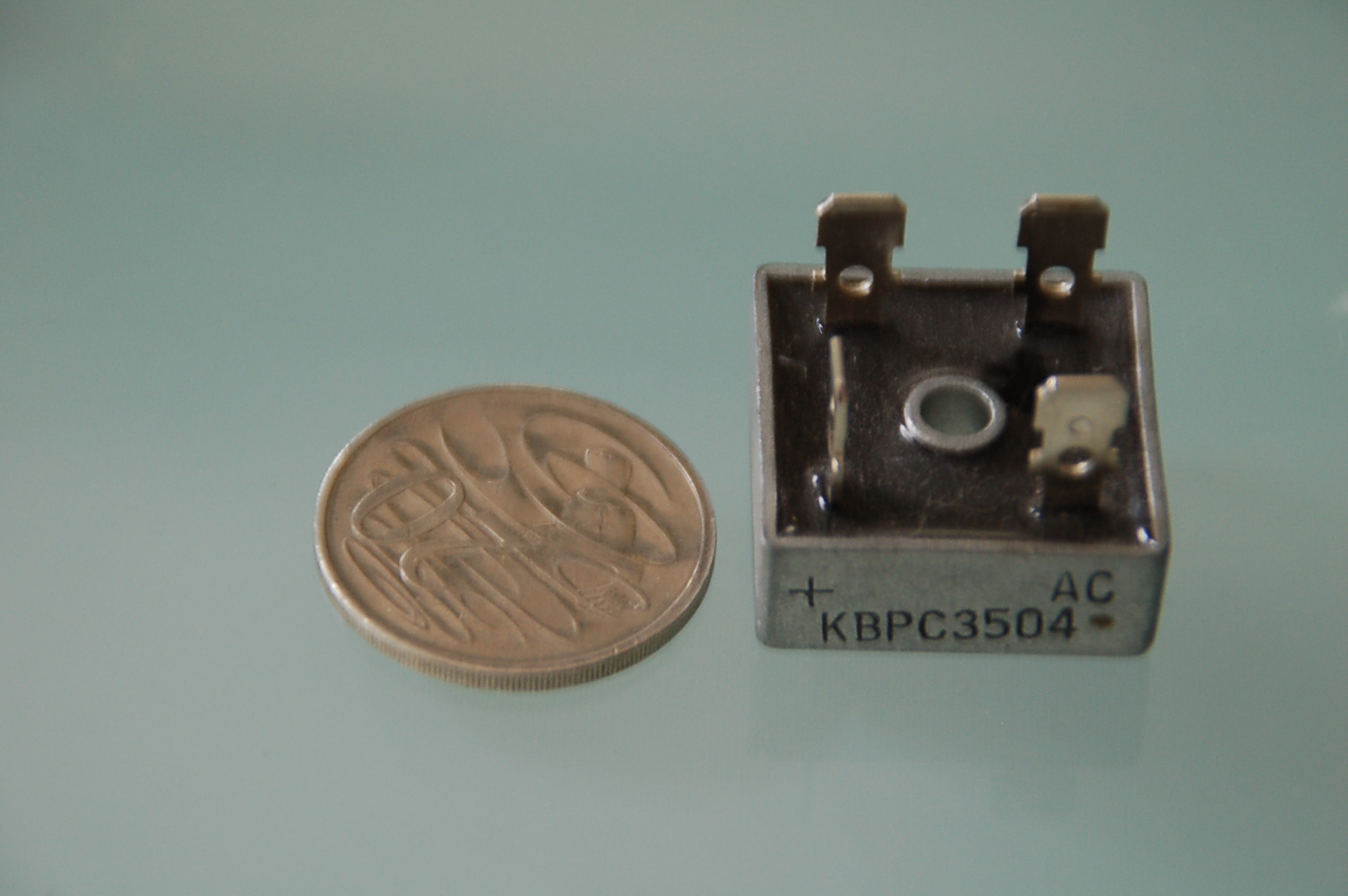

    I have an older 8hp Tohatsu 2 stroke. Not sure on the year model. Is there any thing I can hook up to get it to charge a 12V battery?

    I'm not sure about your particular engine.... a few small rope-start outboards have a small coil in there to give a couple of amps for nav lights. If yours has one, there'll probably be a reference in the owner's manual to a "lighting coil" or similar. But on a non-electric-start engine, I've never seen one that's powerful enough to charge a battery; they're usually just meant to power a nav light.

    dennis high again ....if its got a 12v lighting coil ( not 6v) then all you need is a bridge rectifier from dick smith ....few dollars ...two wires in and two out to the battery job done

    comment above does not make sense ..smaller motors often have a lighting coil which remains unused ..if thats your case dennis put a 12v 10w bulb on it and see if it glows full brightness ..if it does its 12v
    On the bridge rectifier the lighting coil goes to the ac inputs and the battery to the + and -.......get a big one then heat sinking it will not be neccessary..this one is rated at 35 A way over spec + is front left - is back right ac is the other two

    Cheers guys. I have a few big bridge rectifiers laying around which I can use. I will have to check the motor when I go to the boat next to see if I can locate a lighting coil.

    Hey, I like the platypus artwork on the 20 cent piece.
    The previous question I meant: Would the motor have a lighting coil if it didn't have a light? Sorry for any misunderstanding.
