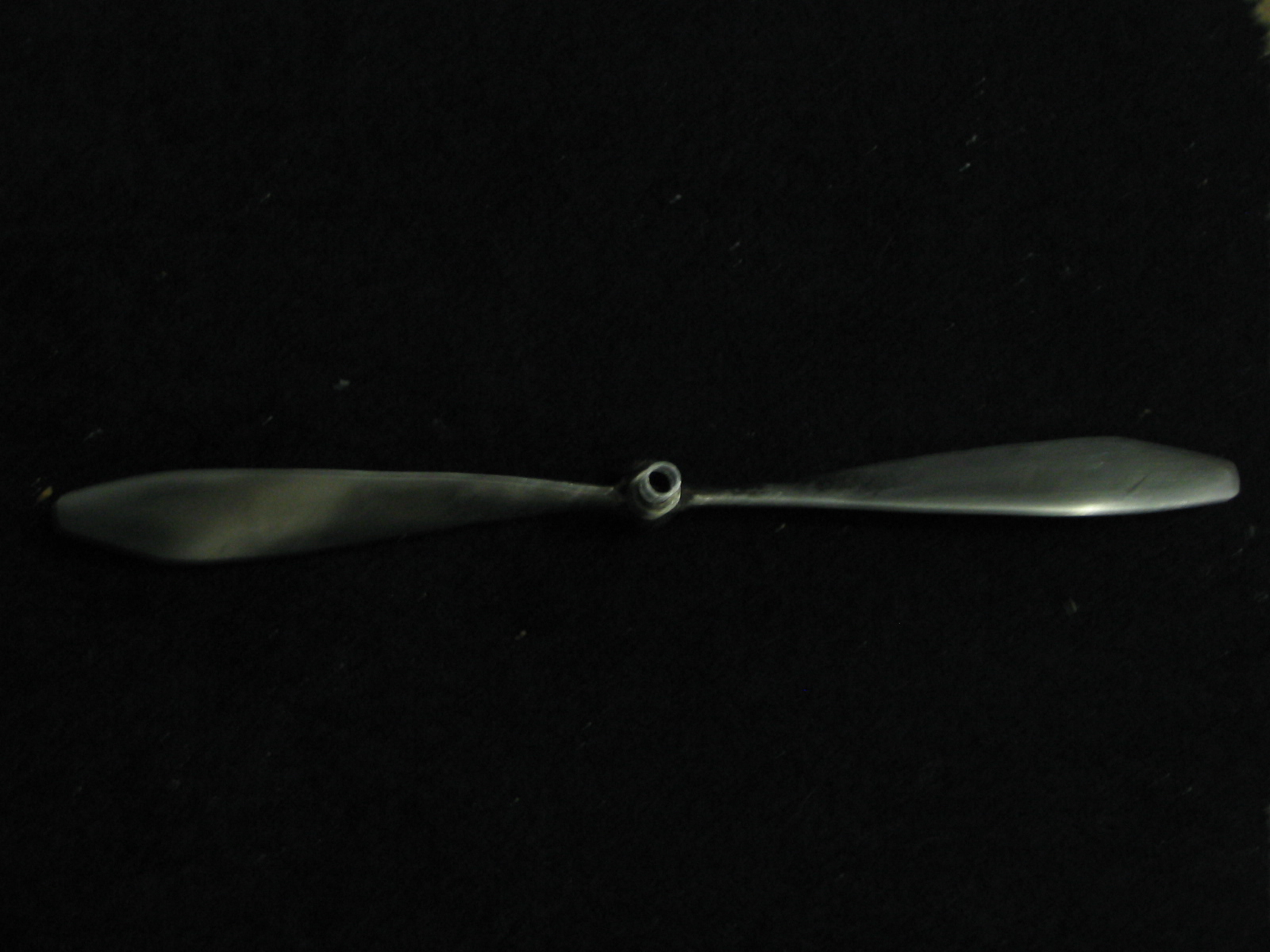

    The flat shape refers to the chord. It is one of the options available in JavaProp. You have misread my post. What I said is that you would lose about 10% going to a flat plate. You can try it yourself as it is the default profile in JavaProp. The flat plate is either very thin or has a rounded nose and tapered tail.
    Even a flat plate will fly it just has a narrow operating range.
    The steel flatbar props I make have about 2 hours of hand grinding to profile them:
    http://boatdesign.net/forums/attachment.php?attachmentid=23371&d=1215983491
    Rick W

    Thanks Rick, I think I understand what you mean. Sounds a lot like the flat X-sect blades that were used in the earliest propeller designs. I notice that the helicoidal blade twist is featured in the example that you attached. It has occurred to me that cancellation of the torque reaction with a single stator will, under the best of circumstances, be very much like walking a tightrope! :idea: Even though two contra-rotating props will be a pain to set up at this small size, I'm beginning to think that this may be the most viable solution after all! The designers of full sized torpedoes knew what they were doing. I know that the aft prop has to have an slightly smaller diameter, opposite hand and have a higher pitch than the fwd prop. :?: Is there a rule of thumb relating the aft to forward prop pitch? The torpedo would have the aft prop set just behind the forward one. I have the specs for a system used on the USS Albacore. In her case, the spacing between propellers was about half the forward prop diameter. The aft propeller pitch was approximately 1.2 x the fwd propeller pitch.:D
