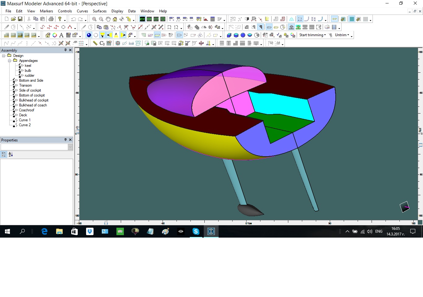

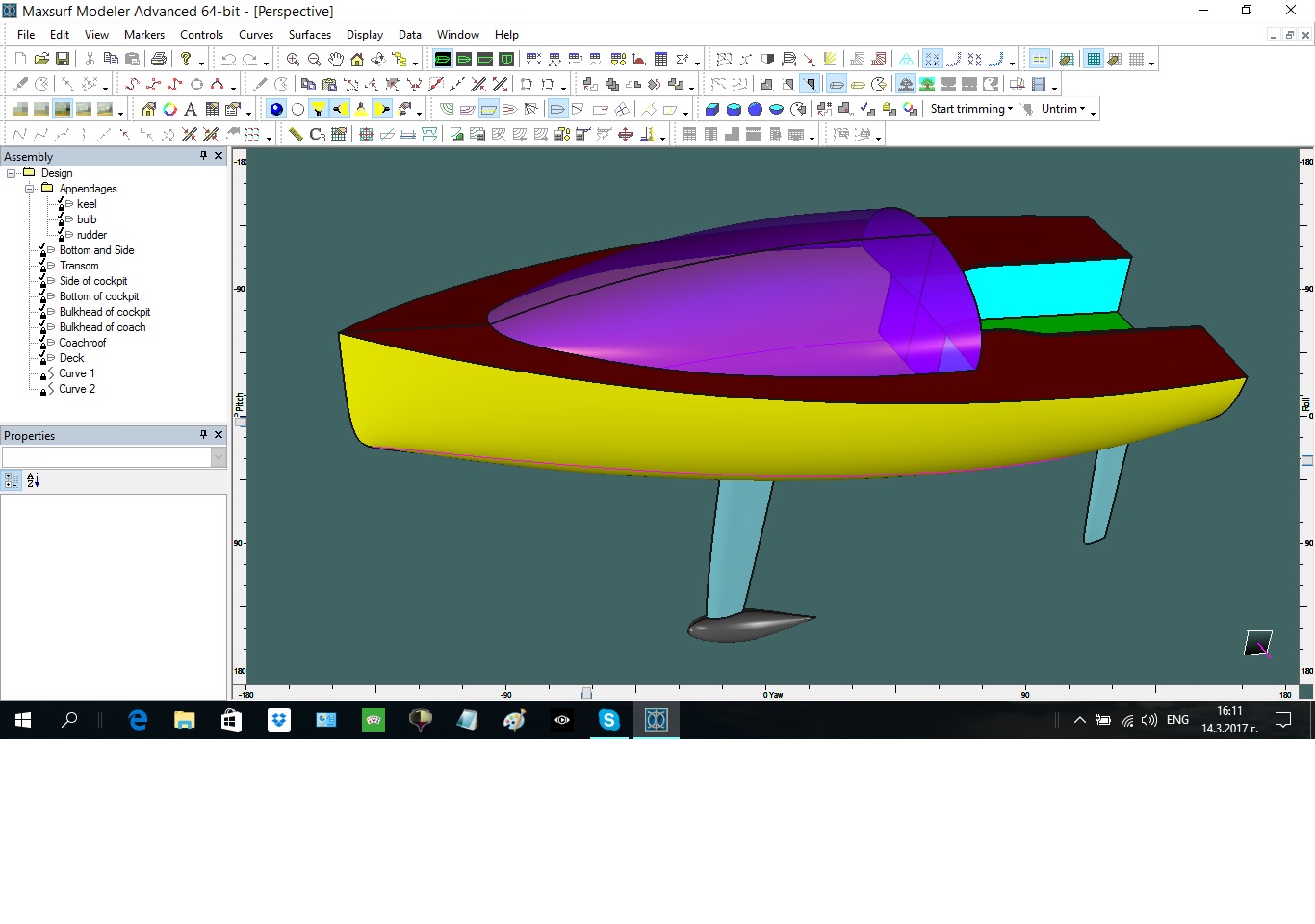

    Calculation of the stability of a sailing yacht by ISO 12217-2 with the program Maxsurf Stability Enterprise v.20
    Introduction
    We look through model of a plastic sailing yacht with one mast and centerboard in CL, with the following principal dimensions and characteristics:
    Maximum length of the hull Lmax = 6,3 m
    Maximum beam of the hull Bmax = 2,456 m
    Maximum depth in the bow Hmax = 1,188 m
    Amidships depth Hmiddle = 1,084 m
    Depth on the transom Htransom = 1,045 m
    Draft in fresh water T = 0,3 m
    Full Displacement in fresh water D = 1219 kg
    Crew 4 persons
    Navigation area for class "C" - internal waterways and coastal marine floating at designed speed of the wind 17 m/s (up to 6 balls on Beaufort), height of the design wave - 2 m
    Sails - mainsail and staysail
    Declination of the raked stem from the vertical - 15 deg
    Design of the present model was made of young engineer Alexander Ermolenko from city Kiev - Ukraine. From me only some particulars - the view /rake/of the stem, check and flattening the curvature of the water-lines in the fore, adding the bulbkeel and ruder blade and the present calculation of the stability.
    The publication is made by the A.Ermolenko's consent.

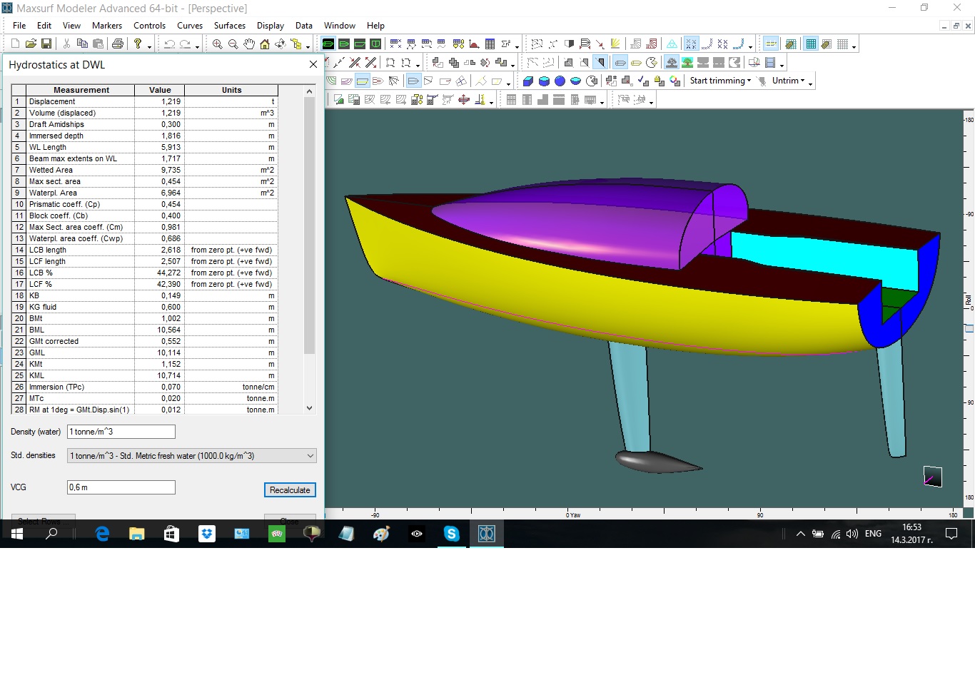

    |. All over again it is necessary to update what cases of load it is necessary to look according to requests of ISO 12217-2.
    1. The first and most important case of load this is the Full displacement of the yacht in operating conditions. It will consist of the weight "Light craft" plus deadweight /weights of the crew, the store, the fresh water and the reserve of fuel for the suspended motor /.
    We still do not have data for "Light craft". Precise value will be received at „ Experimental definition of the weight and CG of the Light craft”. For this purpose it is selectable the draft and the displacement relevant to it on prototypes data.
    For CG of full displacement the reasoning is the following:
    As overall dimensions of the yacht and the geometric shape are already fixed /on the ground of some prototypes / then at already adopted draft we can receive LCB of the computer model. That the vessel was maintained on an even keel it is necessary LCB = LCG. As it is possible to achieve it is by means of different versions of the location of the mast with sails, the bulbkeel and the crew. At designing usually receive all crew it is arranged in the cockpit, less often two persons in the cabin and two in the cockpit or three in the cabin and one steering in the cockpit. So that it is possible to influence on the trim on the axis "X" most likely only by means of successful arrangement of the mast and the centerboard or dry ballast under the bottom ceiling.
    On height we receive CG of full displacement on 60% of an amidships depth.
    At full displacement it is received that the centerboard is in the lower position.

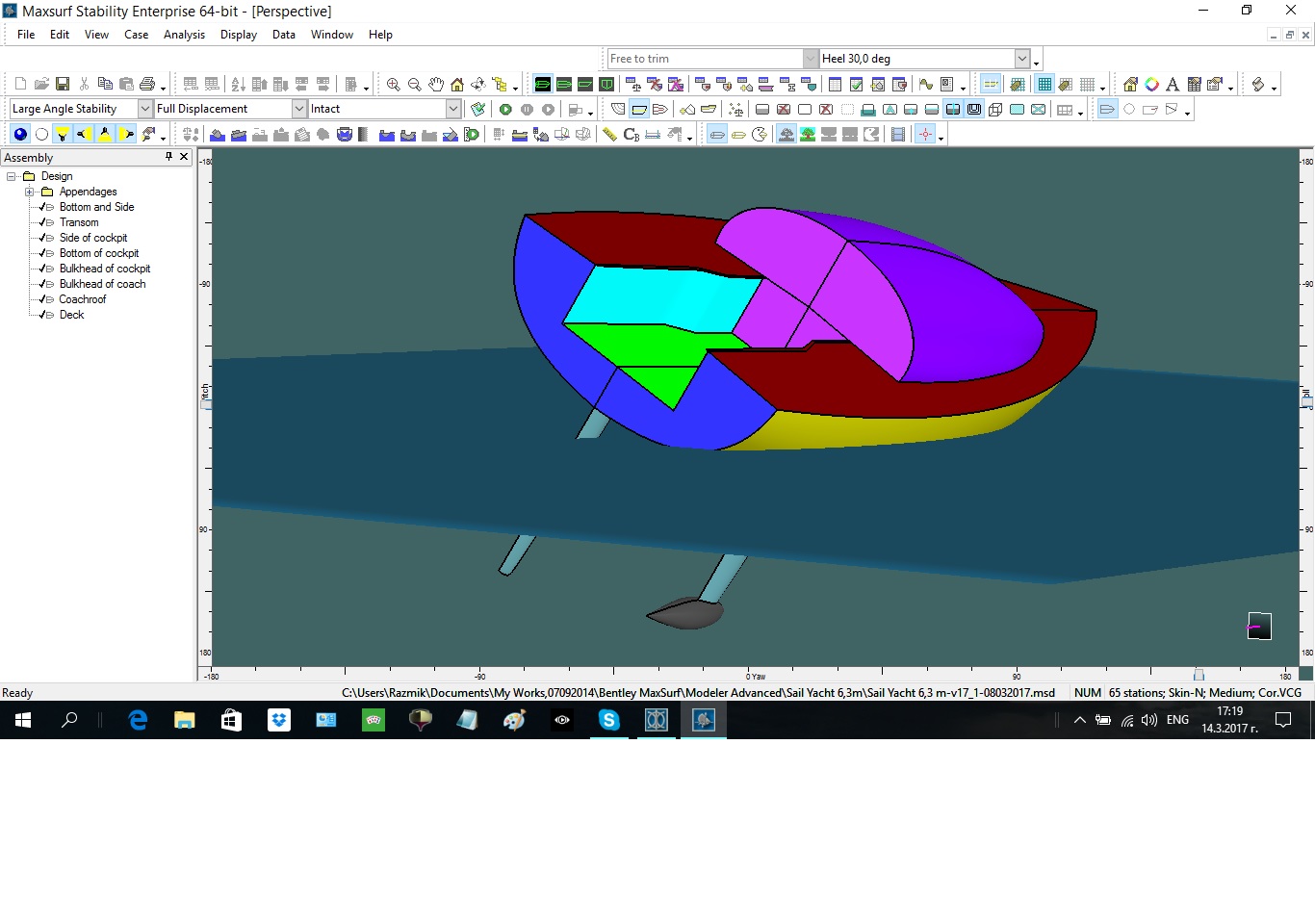

    ||. Improvement of the critical points of downflooding.
    The cut-out for an entrance in the cabin should have coaming in lower edge agrees ISO apart > 0,2 m from the floor of the cockpit.
    To stability criteria it agrees ISO 12217-2 specified in Maxsurf Stability are satisfied if this coaming will defend a minimum on 0,456m > 0,2m from the floor or 0,652 + 0,456 = 1,108 m from BL where 0,652 m it is height of the floor of cockpit from BL on 2 m from the transom.
    At breadth of the cut-out 600mm, critical points of downflooding have the following coordinates:
    X=2,0m Y = (+/-) 0,3m Z=1,108m

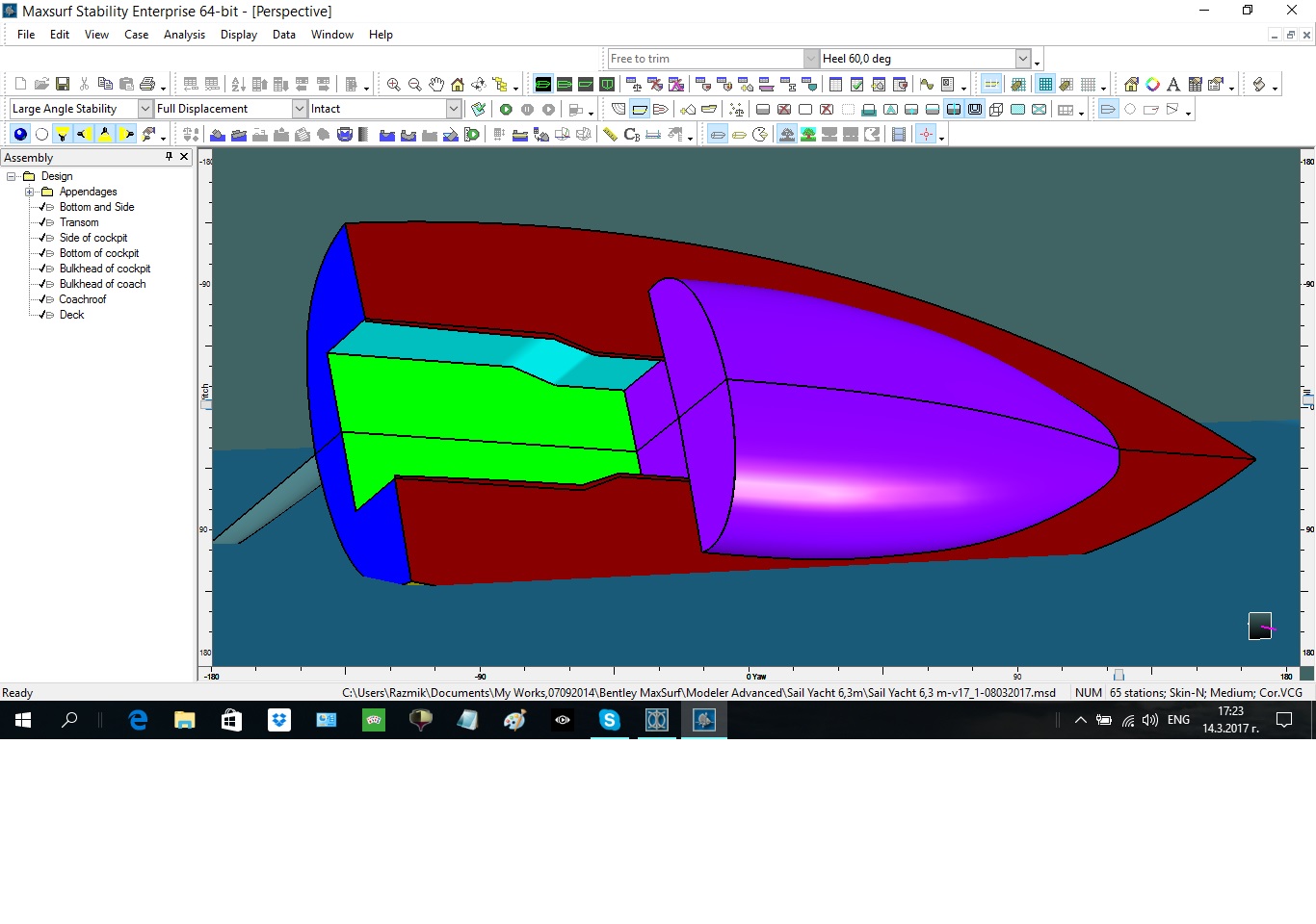

    |||. Input data in the tables of the criteria
    In Maxsurf Stability six different kinds of criteria on ISO 12217-2 are specified. First five of them concern to the case of load “Full Displacement”, and the sixth “Wind Stiffness test” concerns to the case of load “Minimum operating mass”.
    From five criteria concerning to “Full Displacement” only criterion "STIX" on p.6.4 from ISO requires explanation what data is necessary to introduce in the table of criterion /see the attached file / .
    Data for the Silhouette at Full displacement are received by program Delftship Professional /see the attached file /.
    First from five criteria - “Downflooding height at equilibrium”/p.6.2.2 by ISO/, is more special case.
    After input in the table of criterion of the Minimal freeboard - 0,37m on requests ISO, the outcome for the real freeboard - 0,808m /on levels of the downflooding point/ at Full displacement is received by means of Start Analysis /Equilibrium/ or Batch Analysis /Large Angle Stability/, at elimination of all remaining criteria.
    The sixth criterion “Minimum operating test” requires explanation for input precise value "A" in the table of criterion.
