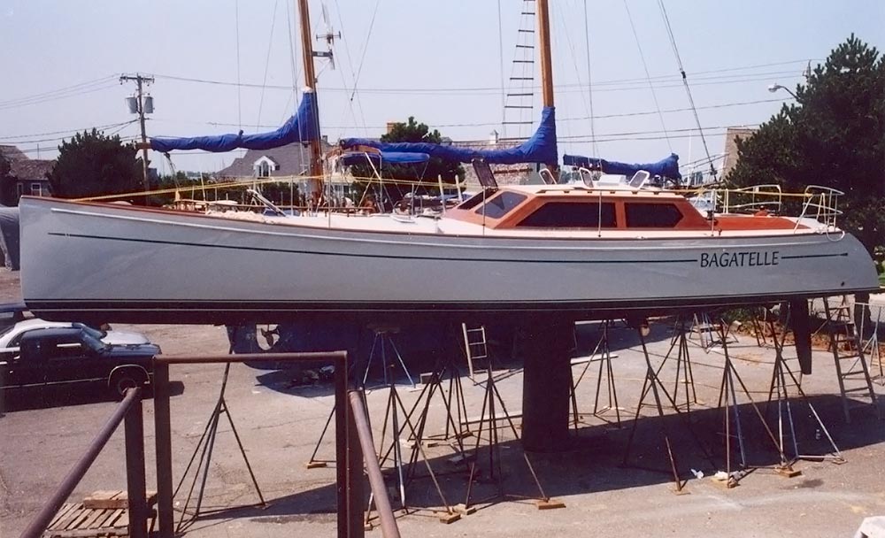

    Yes, for the guy who designed this;
    to be so disparaging about the appearance of this;
    is rather odd. They have similar stems and similar long foredecks and visual sheers, and both have quite tall coachroofs stuck well aft.

    Is that the Bagatelle E Sponberg designed? Which if it is, its much wider than 8'. Difficult to make any boat with standing hdrm look low and sleek fit into a shipping container and btw, Perry did a great job considering the constraints

    Not so much wider B 10-6½”, a mere 2.5 feet
    Bagatelle https://www.ericwsponberg.com/boat-designs/bagatelle/

    That extra 2.5' makes a humongous difference in the sense of spaciousness as well as working out comfortable ergodynamics, one of many reasons I think Perry did an excellent job besides, Bagatelle to wide for container.
    Quite sad idea never took off. FF is on point, going with a powerboat would be way more advantageous
