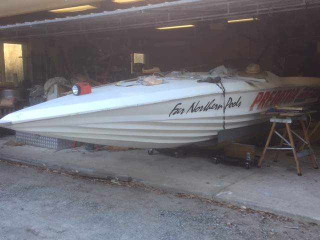

    Hi was reading your post after trying to search prop calculator for surface drives

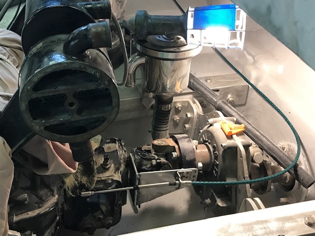

    For whats worth I have just bolted in Z-drive using Hallcraft/or Casale these come in parallel drive /Z-drive configuration
    Im running Arneson surface drive ASD6 then Z-drive which lifts the 1410 universal up 4" height then to Crash gearbox (F/N/R) and then to 502 ci Chev
    the boat is 21.5 ft ski boat
    Should be in water within 6 months, most of heavy engineering has been done, just have to tidy up outside of hull, and start fitting out boat with parts
    This was non factory boat, so everything is new
    Boat used to have a large outboard on back
    will try and post some pics of the Z-drive shortly

    actually boat has similar fine bow, and stakes to levi design
    Someone had passed a comment that the boat could of been shortened to 21.5', but who knows?
    Been trying to track down he built the FRP boat in Australia but given up
    just want to finish it

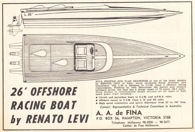

    There used to be a contact here some years ago that was contact for Levi designed boats as saw advert showing 26' with staggered twin engine setup (advert attached)
    managed to find pic showing Z-drive connection between gearbox and ASD6,

    its a pity there is no manufacturing ID tag on the boat that Im rebuilding, as had to rebuild stringers and transom
    haven't put the boat in water yet, so not sure how its going to sit, although front of BBC is 1.3m from transom and overall length is 6.1m
    When I moved boat onto trailer managed to get the the boat rocking on sling so was able to determine where the centre of gravity was.
    Was going to fabricate 2 saddle tanks up and try and carry 100 litres fuel each side, but concerned where these will be positioned to balance out boat
    So you advising the 26' boat in advert is Delta design?
    cheers
