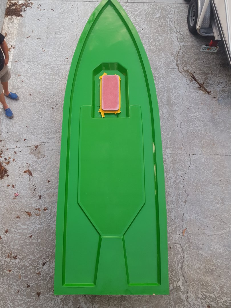

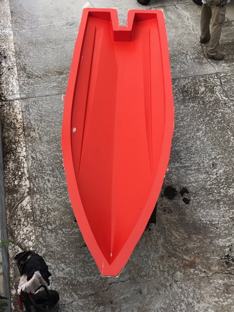

    It's actually a flats boat/paddleboard hybrid. 15' long and 5' wide at the widest. We don't have a sketch, I can draw something up if it would be helpful. These are images of the top and bottom molds.

    Re how you have built hull and deck moulds, this is a lot of work (and they look like nice moulds) - are you planning on building more than one boat from these moulds?
    Calculating the buoyancy will be a bit more difficult compared to a more rectangular flats boat like what Aransas Rat is building, but not too difficult.
    Probably the easiest way would be to mark on the hull mould the different drafts for which you want to calculate the buoyancy / displacement.
    Level the hull mould such that it is trimming typically how the finished boat will be trimming.
    Then start to fill up the mould with water until you reach the mark for the first draft mark.
    If pouring from a known container size, then you can calculate how many gallons of water have gone into the mould.
    One US gallon weighs 8.34 lbs according to Wiki -
    Gallon - Wikipedia https://en.wikipedia.org/wiki/Gallon
    Add more water to reach the 'deeper' draft marks.
    If it takes (say) 40 gallons of water to reach a particular draft mark on the mould, then the displacement is approx 334 lbs at that draft and trim.

    I don't think we can do the test as you described because we have attached a heavy steel frame to each mold with fiberglass tabs so floating the mold isn't an option. I think we're going to have to hope we get it close to correct with our estimate of how much buoyant material that we sandwich in the middle of the top and hull

    It is not about putting the mold afloat but about putting water inside the mold. You put a known amount of water into the mold and point to how far the water in the mold goes. This will give the displacement of the boat to that draft. Continue adding known amounts of water and recording the height.

    Apologies Len for not being clear - I was not suggesting that you 'float the mould' - rather, that you fill it with water up to the various drafts that you are interested in. Measure the quantity of water that you pour into the mould - as mentioned above, if you pour 40 gallons INTO the mould, and it reaches a particular draft mark, then your displacement at that mark will be 40 gallons of water or 334 lbs.
    All as per Archimedes Principle.

    Precisely with a female mold, this correction that you suggest is not necessary, the weight of the volume of water in the mold is exactly the displacement of the boat at each draft.
