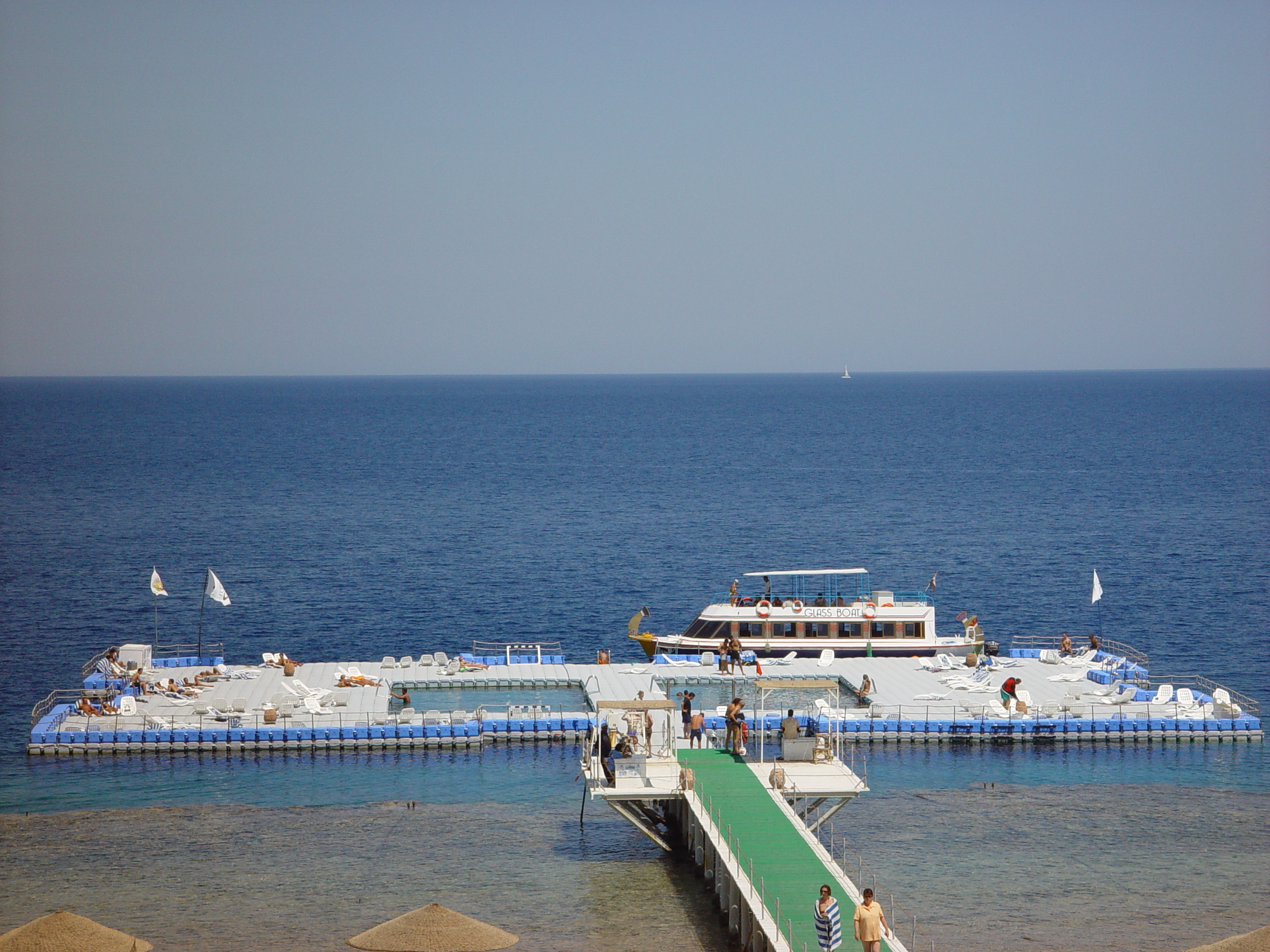

  3. JamesG
    Joined: Aug 2009
    Posts: 82
    Likes: 4, Points: 8, Legacy Rep: 55
    Location: Virginia
    JamesG Junior Member
    What if I just bought one of these modular floating docks instead? This could probably be used as a barge minus the dock leading up to it.
    Would the coast guard approve that as a vessel? I noticed that the manufacture of this floating dock sells motor mounts, so it would be really easy to turn it into a barge!
