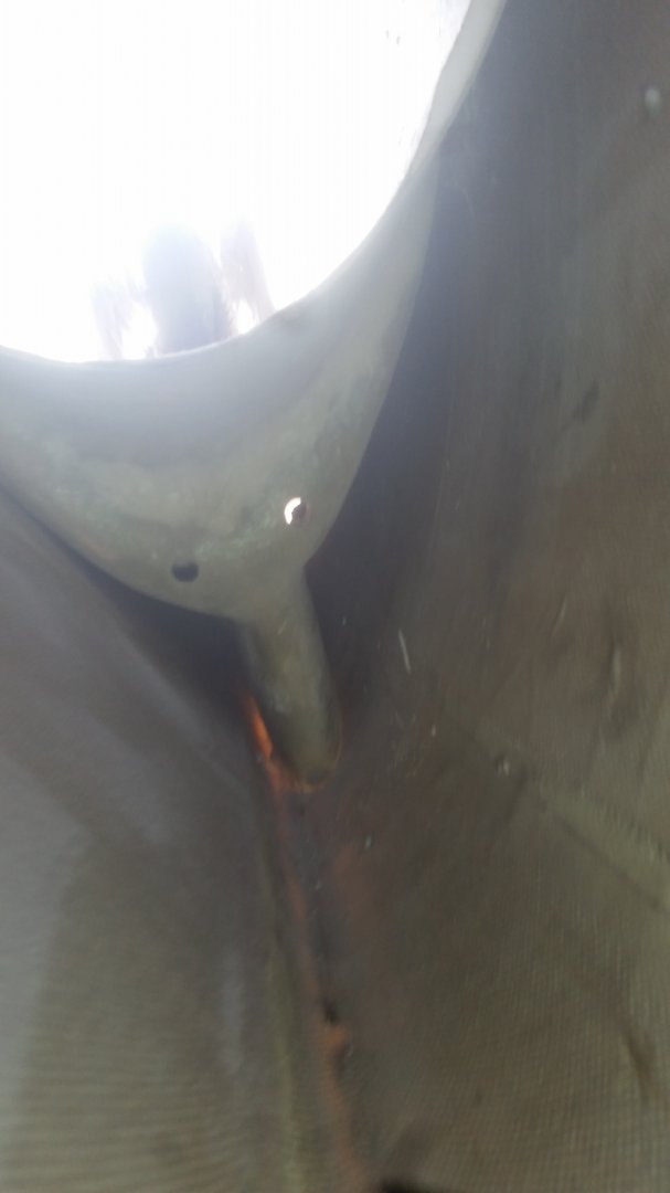

    The photo of the centre case shows the 3 skins, although the bottom 2 are well glassed in when the hulls were upside down, I now have to fill those joins from the inside.
    I think I'll try a thinnish mix of fumed silica and flock that can run into the gaps when upright. It's for added strength but mainly to stop sand, water and stuff from getting caught there. I tried gorilla glue[polyurethane] on one part I had better access to on the rear of the case, will see the results tomorrow.*

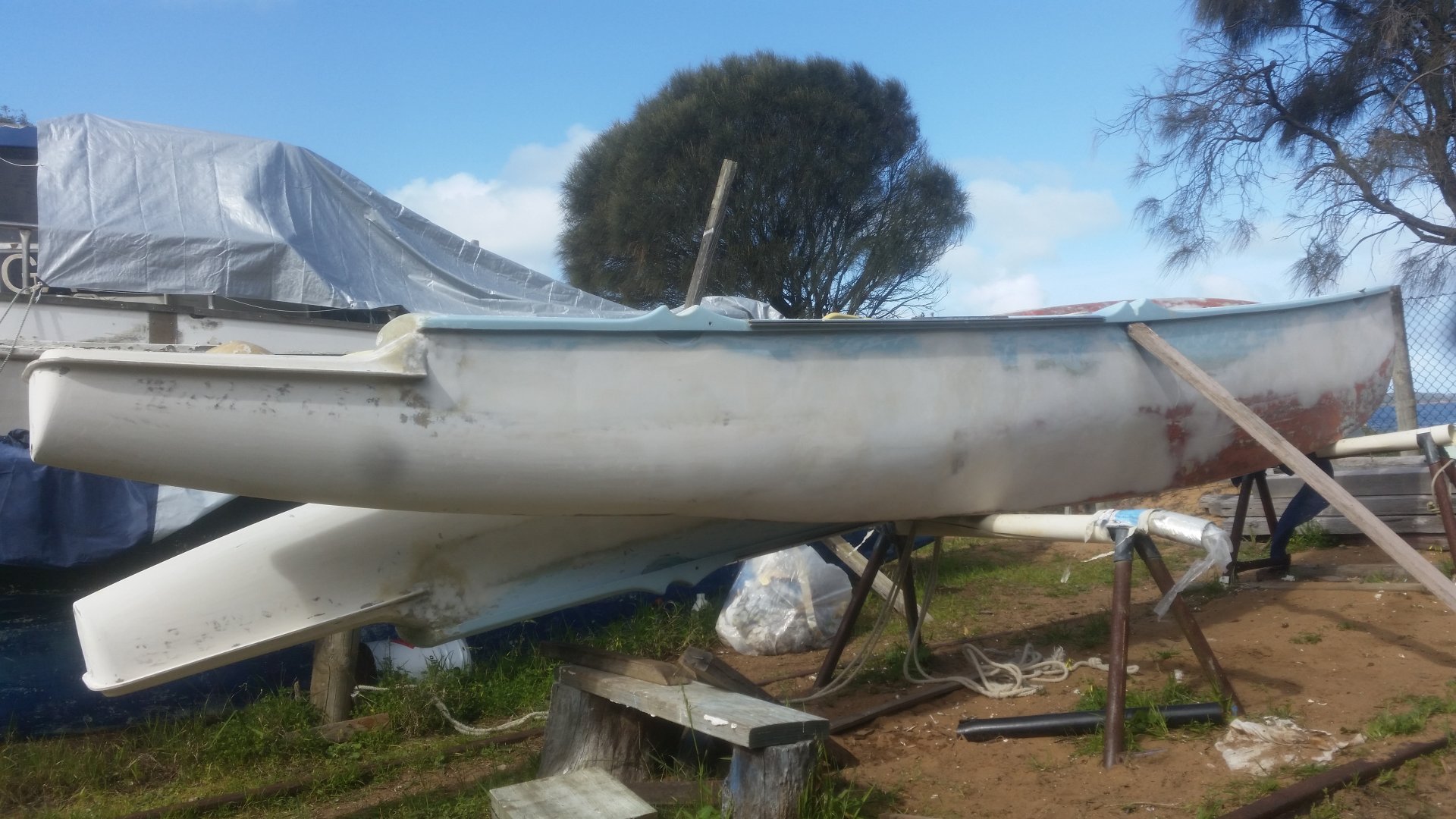

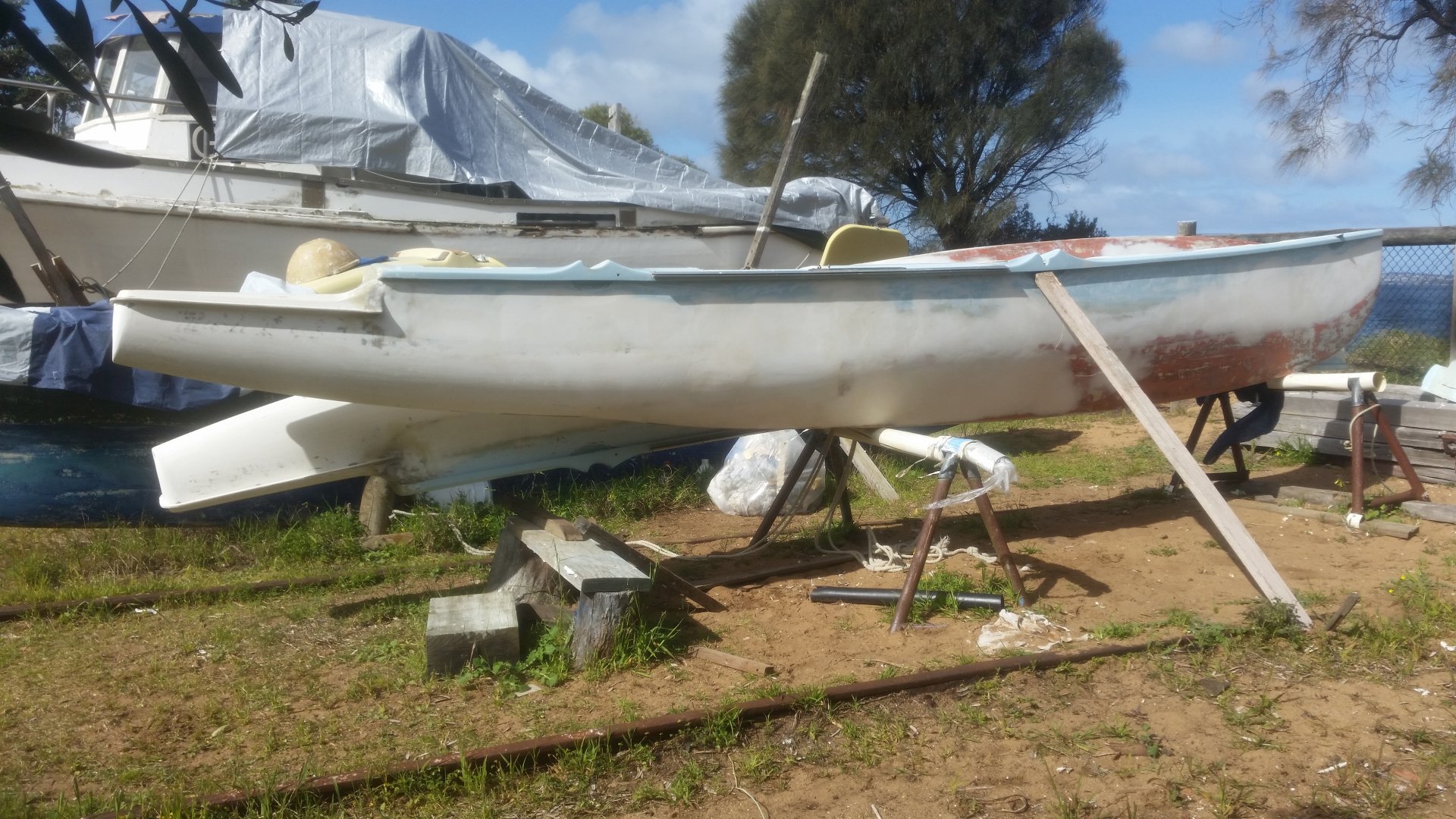

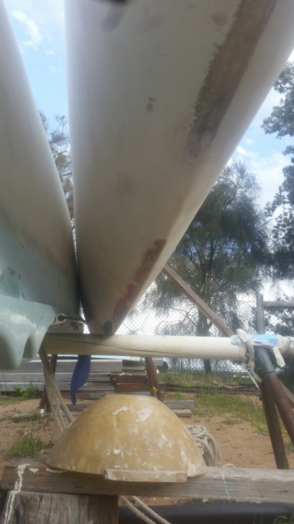

    The sun shows the hull shape profile , they have a lot of freeboard deliberately, they will be angled at more than 7 degrees to cut down on windage from the windward flying hull.
    I had the hulls better faired before I had to repair any spots where the Qcell didn't mix well enough, I hope to improve on where they're at now, but they are probably fine for my needs.
    These float photos are of the centre hull facing side of the ama, blending the asymmetric into the symmetric of the maricat was tricky.
    ps. That ugly step in the stern should pretty much disappear with the rudders in place but I may glass in a better transition if I can't bare it.
    pps. it looks horrible from that angle.
    *I soaked some some dyneema in the fumed silica mix and pushed it into place with a long piece of quad, it worked well.
