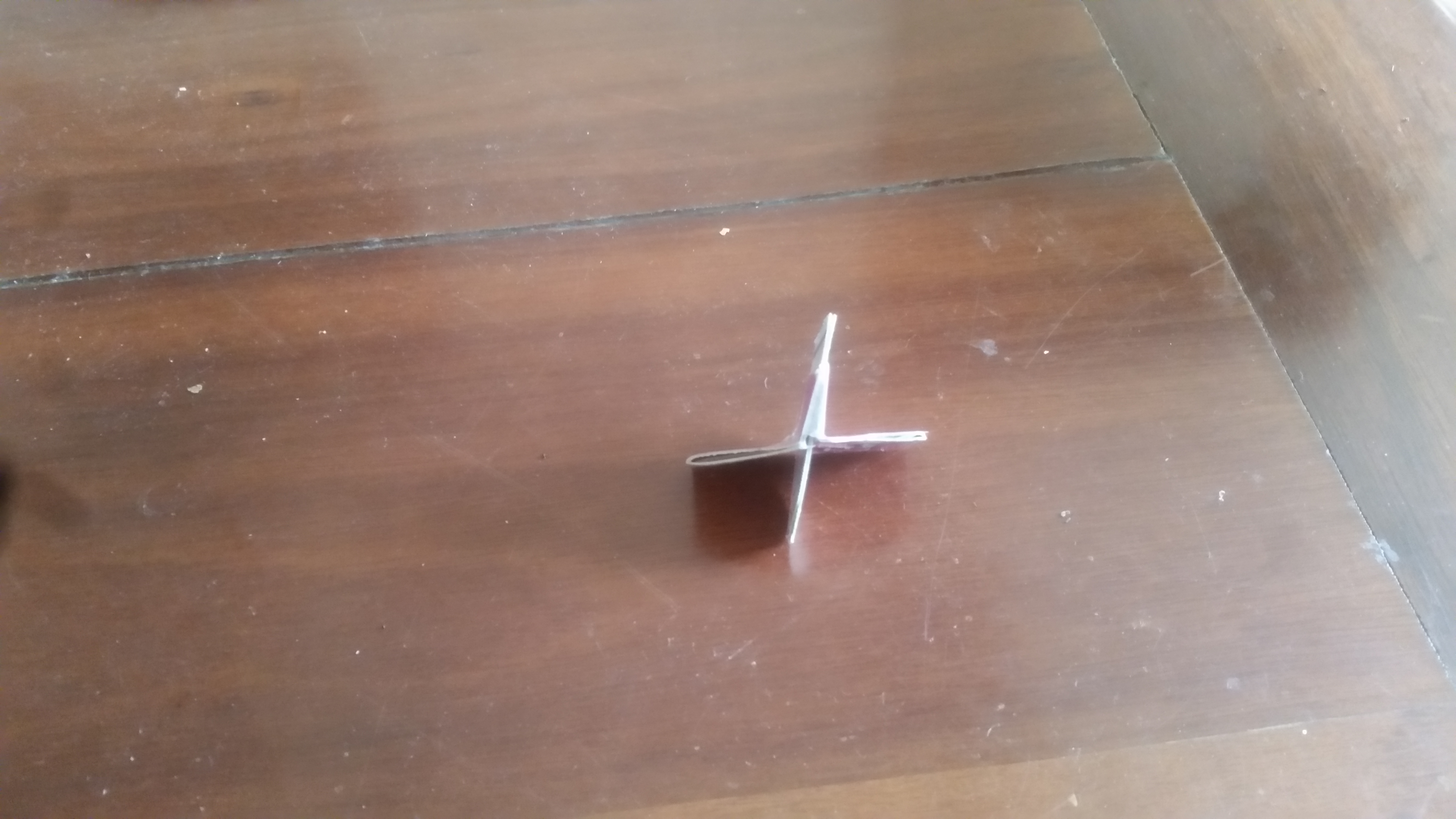

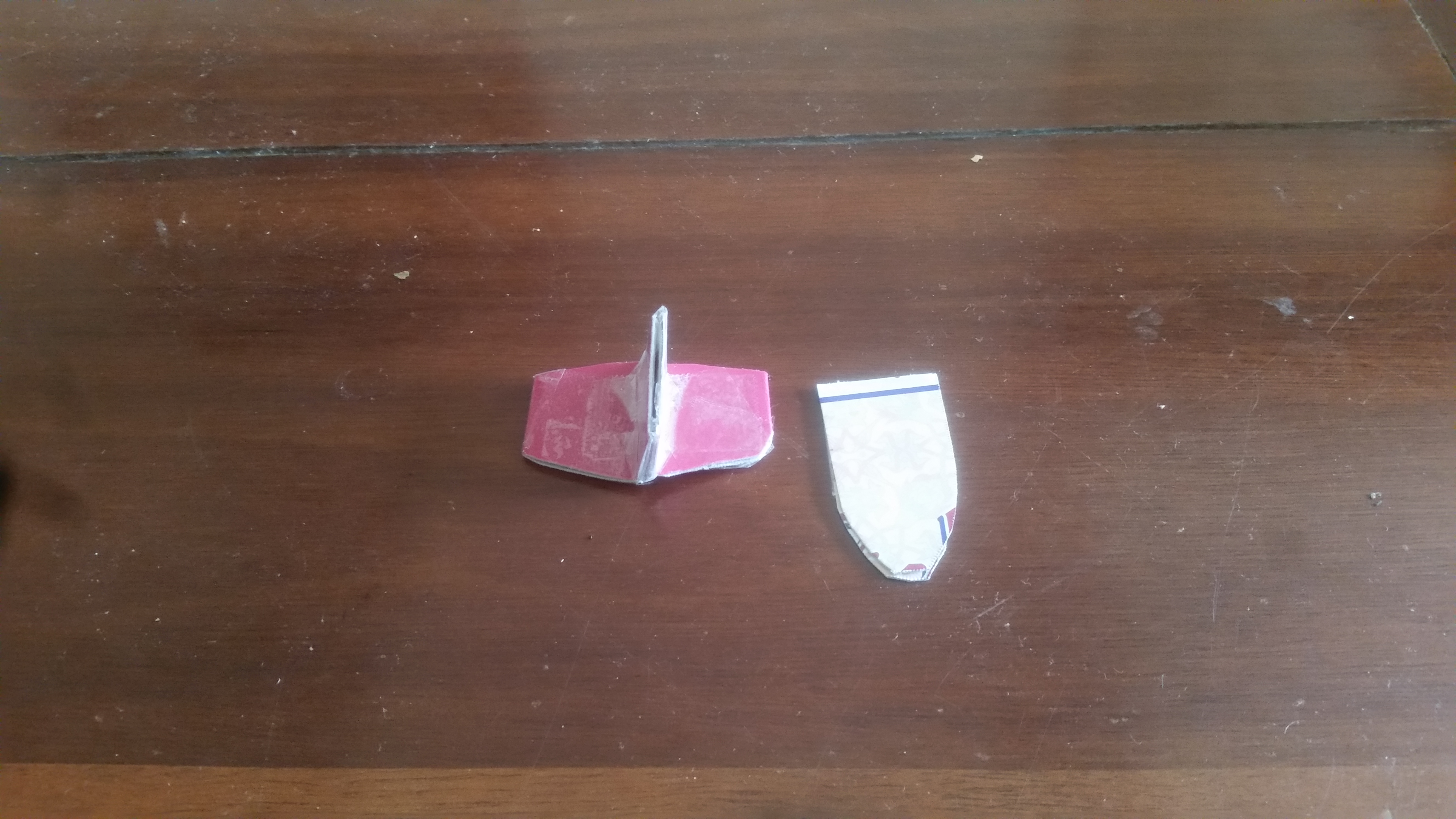

    I made baffles to stop water sloshing up and down the lower bilge skins of the floats yesterday, I'll be reinforcing where they could punch into the Hobie 18 hulls just in case. I don't think I'll use water ballast but I will have a manual bilge pump that can transfer or bail, connected to all three hulls . Really long runs where a tack isn't necessary it would be tempting.

    I have nearly finished the baffles, I just need to cut slots down the centre of each of them then glass while pulled /tied in, the same width as the outer skins to match the original H18 shape. I should be able to increase buoyancy forward as H16 naturally has more than H18. Reading Oldmulti's post on Buccaneer24 modifications[wow] was a little unsettling. Sticking to my original design criteria/statement of intentions- a safe fast strong cruiser that I can camp on.. seems a little dull by comparison. But money and time, experience and purpose are keypoints, it's taken a month to put in the baffles...ha There were 2 cheap buccaneers on Gumtree in need of resto's a couple of days ago.. I'm enjoying the work though ,no rush, just get the hours in when feasible ,just get there regularly. The missus has resigned herself to it [within reason..ha] and I think is showing no annoyance,..well that my dulled male or possibly deluded sensors can detect, much less of a slog. Note to self, must resist extending beams,..maybe one day.

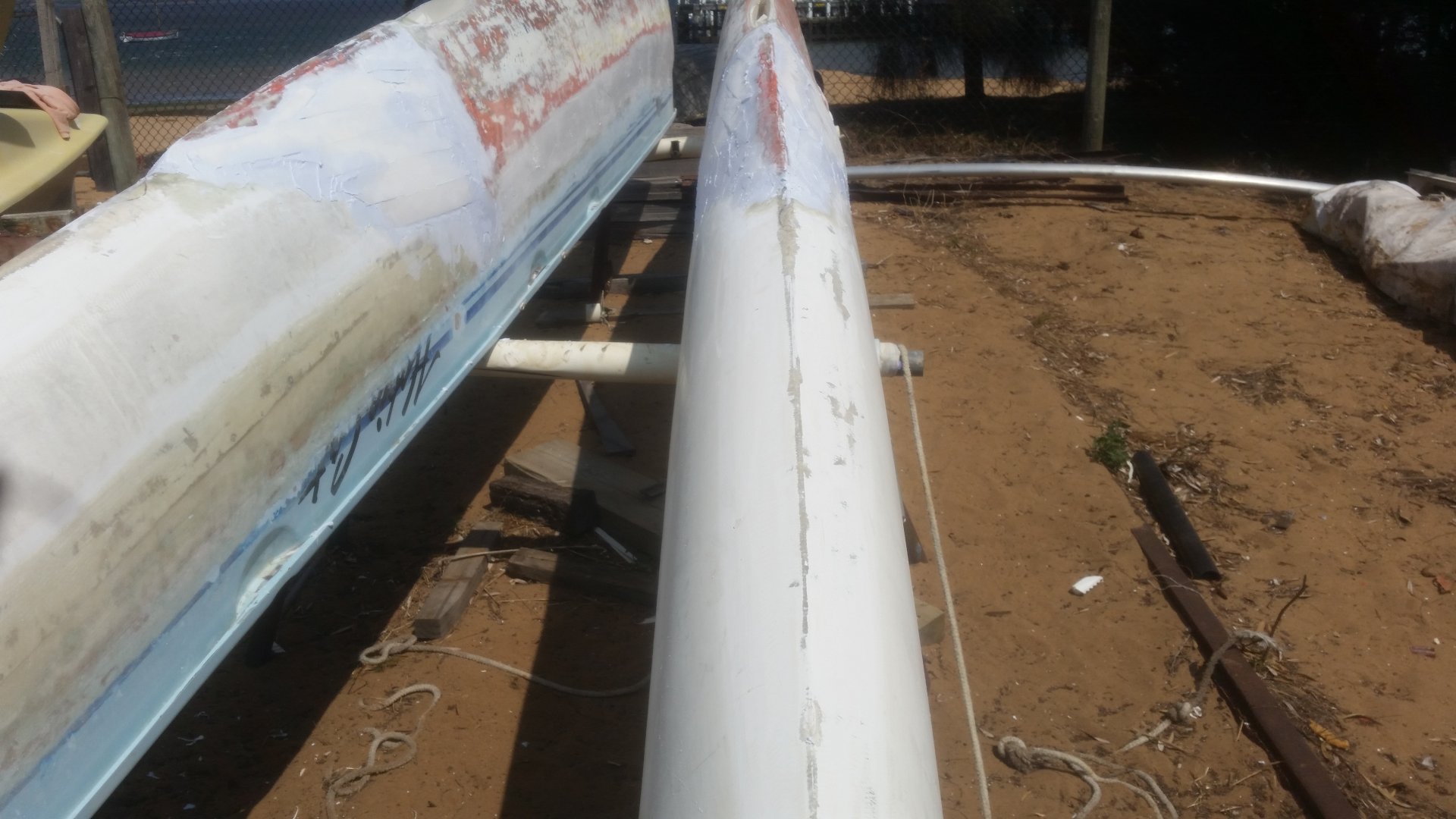

    I screwed and glued the maricat stern sections on, then got a little distracted when laying up the case re enforcemnet so had a fair bit of grinding to do yesterday,...drats. I'm using micro balloons to build the join step as I laminate the hulls together. I laid a length of 150cm 45 diagonal biax first to build up strength and help bed the join and act as a new stringer. Will use a flock to act as hole fillers when the screws are removed. Hobie 16 bottoms are solid and H18 decks are thick and strong, neither have much strength in the hull sides, H18 are the weaker of the two in my examples . Strong equates to heavy so yes tortured ply hulls are looking preferable ..much lighter.. but where is the fun in that? sheesh. It's coming together.

    The maricat 'shoes' went on nicely, the 400g 45 biax 150cm width E glass is is tricky to wet out in the sun and is taking a fair bit of nerve not to panic ..ha. it is probably best suited to vacuum bagging.It also doesn't like corners as it is so thick, but it holds it shape really well..I confess to using my hands with two layers of gloves, you can squeeze this stuff and unroll it but it almost ends up too dry even though its well wetted out. With your reading glasses on..ha, you can see tiny bits of not completely saturated cloth, so going over it with a wet mix when its laid helps. It is going to be great for making brackets and fixings where it's say 6 layers thick and done in one shot..It takes a fair bit of sanding edges and Qcell /filler use when fairing for a second layer.
    You can see the brown ridges after sanding on the H18 hulls that show how the foam sandwich has delaminated, I'm adding patches with the biax where it's soft. I've been adding a layer of biax to the H18 hull then glueing and screwing to the new hull or 'shoe', then fairing and adding a 2nd layer to the join.

    I had a good day on the boat today sanded, applied and sanded Qcell with hardly any pin holes left, and laid the biax on one side of both hulls on the joins..6 hours.
    There will be significant Q cell thickness faired over some spots on the join[ above the water line] , I'll lay a light matt over it when it's close to fair in case it thinks about popping off under load. The issue of how to keep weight down is best solved by injecting from the inside out drilled holes with an epoxy/flock mix. I think it's the best way to ensure the sandwich foam and glass skins are tied together. I attempted to work a polyester /flock mix from the outside in, I just checked and it didn't make it's way through. I'll drill the existing holes from the inside out just enough to feel the filler,then inject epoxy into each hole.
    There is something to be said for recycling old hulls, long lasting and because fibreglass is a woven fabric, if damaged, such as a soft spot/delam, it can be easily repaired[as long as the original job was good ]. I use a wok , a shallow plastic storage bin for wet outs , a milk shake container , some plastic scrapers, gloves are the main waste, after sanding..the dust, I don't use much sand paper, which frankly means less efficient use of time .

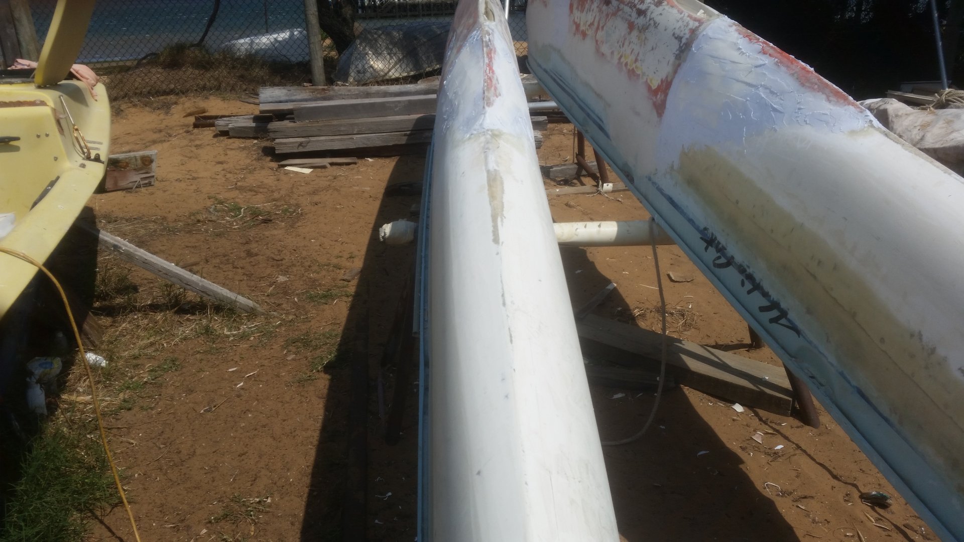

    I've glassed in the little stubs of H16 that sit behind the cases and have resorted to an old surfboard [a ring around] to fair and glass the join. Polyurethane sikaflex takes to the foam easily , I didn't want to fill/fair the voids with Qcell, They're a bit heavy and rigid, and I don't want to run out of microballoons..Most of that foam will be cut off before sanding. I think that the bow shape looks practical for beaching and running into things so I'll go with it..

    The hull on the right is looking a little bulbous, this stuff is easy to sand.
    I'll lay 2 layers of 6 ounce over this , the strength is already built in. the urethane glue can tend to roll when sanded , I wont be using it for glueing edges anymore, it holds wonderfully glued straight on. This next week I'll have to decide whether to buy sheets of polyurethane foam and fair the hulls to a point where the joins disappear completely. I think I'll leave them and see whether they work well and aren't too heavy. I would be better off spending money/time on epoxy/plywood hulls. I had some advise from Guzzi a couple of years ago where he suggested knocking up a set of ply floats out of cheap ply to see how they went..that was good advise, but I had already bought my hulls. I'll weigh them today..
    They weigh 85kgs, that's without the H16 posts to take the beams, One hip protrudes a little more on one than on the other hull, the lines are shapely and growing on me , I'm happy with them.
