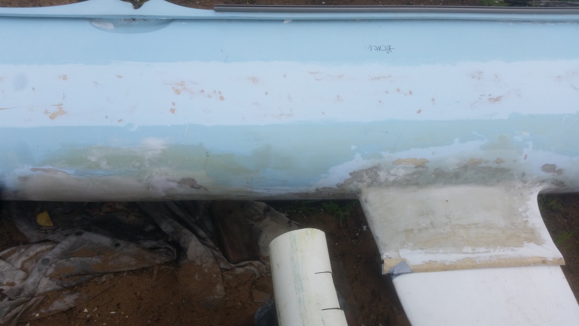

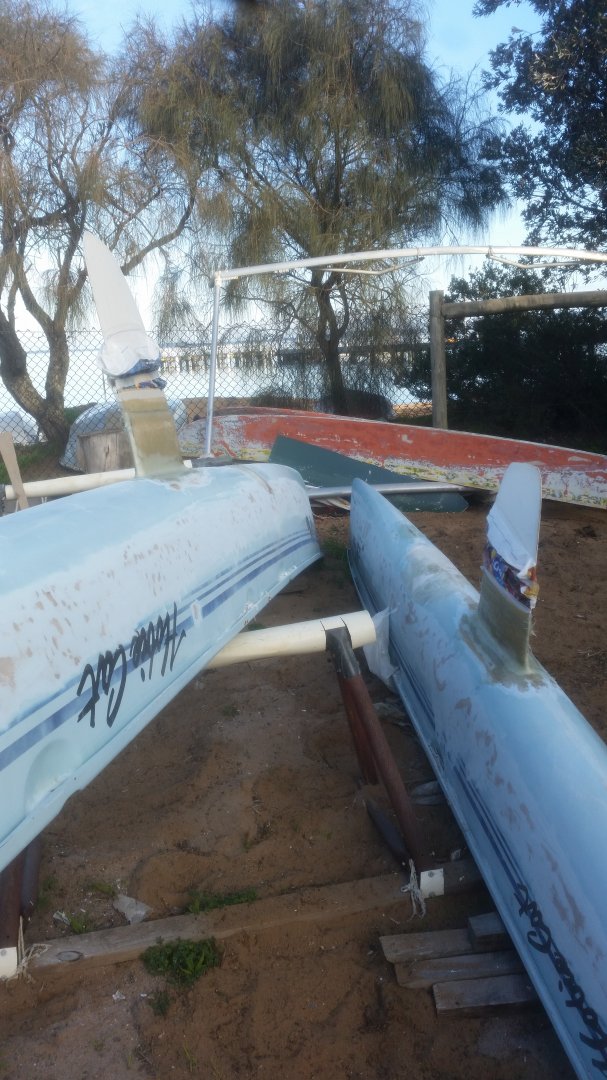

    I was relieved when the dagger boards winkled out, getting close to glassing the 2 parts -hobie 16 and maricat which overlap on the new dagger board cases, maricat is the new stern. You can see the sanded line where the donor hulls will be glassed to. The new length is 21ft plus a bit, mainly coming from the maricat stern. the bows will be a modified form of H16.

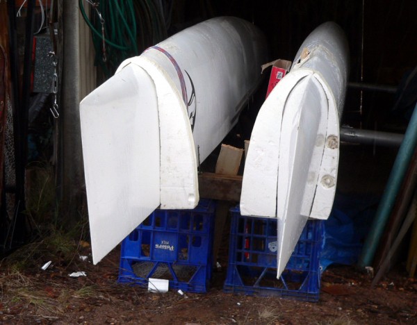

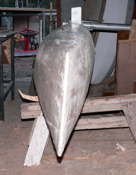

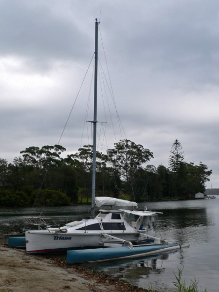

    Have just fallen over this thread. Just for interest. I did precisely what you are doing, but in my case using A Class hulls. I posted a question on this forum and was told (especially by Richard Woods) that the hulls had insufficient buoyancy so I packed them out with shaped foam formers , then strip planked over that with Paulownia before glassing with biaxial cloth and epoxy. A bit heavy but the shape has worked well.

    There was a sad sequel to the story. I got a lot of pleasure from this boat sailing around St George' Basin but it was moored fore and aft at Sussex Inlet where it was subjected to bad cross winds coming down a creek, so I had a new mooring laid off Basin View. It took just a week before the boat was stripped, then torched. The Vaka burned completely. I lost the new sails, winches, electronics, night-vision optics, GPS, my diving gear and heaps of other stuff.
    I did recover the amas, the mast, the pulpit and a few of the alloy beams and am building a little catamaran from the parts.
    Not a happy outcome from a couple of years of work and several thousand dollars!

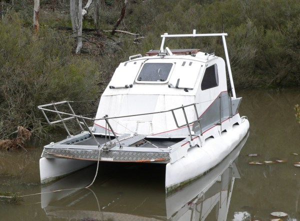

    I have no doubt it was a silly decision to use the recovered hulls as the basis for a simple sailing catamaran but I did have most of the components, including the alloy cross beams, most of the rigging, the pulpit etc that I pulled from the wreck. The result is a ugly little ******* (literally a product of mixed parentage) that is yet to see water (other than my dam used to check the hull integrity and mark the waterline. After that exercise, I remodeled the stern sections of each ama to provide greater buoyancy, then re-glassed these hulls to make them stronger.
    Whether it will ever be completed is debatable. I'm debating whether to pull off the sailing gear and just power it with the 5 Hp outboard I have acquired, OR finish the sailing version that is probably 75% complete. A new rudder is ready to fit and I have worked out a system for a swing-up centre-hung daggerboard I have a 16' skiff mast and some good second hand sails for it but worry about that rig being too tall and potentially causing trouble.
    My level of interest in finishing this boat has waned considerably since I started, but I still want something to get me and my dog back onto the water, even if it is restricted to inshore use. At least it will be trailerable and avoid the hassles and cost of a mooring. The other option is to sell it for whatever I can get and use the money to buy a used "project" Folkboat or similar.

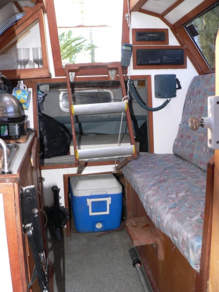

    Boy - do I miss the beautiful 30' sailing catamaran I built - see picture - the one effectively stolen when my ex-wife refused to contribute to outstanding school fees!
