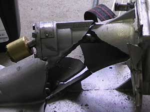

    Thanks PSG-1. Everybody please remember. Reefs and rock shoals are death to all types of prop drives lower than the hull bottom. Sand and mud or muck bottoms will destroy all COMMON built jet drives and possibly you if you eject in a turn with a channel marker pole in front of you. Very shallow running is definately asking for it to happen. Go slow in shallow.

    Awful things happen with jet units too running in shallows.a blown jet.
