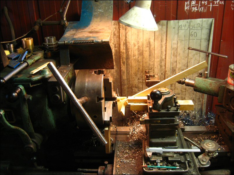

    First I needed a stable platform, a piece of 38 mm birch plywood fitted that bill. Then I cut two pieces of wood that both had a 26 deg. angle in them. I attached the blocks opposite ways to the base 100 mm (center to center) apart (90 mm would have been more correct but I figured it ain't that presise). Then I drew centerlines to the blocks and used files to fair the facing corners to an angle that matched the opposing side.
    As a skin for my mold I had thought of using 4 mm plywood, but that idea was quickly abandoned as I tried to twist it into shape. Next I tried thick cardboard 80 mm wide, no fish. I cut the cardboard in two to make a 40 mm wide strip, it still didn't want to twist enough. One more try and I cut the strip in half again, finally success. I made more of the 20 mm wide strips and stapled four of them side by side, add some two sided tape and added three more strips overlapping the bottom layer. Some painters tape and I had a mold ready.
    If you look closely enough for the first picture you'll see the twist is for a righthand blade, it was in this stage I finally managed to check which way the prop was SUPPOSED to rotate. :p
    No big harm done, I disassembled the first attempt and tried again.
    I drew a blade shape on the mold in hopes it would show through the glass. It did show through and I was able to transfer the drawing to the blade surface. That way I had a center line in all blades and the shape is identical. After covering the mold with a thin plastic film, I laid five layers of 290 gsm fabric. I lined the layers so all fibers from tip to root were parallel, but the longitudal fibers were diagonal and opposing between layers (does anyone understand this? :p ).
    Three blades, one is already cut to size. I cut them a bit bigger than drawn to have a bit of extra to play with later on.

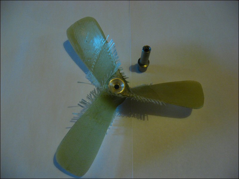

    Now I had the blades, time to make a center piece to attach them to. As said earlier, I made the core from aluminium, a long bolt seemed like a good material. I milled a 10 mm hole in one end, 34 mm deep and a 5 mm hole the rest of the total depth on 45 mm. I beveled a space for the screw head at the back end (5 mm hole). I milled a two way groove to the surface of the piece to ensure fiberglass staying where it's supposed to.
    Before glassing
    And after, all faired and ready for blades
    The next hurdle was attaching the blades to the core, and to get them all in the right position and angle. I made a jig that attached to the lathe, a T-shaped piece that the blade could be attached to. the angle for the jig was calculated using the method described earlier (seems we need three of the these), this time using 40 mm dia., the jig was placed 20 mm from the center of the core.
    First blade getting attached. I used a mix of short fibers (<10 mm) and resin mixed together, using tweezers to get the fibers in place. The excess resin (you can't really mix small enough batches for this) was used for spare blades, I have three of them waiting. After all three blades were attached I repeated the short fiber and resin process to the back sides of the blades.
    Pics of the process
    After hardening, I used a sandpaper wound over a round piece of wood to shape the join area. Then it was time for reinforcement.
    I shaped the propeller by attaching it to a cordless drill, and rotating it against a 60-grit sandpaper. This way I was able to shape all the blades symmetrical and not do any damage to the prop.
    Finishing the propeller took a lot of sanding, some self mixed filler (resin and sanding dust (mostly fiberglass and resin), the brown bits on the prop) and more sanding...
    ...some primer...
    ...and some acrylic spray paint. Here you also see the first piece of the prop shaft, made of stainless steel, that larger part is the sliding surface against a nylon bushing and a water seal (outside the bushing), it was sanded down to 600 grit paper. The smaller part is to be glued inside a pipe that makes the next part of the prop shaft.
    Well, there you have it folks, my way of making a propeller.

    The blade thickness is a bit under 2 mm and the whole structure seems really solid, so I feel I did a fairly good job.
