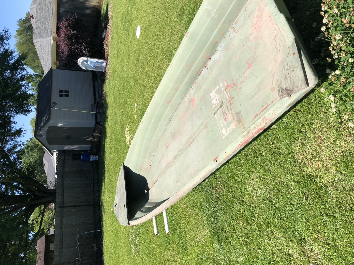

    Ok so I’m NOT going to use the woven fabric. I wasn’t planning on using foam in the construction. The mold itself has to be resurfaced since the person I am getting it from spray painted the inside. Structurally it is in great shape and has no cracks or serious issues besides the paint. I plan to sand off the paint and get to the gel coat underneath then resurface it with DURATEC. The guy was using the mold at a boat to get to his duck blind but it weights about 400 pounds and is extremely solid. I figured since it’s structurally fine I could bring it back to life with a whole lot of time and elbow grease. What are your thoughts on this ? I know it looks very ugly in the picture but I’m going to resurface it. I read that I could either sand or sand blast the old paint out. It’s peeling off any way so it wouldn’t be very hard to get to the old surface

    You can use paint stripper and a pressure washer, sometimes all you need is the pressure washer, this will leave the surface in good shape, or at least won't add to the surface defects.

    If it’s just a one-off deal, I’d just give the mold a scrub to get it clean and knock off the loose stuff, then coat liberally with PVA and gelcoat, and lay it up.
    It will come out of the mold looking like hell, but The time and effort that you need to put into bringing the mold up to snuff might be better spent sanding on the piece itself, and easier and more ergonomic to work on.
    Even though the mold is heavy, check it carefully before layup to determine if it has warped or deflected. You might need to build some exterior frames to hold it to its intended shape.

    With that being said. Could I just not gel coat it and just paint in a layer of wet resin to start laying my fiberglass then once it’s all layed out and cured pop it out the mold, fair and paint over the bare resin hull and fiberglass ? Or would this cause an issue with it coming out of the mold not having the first laying being gelcoat. Of course I would coat it like you said with the Pva to have it come out the mold and not stick. The last thing I want is for me to spend all this time and money and it stick in the mold. That would suck big time. I feel like if I could take this rout and just paint it with awlgrip or something similar I would avoid stress cracks in the gel coat later down the road. And like you said I don’t plan on mass producing skiffs with this mold. This is just for me and I got lucky to get my hands on a decent mold

    It's much easier to use gel coat in the mold even if you plan to paint it later.

    Ok good advice. I will stick to the gel coat. I don’t mind having to either paint over it to make it a little shiny or sand it and buff it. I just might do this instead of spending so much time on the mold if it will realease without sticking

    Yes, that’s why I said to coat liberally, probably two coats, as sanding gelcoat is much easier than sanding resin and fiberglass, and it doesn’t make you itch.
    Once you get a feel for it, you can be pretty aggressive with a large softpad and get good results.
    Multi coat the pva too, it’s cheap and water soluble, and you’re not going for an immaculate finish straight out of the mold. I use a garden sprayer for applying pva, and an old (clean) wetted out sock for small parts!
