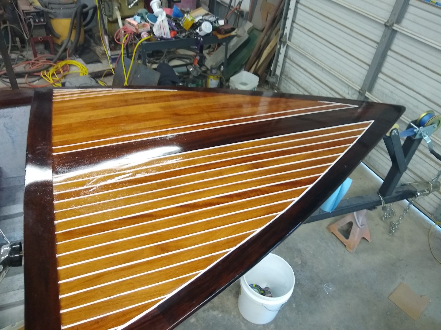

    The motor is for remote controls , it is pull and electric start. I have already installed the steering wheel etc. I thought of what you said about using a temporary tank and moving it around. I have some time before the motor arrives so if there is a way to calculate the best location for the tank I would like to have everything done as much as I can.

    After reading over USCG requirements of permanently mounted fuel tanks, a six gallon portable tank is the best option . I was going to tig weld an aluminum tank together and mount it behind the seat, but I have no way to have the tank certified. I do plan on selling this boat as some point and starting another. I took the boat and trailer to California DMV , got the trailer registered , but they said I could not register the boat because is was not complete. I finished the boat a couple weeks later (was missing the seat and the motor) went back to DMV , turns out you can register a home built "wood" boat without having it inspected or even seen by a DMV employee. "fiberglass boats require inspection" they assigned a HIN and gave me the registration stickers . I will be sewing up the seat upholstery this weekend. white tuck and roll with blue trim. the pleats are done just need to sew them into a cover. true tuck and roll, blind stitched with stuffed pleats is a lot of work but looks real nice. will post some pics of the seat when I get it done. The Yamaha F25 I ordered is back ordered with no definite ship date, according to the yamaha invoice it was supposed to ship may 15, then june 1, now no date . I caulked the deck the other day, turned out to be move difficult than I though to get the caulk completely smooth. I used masking tape and a bondo spreader.
