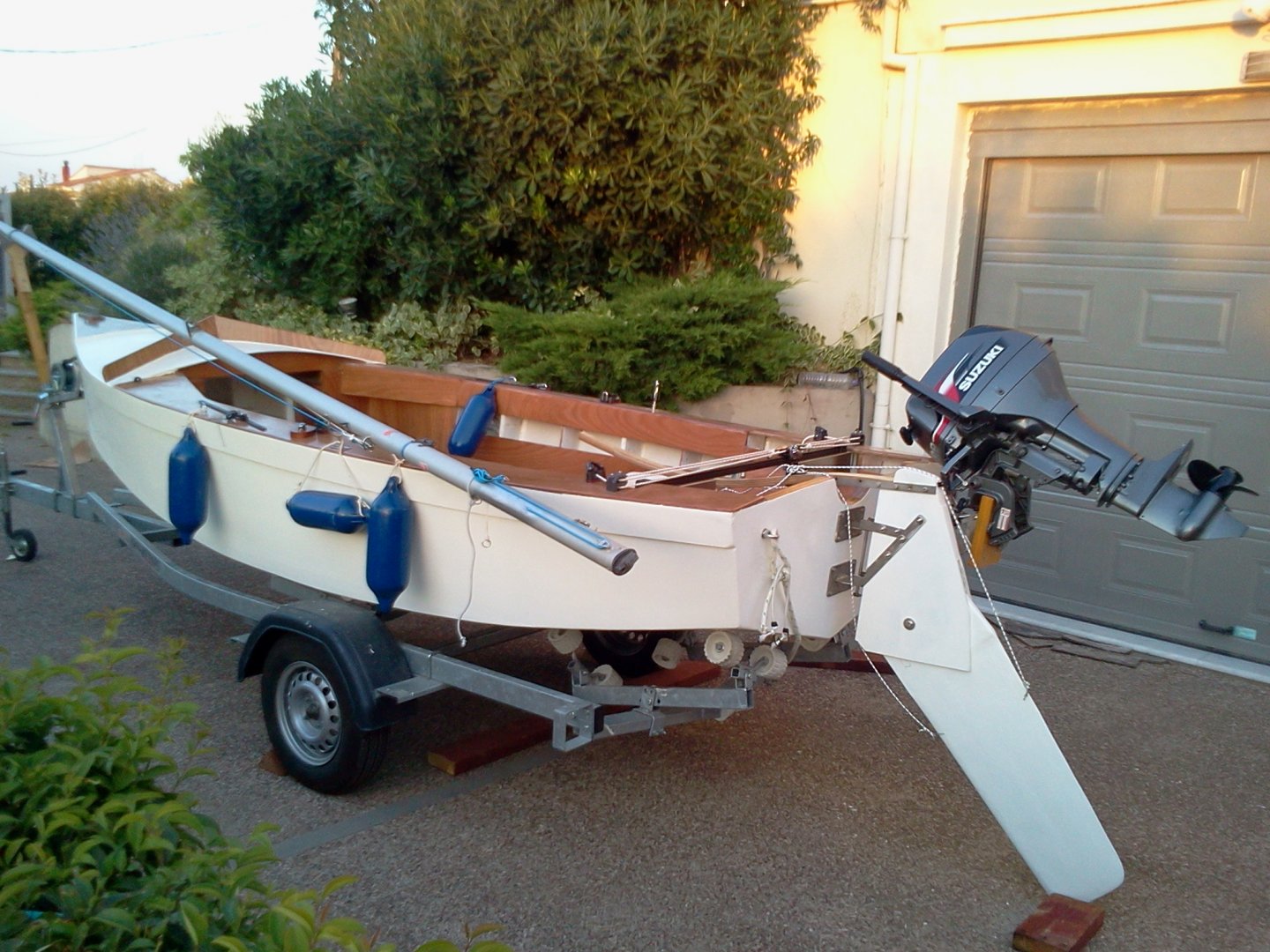

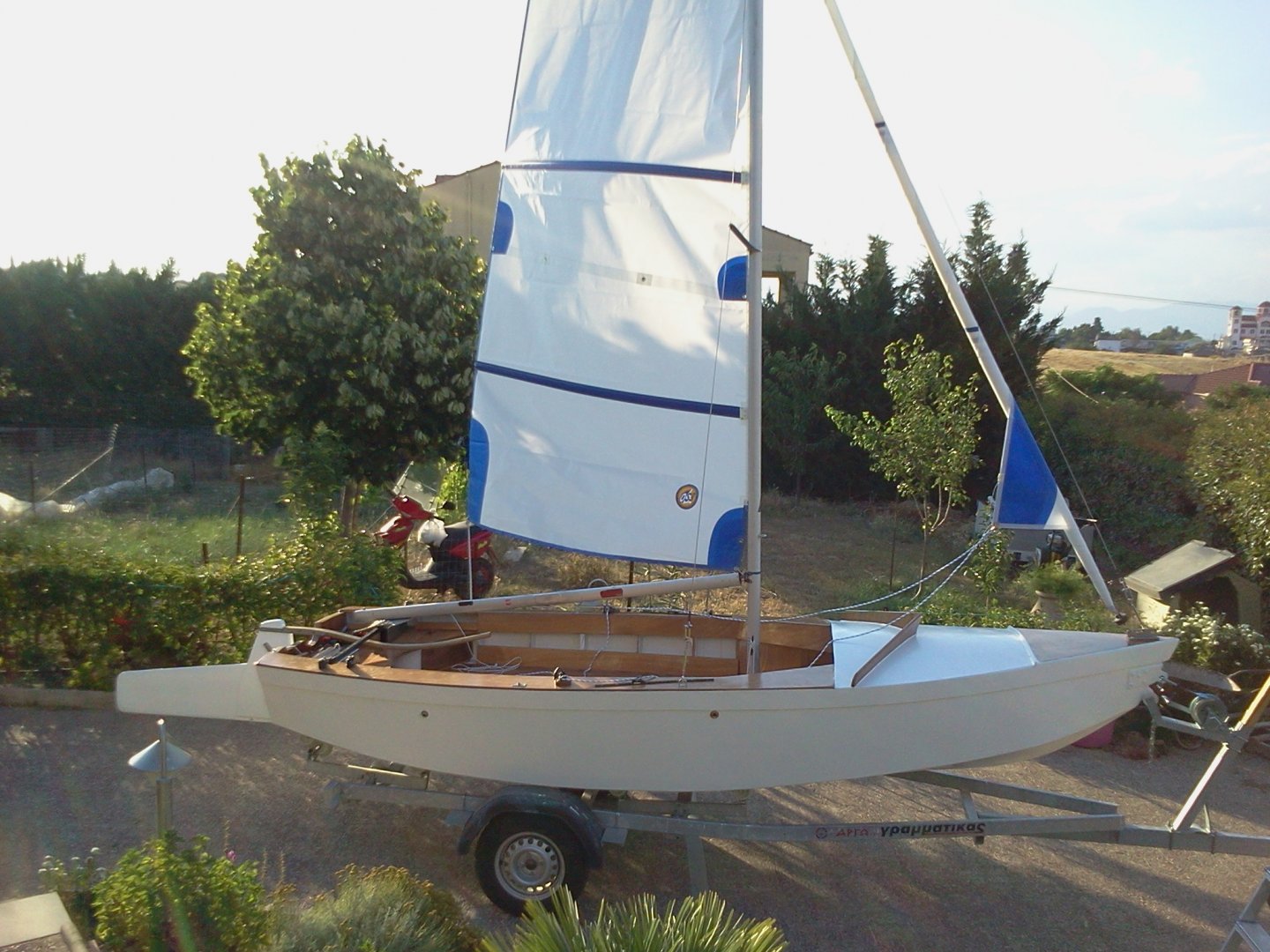

    Greetings to the great FORUM!
    I have build a 16ft sail dinghy with a daggerboard. The method was stitch and glue with plywood, fiberglass, and epoxy. The alum mast is a 470 international mast. Total sail area about 18sq.m. Hull weight about 400 kg. My dinghy has a DAGGERBOARD. I am a starter on sailing and I am not interested in performances.
    Additionally, I have discovered that now I need a small cabin on it, for making better coastal vacations during the Hellas hot summertime.
    In order to have the most appropriate space inside the small cabin, I am near to change the Daggerboard and to make a LEEBOARD out of the Portside (one side first). Regarding the higher CENTER OF GRAVITY ( because of the small cabin ), I plan to add some permanent lead ballast on the hull.
    The Leeboard will be strong laminate plywood with fiberglass and epoxy. I am planning also to have the solution to add on the edge (throw some holes and inox bolts ) some additional weight (steel or lead planks). So the LEEBOARD not only will give its surface (as a wing) but also will add the appropriate ballast under the sea surface.
    After the above, I would like to ask some friends to give me their respectful opinions.

    Your 16 foot boat, at 400 kilograms, is already far heavier than a boat of that size needs to be. Adding ballast will diminish performance even more. You do have a lot of sail for such a small boat so that will help overcome the disadvantage of excessive weight.
    Lee boards are workable but inefficient when compared to dagger board or centerboard. The single lee board will be even less efficient when on Port tack if the boat is heeled to some degree. In addition, adding weight to the lee board will unbalance the boat to some extent, depending on how much weight you have added.
    The boat will work better if you leave the dagger board in its assigned location. Beginning sailors have enough trouble while perfecting their sailing technique. Modifying the boat so that it behaves in a different manner will make the learning process even more problematic.
    Post a picture of the boat if you can.

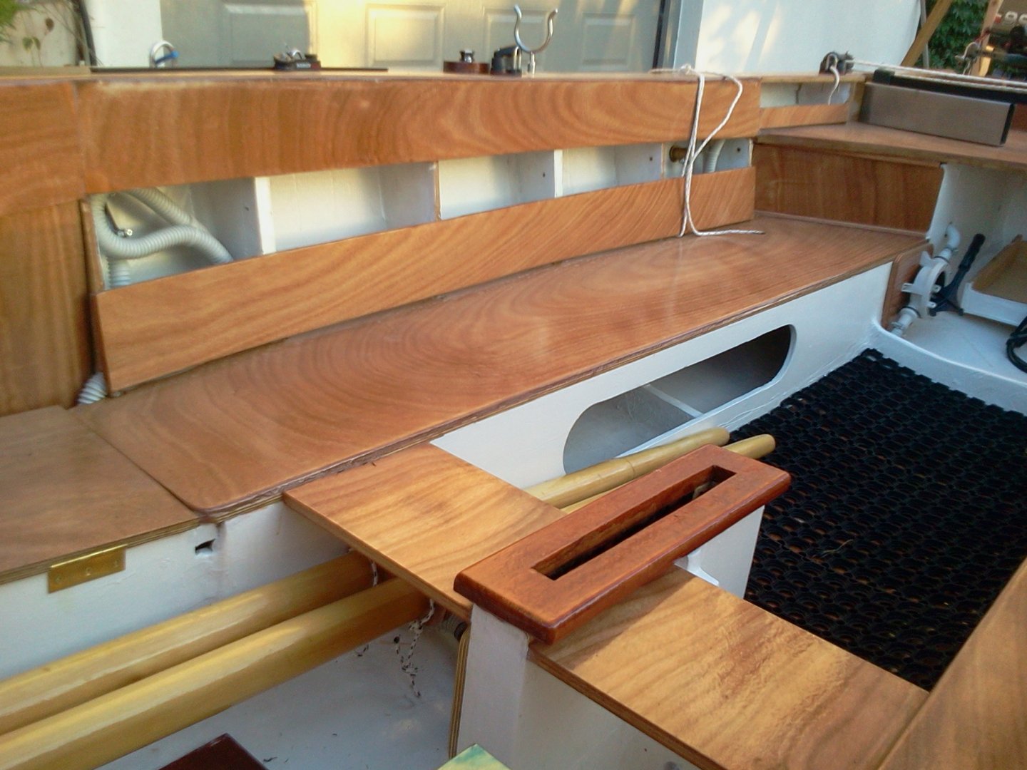

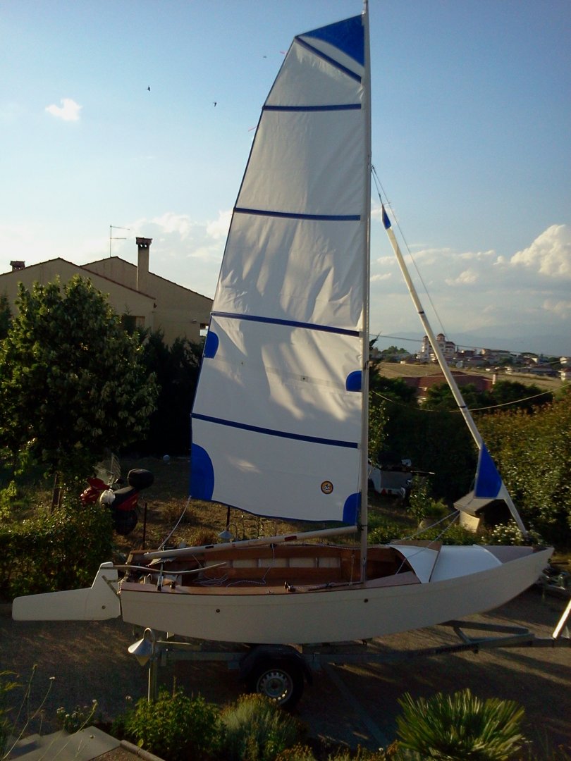

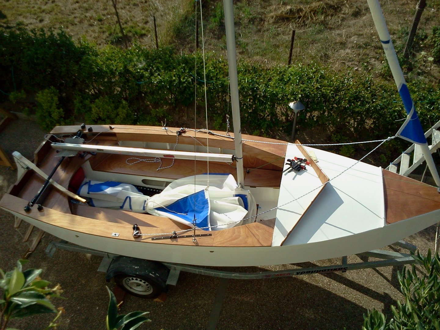

    I would like to thank you for your advice. You can see my boat

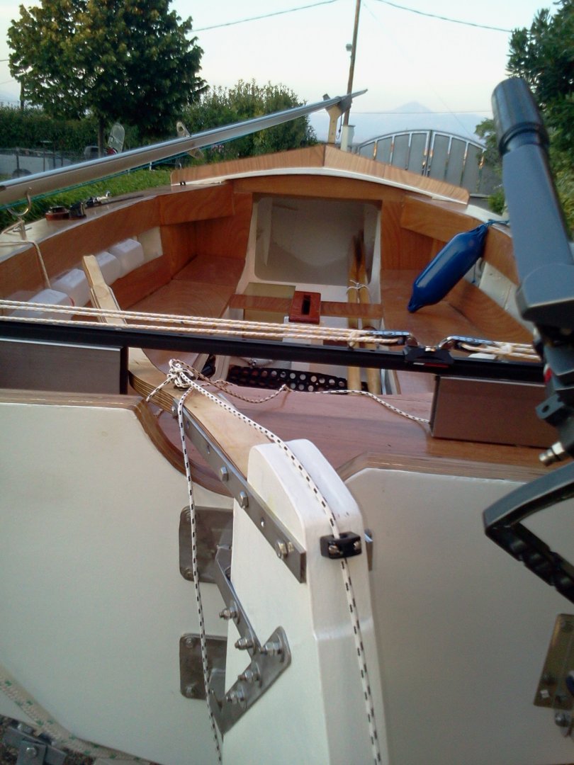

    If you are determined to try a leeboard then I think you'd be well advised to rig up something, preferably without making too many holes in your nice craft, that would enable you to see how well it works before you do anything to the daggerboard case. It would be most depressing to do a shed load of work and then find the boat will hardly tack or some other issue.

    Thank you. For the Leeboard it will need one hole Φ40mm (at the upper seer of the Portside ) in order to pass its axle. It is a good idea to be tested it first and if all works well after to cut the Daggerboard box Inked19 JAN 20_LI 2.jpg

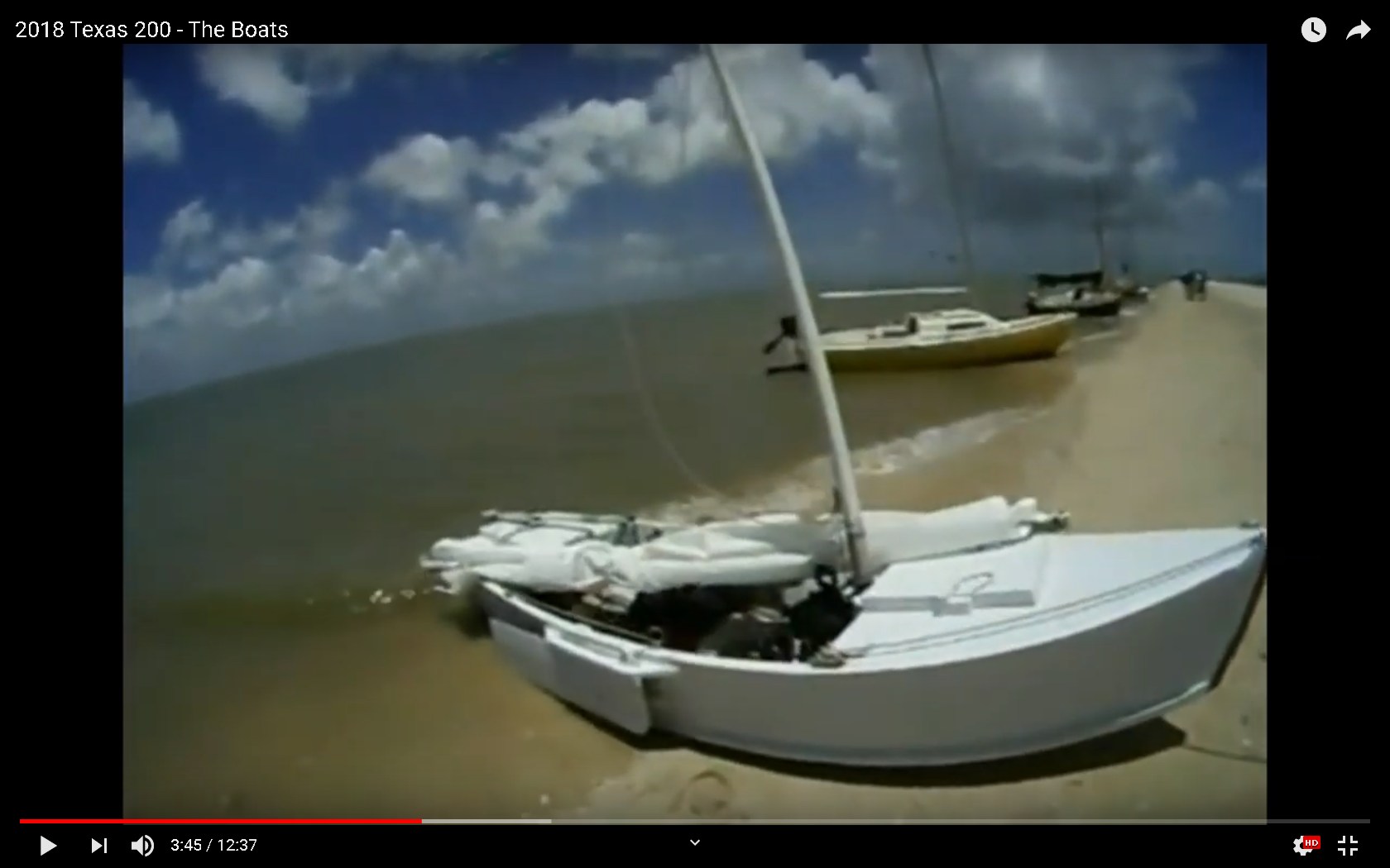

    Regarding the use - the technics and the construction of leeboard, I am studying the Holland and German classic boats (small and medium), also the homemade Texas small wooden boats which are participated in the annual Texas 200 Race, and many of them use leeboards.

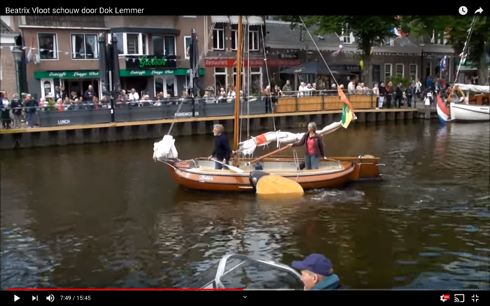

    The Dutch boats you show all have double, asymetric leeboards that are not restrained to float sideways up when they're at the luff side of the boat. I think the "texas" way is more appropriate for your purpose. Jim Michalak is the designer of most of these crafts, and he is clearly inspired by Bolger. Googling both their boat will probably give the best ideas. If you opt for the tent instead of cabin, I think there will be no need for a leeboard. BTW your boat looks good ! Cheers, Hans

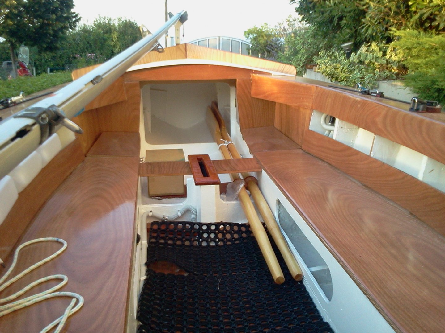

    You little boat is nice looking and appears to be well constructed. I can not imagine that it weighs as much as your original post stated, unless made of steel. It does appear to have an unusually large amount of chine rocker, which implies that it is a heavy boat.
    The tiller could be made a bit shorter and have a hiking stick attached. That would allow you to move about in the boat while under sail. Aside from that, I can see no need to change anything.

    Thank you. That photos are taken in 2014. I have made the hiking stick but is not necessary because I will make the tiller shortest relating to the cabin size.
    Regarding the weight, I have used: a lot of wood inside the bow, more woven fiberglass and epoxy for the inside shole hull and as you said a large amount of chine! Overestimation of a starter builder!

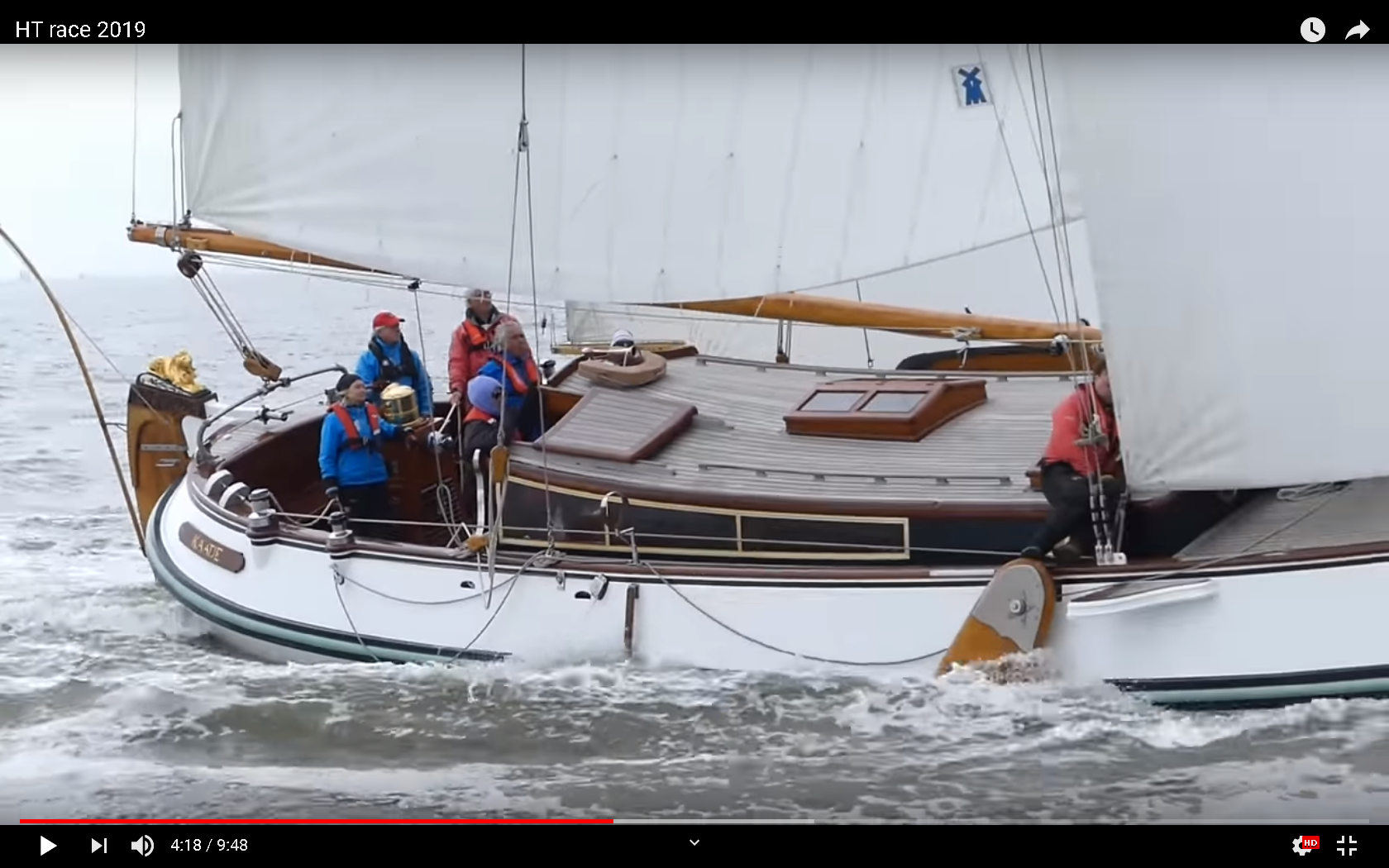

    I mentioned Michalak and Bolger because I thought that you were planning on using a single leeboard for simplicity's sake.
    The Dutch flat bottom boats are also for sailing on the sea. You can see on the pictures that the small boats (Tjotters) have big low aspect leeboards, suitable for shallow creecks and lakes, and the big ones (Lemsteraken) have long high aspect "sea type" boards for better efficiency in deep enough water. Hans
