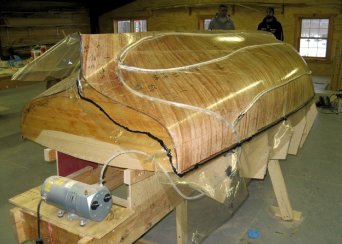

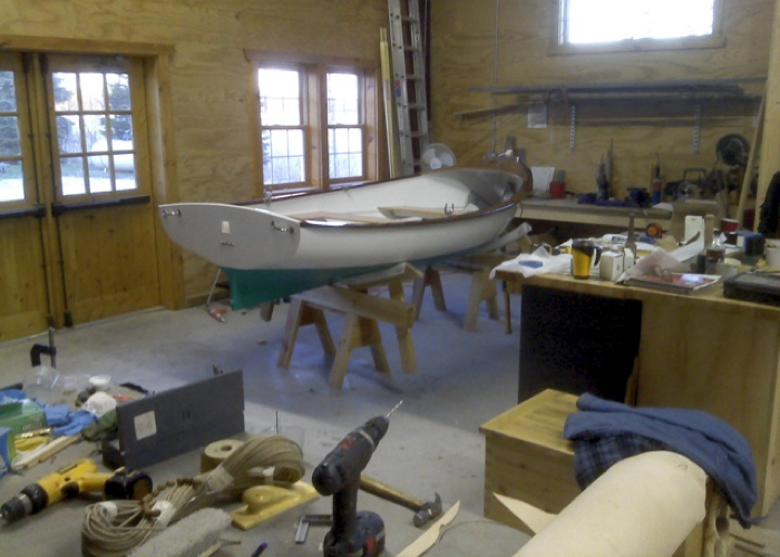

    It's a Wittholz 11' sailing dinghy so checking with the designer would be tough. This is a beamy (5'-0") sailing/rowing dinghy. (Photos attached from a Great Lakes Boat Building School project.) When I was looking for these images I found a couple of posts on the Woodenboat forum mirroring my desire to build this boat in another method other than cold molding so I guess I'm not alone in this project.

    Most have issue trying to get their head around the process, but it can be relatively easy, if slightly tedious or hard like the bagged arrangement pictured. The design is beamy because it needs to be, given its length and anticipated capacity. Reverse curved hulls like this, do tend to be a pain in the butt to mold, but veneer thickness and technique can over come much of it.
    As to a one off 'glass version, scantlings and laminate schedule would need to be worked out, but not that difficult either. Try Dave Gerr's book "Elements of Boat Strength" for a reasonably easy method to make these conversions.
