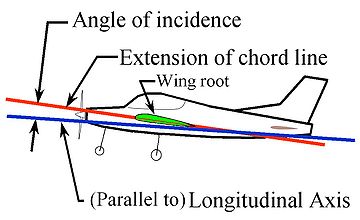

  9. Doug Lord
    Posts: 16,678
    Location: Cocoa, Florida
    Doug Lord Flight Ready
    That isn't correct: the angle of attack of a rudder hydrofoil set at zero degrees angle of incidence will change if the bow is momentarily depressed by a gust causing the rudder foil to develop less lift or create downforce. That's how a trailing rudder foil works and why it can help maintain pitch stability on boats with surface piercing foils that have no active control over the mainfoil angle of incidence and whose altitude varies with speed.
    NOTE:
    --"Angle of Attack"(right illustration below) is the angle of the foil relative to the oncoming flow.
    --"Angle of Incidence" (left illustration below) is the angle of the foil relative to the boat it is on relative to something like the flight waterline and/ or the static water line.

  11. OzFred
    Joined: Nov 2015
    Posts: 509
    Location: Earth
    OzFred Senior Member
    Your statement is inconsistent with your definition. Starting from equilibrium, if the bow of the boat is depressed 1° then the entire boat travels in a vector depressed 1° from previous and the angle of incidence and angle of attack of the foils remains exactly the same. Nothing changed their angle with the boat, and since it's the boat's velocity that creates the flow, it also sets the the angle of attack, they must remain in a constant relationship.
    If the speed remains the same and the angle of incidence remains the same, the angle of attack can't change, regardless of where the boat points (i.e. the actual velocity vector).
    Without some adjustment, the foils have not changed relative to the hull nor to the oncoming flow.
    Think of the sail planes on a submarine with neutral buoyancy. Starting from a vector say parallel to some equipotential surface, if they are used to pitch the nose up say 5° then returned to the original angle of incidence, the submarine just continues in a new straight vector in the new nose–up attitude (relative to the previous vector).
    There is no magic from the stern planes to push the nose back down parallel to the previous vector or return to the previous depth. There may be a tiny amount of resistance from the stern planes while the submarine is turning, but that just resists the turn, it doesn't return the boat to its original vector.
