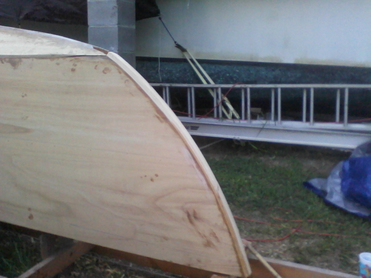

    ply is 5mm (1/4") bs 1088 okume. We are paying some $90 USD a sheet locally
    oldsailor, sorry the pics dont have enough close up detail, im still shooting with my crappy cell phone. They have all been stapled, heavily! we are using narrow crown (only gun we had) 3/4" stainless steel staples shot from a air powered staple gun. Many practice shots had to be done to stop them from blowing straight through! They are sitting at a good depth and will be left in as you did.
    the transom is giving me a helluva time getting everything beveled correctly, doesnt help Im hand planing with a jack plane and the epoxy is slowly dulling it :eek:
    The problem with the heat is that the epoxy has about 5 minutes in the cup before it goes off! I put the second and top sheets on solo and when doing the second sheet (long full 8fter of topside) I almost didnt make it. I cannot mix anymore than 4 pumps at a time in these temps, damn exothermic qualities and it goes off FAST FAST! It takes 2 people in these temps with our hardner, which we will be switching. We are using West System 206 but I think we will bump to 209 because the heat is just ridiculous right now. Hope to get 2 panels on tomorrow, we shall see.

    Another useful tip is to mix in a shallow tray so that epoxy reaction is slowed...
    ...apparently the deeper the mix in the container, the faster the reaction sets up...
    ...and a further trick is to sit the shallow tray in a larger shallow tray which is a water bath, and if you want to go completely ridiculous, add ice to the water bath....
    ...apparently all these tips slow the exothermic reaction a bit, making the pot life a bit longer.....
    ...but the number one tip is to do as you've said - change the hardener for a slower reacting one.

    Got some more knocked out... doing a tad bit of fairing inbetween gluing panels.

    2 bottom panels glued on and another side panel done.... plus some touchup here and there and final shaping of chines to transom. Also glued on some fir to make the stem cap. Might get around to shaping this tomorrow.

    We got almost the whole thing covered, finished up today. Ran out of silica so last panel didnt get put on. Im off to Mexico for a couple of weeks the build is on hold for a bit. Ready to bust my tail when I get back so we can move her to a yard to have room to do all the painting and assembly. Still looking at rig options, but... spectra/dyneema standing rigging is in this Buc's future :) Thanks Silver Raven for the comments!!!
