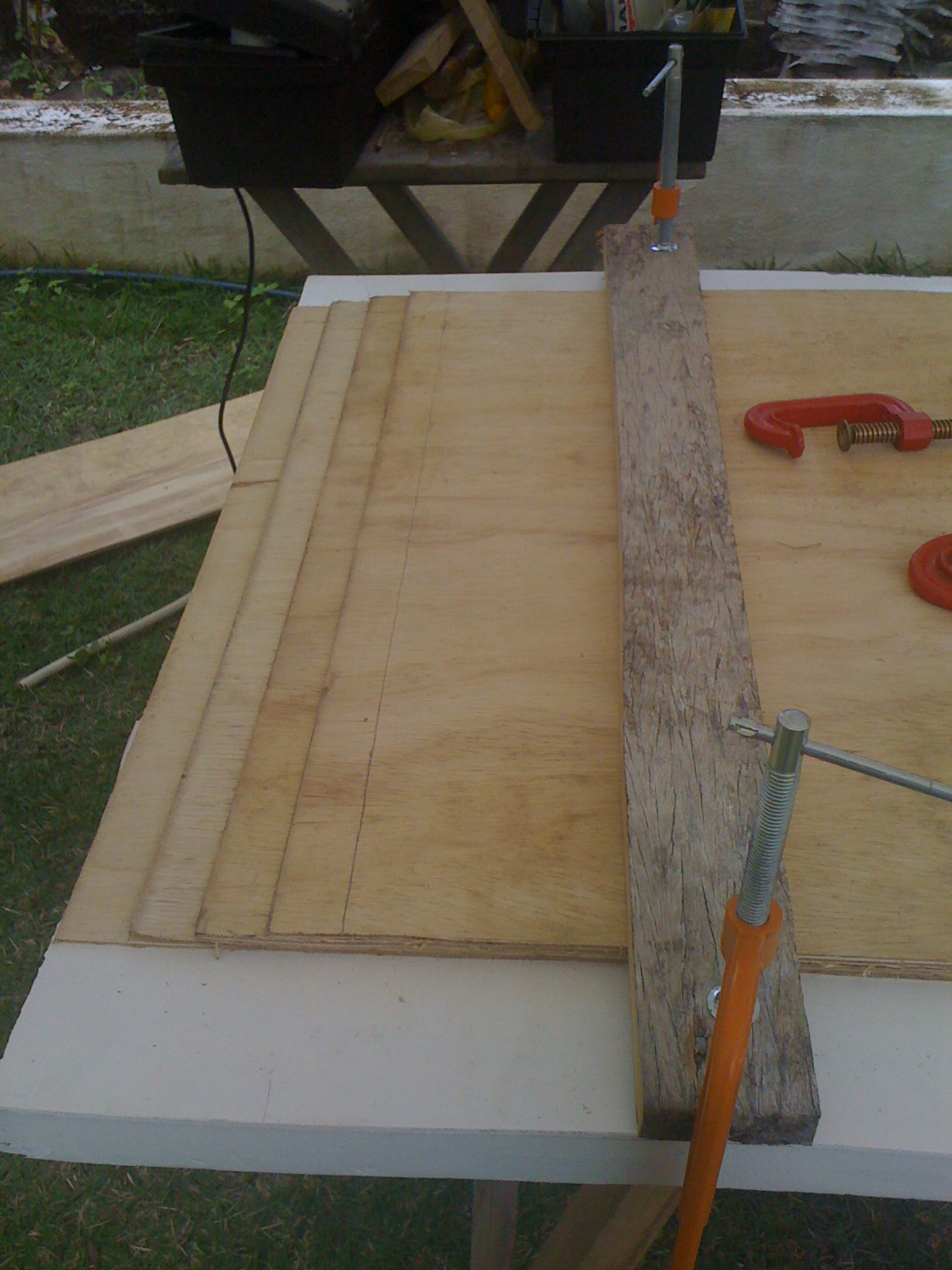

    hey, wait. Here some photos. Before start I had to build a tent. That is our beach house. It is 120 Km far from our city house. So only some weekends to work on construction. Scarfing is not easy. You can destroy expensive marine plywood if you drink some cans of beer:D. Some more photos coming soon.

    Lookin' good Igenova.
    Scarfing is the way to go providing it is done properly.
    If anyone is in doubt of their expertise, butt joints backed by pieces of skin ply 4"(100mm) wide are perfectly good if done with epoxy.
    However scarfed joints ARE neater and lighter. :cool:

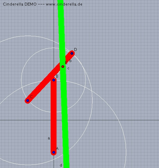

    It's not horribly difficult to design a 4-bar mechanism using the graphical method.
    Once that's done, Cinderella is a fun way to simulate the mechanism. Granted, not nearly as satisfying as the empirical method, but it does avoid a lot of holes. ;-)
    http://www.cinderella.de
    The green bar is the center line of a proposed beam; the beam would actually encompass points D and B as well.
    I used both for a (so far on paper) design of my own and it worked well.
    Mike
    Slide cribbed from an online mechanism design presentation by Ken Youssefi, Lecturer at UC Berkeley, mechanism by me:

  15. bruceb
    Joined: Nov 2008
    Posts: 1,280
    Likes: 59, Points: 48, Legacy Rep: 214
    Location: atlanta,ga
    bruceb Senior Member
    beam design and patterns
