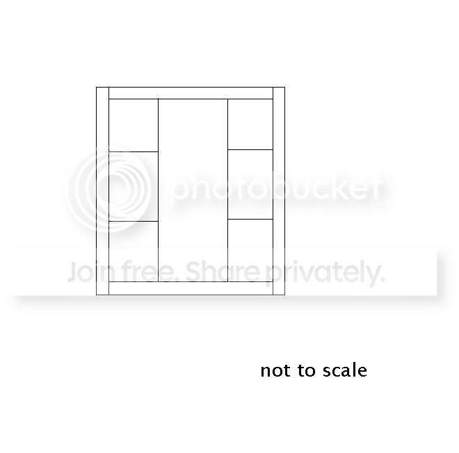

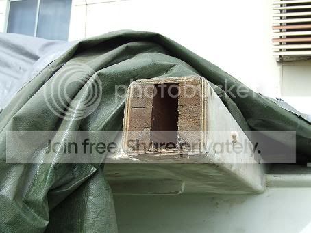

    Hi everyone. Ive had my Buc 24 since 2005 but she has only been on the water for about 18 months of that time. For the last 3 years 'Fruit Bat' has been stored out of the weather on my in laws cane farm. Im finally now in a position to put her back together. Before i took her to the farm, she was stripped of all fittings and i had begun to sand her for a repaint. I also modified the front 'berth' by adding an anchor well and some flooring to make it more comfortable. I was having to lug the anchor from the stern locker forward whenever i wanted to use it. Pretty annoying when your trying to enter lake macquarie from the sea with a run out tide and as your going under the bridge(which has to be lifted) your motor dies!
    Anyway back on topic. My biggest problem is that Fruit Bat has fixed, timber hollow box beams and i had to cut them at both the main hull and also the amas to enable her to be transported the 2000km's to her new home. I have some half brained ideas about how to go about joining her back together but no experience to give me any confidence to do so. The biggest issue is that from the cuts i had to make there is 150mm of hollow box section before there is plywood stops(i'll post some pics i took on the weekend hopefully). i had thought of using either a hardwood or alloy box section as a sleeve in the hollow and then glassing the join and through bolting in several places. Im just concerned that a 150mm join wont be sufficient for the loads it will carry. Im really looking for ideas to join it all again,
    Thanks in advance,

    I wouldnt be too stressed about the repair, it only needs to be as strong as the beam was, and if you scarfed in a piece of timber 150mm would be enough as long as it wasnt more than 15mm thick, which surely it isnt? you can also put a "butt block" inside (on each edge) to reinforce the join if your worried, then a bit of glass and itl be as good as new.
    can you describe the construction of the box in more detail?

    Thanks Samnz. The box is 125mm across, 123ish in height. The outer skin of the box section is 10-12mm plywood. On the sides in the 'box' are 3 timbers squares each side which is all compressed together. This leaves a hollow section in the middle which is 40mm wide, 100mm high.

    A picture or a dimensioned drawing would be a big help to visualise the box beam structure.
    The crossbeams on a multihull are too serious a structure to be altered BG & BG ---or by TLAR.
    The upper and lower members (booms),take all the tension and compressive loads, and the sides (webs) take shear and torsion loads.
    The sides in this case can simply be joined by butt plates of the same thickness and material. The upper and lower booms must be doubled with similar pieces at least 10 times as long as their thickness --- as Samnz has pointed out.
    The ends of these pieces should also be chamfered to a taper to prevent a stress concentration at their ends.
    All joins must be made with marine epoxy and all bare surfaces must be covered with at least two coats of epoxy to prevent water absorbtion.
    Hope this helps. OS7.

    Thanks OS7. Once i get to 5 messages i'll PM you and send you the pictures i took. You probably know the boat. Its name is Fruit Bat and i bought her from Pittwater when i was working at Hood sails.

    Hi, the problem of joining the beam sections into a whole unit again is not an easy one to solve......
    Crowthers original beam and water stay method is a light and relatively inexpensive structure, which he very efficiently tied into the main hull. The main loads on his beams are compression loads as the water stays effectively hold the beam in column and take care of bending. The box beam structure used in Fruit Bat is an entirely different engineering approach and creates different loading paths to the original method. (I'm assuming that water stays are NOT fitted as they weren't mentioned in your post?) Your beams are now heavily loaded in bending, with concentrations at the very point you've cut them. Given that the tri was successfully used prior to her surgery, the structure obviously worked as intended. However your concern regarding rejoining the cut parts is justified! A metal beam structure would have been easier in this respect due to the mechanical properties involved. A built up wood and plywood box beam is much more difficult to design and build due to the wildly varying and non linear structural properties of the woods utilised, and also the adhesives and fasteners.
    The loadings on a trimarans beams and attachments are difficult to calculate, and many broad assumptions are made so that common engineering formulae can be used to design them. Generous safety factors are added to counter any deficiency in these assumptions etc. The beam to main hull loadings are generally considered to be some of the highest due to the geometry of this structure. Given that the box beams were designed and installed as a cohesive structure, cutting them as you were forced to do has effectively rendered them 'under designed.'
    Rejoining them using either internal or external sleeves (or combination of the two) will create localised stressed areas that may fail in due course. A great deal depends on the exact structure of the box section beams and whether there is sufficient structure to accept the additional sleeve loads (eating into their respective safety factors)? Generally an inadequately sleeved connection fails either at the sleeve itself, or just beyond the sleeve when the joint is put under load.
    The alternative method is to scarf new pieces in place per the existing scantlings. However, this still breaches one of the biggest principles in wood structures in that you will have a scarf joint on all four faces directly opposite each other. All scarf joints in beams and mast etc. should never be located opposite each other! You won't find any drawings (of repute) telling you otherwise.
    The beam to float connection is less of an issue as they are dealing with different loads and load paths to the main hull connections. Here adding sleeves or scarfing 'may' work if enough care is taken to fabricate and assemble properly.
    Without a detailed analysis of the beams and there connections, it's extremely difficult to design a correctly engineered solution. A structural engineer, or experienced multihull designer would be needed to design a suitable jointing method, if indeed one does exist. To attempt a 'seat of the pants' jointing method may end up with the trimaran disastrously coming apart when under sail.
    The correct solution is to replace the beams with new ones to the same specification and install them in the original manner. This is the only 'safe' way of rejoining the hull, beams and floats, and will remove the ever present headache of whether the joints will fail! Alternatively could they be rejoined using the alloy tube and water stays as designed by Crowther? This would allow the tri to de disassembled any time in the future without any problem. This may not be a consideration to you at the moment, but if Fruit Bat was ever sold on (AHHHHH!) then this demountability would be an advantage.
    Multihull design is problematic and many structural failures have been documented, even very famous and well funded projects. If the experts can so dramatically make mistakes, what chance the amateur? Whatever solution you work out I urge you to have your idea scrutinised by an industry expert. Multihull structures should be built as engineered and designed, with any alterations being approved by the designer (sadly not possible in this case). The question of insurance may also require that a professional approve your method. The worst scenario being if an inadequate repair were to fail and cause harm to third parties, thus nullifying your insurance.

    Thanks for the info robjgould. The boat does still have waterstays fitted and i should've mentioned that. Part of the reason it has taken me so long to get Fruit Bat on the water is the beams. As soon as i cut the beams and looked inside i knew i has issues because of the plywood stops inside. I had thought of going back to original beams but again, i dont know how to go about the whole process. I'll get some pics up and you guys might be able to give me more info,

    This is a drawing of the beam structure. Around the outside is 12mm plywood with the 2 rows of timber either side on the inside. The hollow that is remaining in the middle is 40mm x 100mm.
