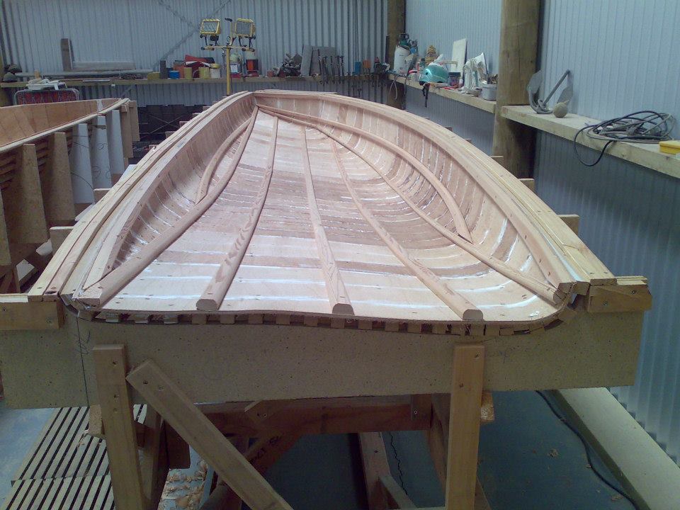

    they are big pics, shot with a digital slr then resized down from 4200? pix across to only 1920? across good for saving and studying later for buc24v comparos
    some site software would resize, it appears boat design's does not
    have plenty more but don't want to clutter your screens

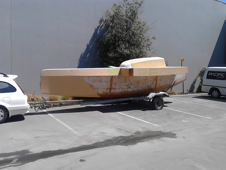

    Hi, I have been sailing my 33 :D and not spending much time on line.
    The local "26" seems to have been extended 18" between the crossbeams and a little extra back at the squared off stern. I have never sailed it, but the rig was kept stock buc 24 so I expect it is slower in light air, but should carry its extra weight very well. The water line seems to support my impressions. The extension was done very well, and looks as if it was designed that way. I think a complete station was added instead of stretching. The cabin is much larger than a stock 24.
    A 28 is a much larger and more complex design, the stretched 24 is still a small and simple boat to build and sail.

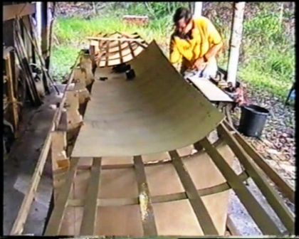

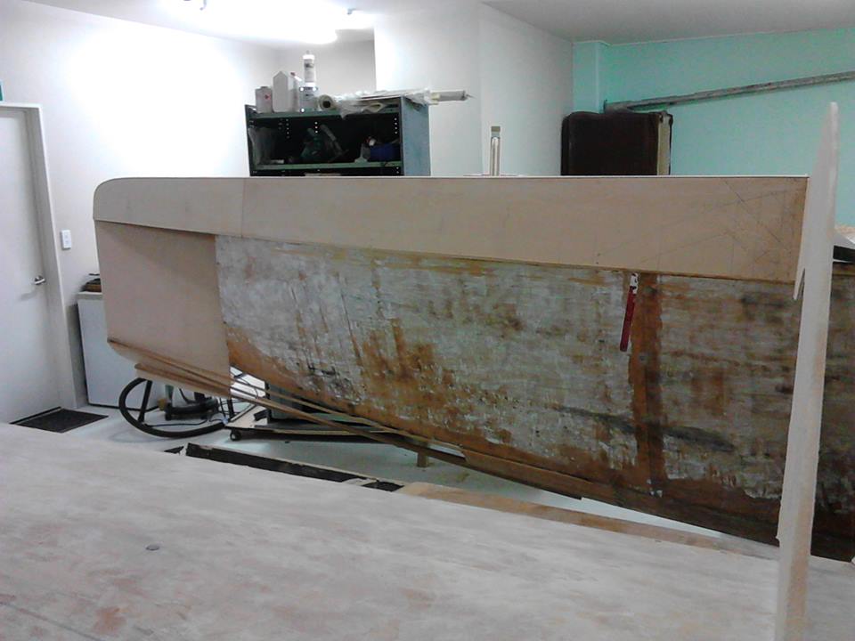

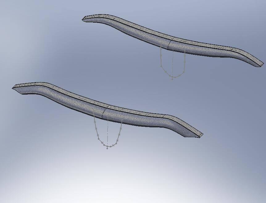

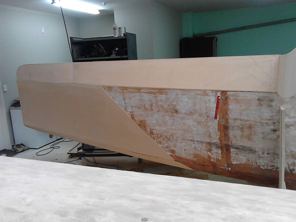

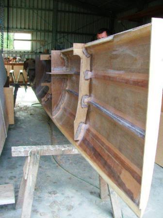

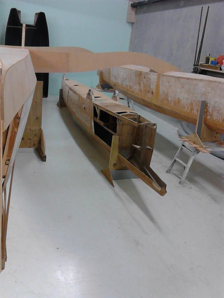

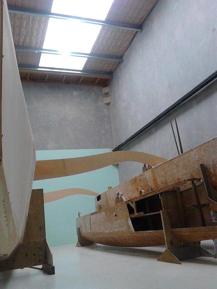

    I managed to find the prototype photo's of the Privateer bow as mentioned fwiw for anyone thinking of adding volume. The trailer photo is turning it around to go back in workshop to have stern section done and the beams is the last photo of the Privateer 8.5 set.
    There is one more photo I can't find presently showing the original bow against the new bow section, I will try and find it and post.
    The Privateer is built in the same way as the Buccaneer 24' however the floats are built in the same way as the Wavelength 780 in the last few photo's and how we do all our prototype work on the Ezifold folding Catamaran in the last photo.
    Jessica and Team Ezifold

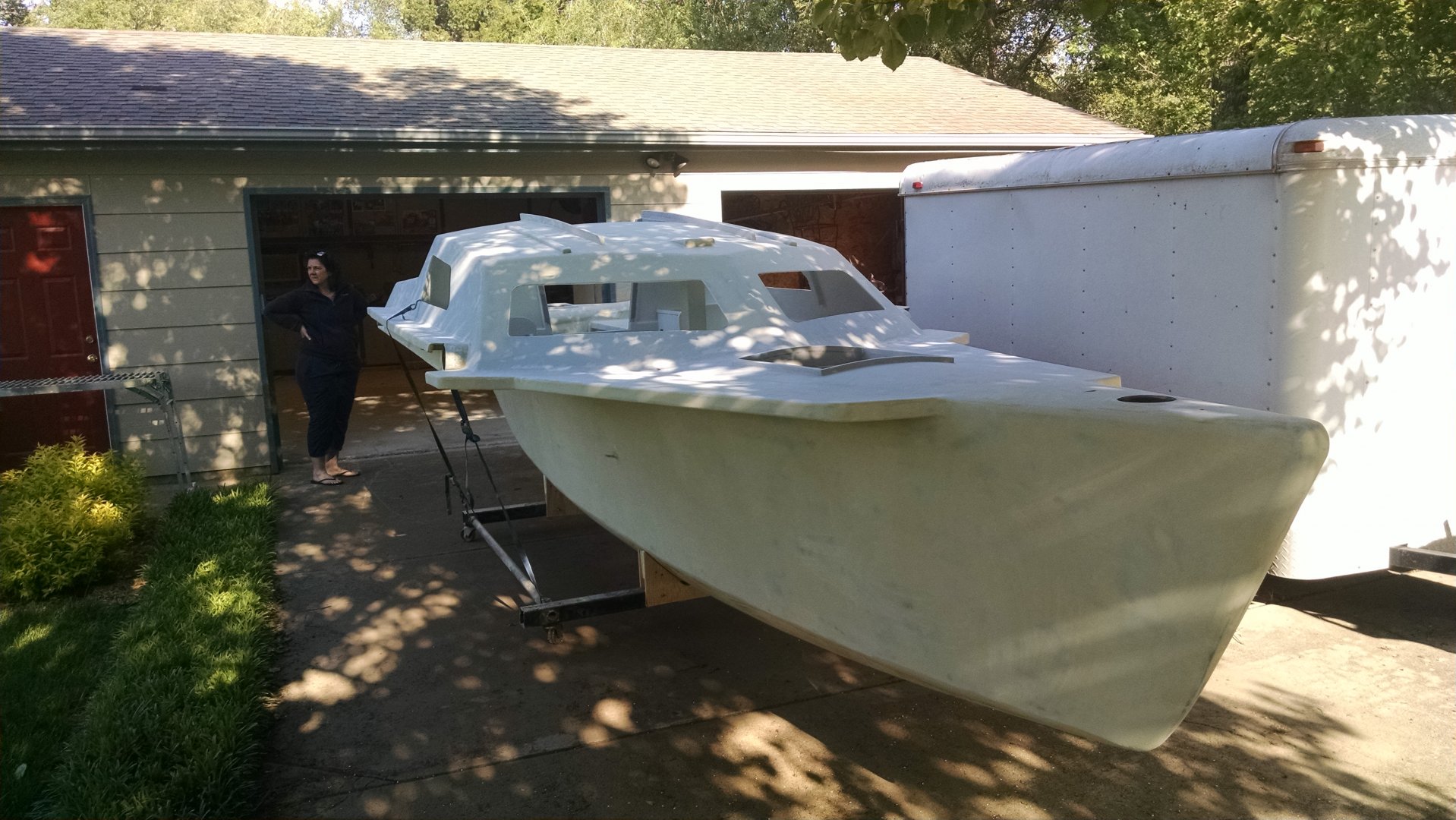

    Got my buc ready to paint. Does anyone have tips for where to paint the waterline stripe? Maybe some measurements? Is the waterline parallel to the waterstay brackets?
    Also, how does one attach a photo in this new forum? I am just dumb enough not to be able to figure it out!

    Thank you. This is a photo of my buc seeing daylight for the first time.

    Those tracks are about the same place I ended up with on my old 24, and also on my current 33. Capricorn still looks great!
