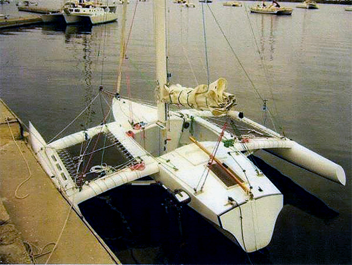

  10. Gary Baigent
    Joined: Jul 2005
    Posts: 3,009
    Location: auckland nz
    Gary Baigent Senior Member
    With three point rigging, headstay and two shrouds, there is, on multihulls anyway, a flexible platform so running stays going from the hounds to either main hull transom or after beam or float transoms, can tension up on the windward side (the leeward is let off) and stops the mast moving about, tightens the forestay for better headsail setup, reduces luff sag, and if you have a wingmast, reduces the movement of that larger mass.
    1st photograph:simple runner type setup on Buccaneer 24 (which had altered to 7/8th rotating rig, not fixed masthead as original). The main shrouds are pulled aft with blocks as shown, sort of in between runners.

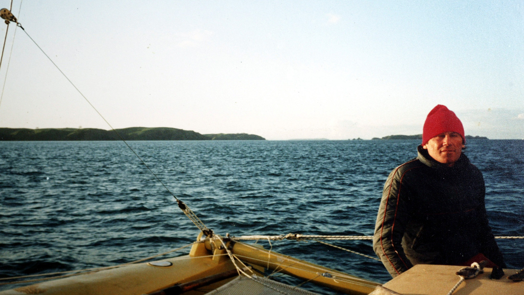

    2nd: runners to transom on wing masted Sid, windward on, leeward off.

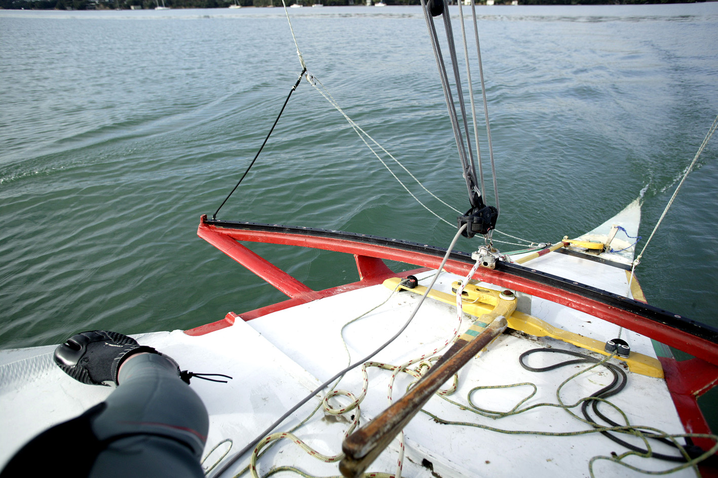

    3rd: 3/4 rigged Patterson 6.5m with runner type stays also going to after beam.

    The leeward running stay, if not released, will do the same disastrous thing. See the correct setup shot of Sid with tight windward, slack leeward runner.
    Don't accidentally gybe from crap helming by running way too square (by the lee) downwind ... but if you do, the formerly windward runner has to be released quick smart. And if you're too slow, broken battens plus the boat will want to round up and kill you.
